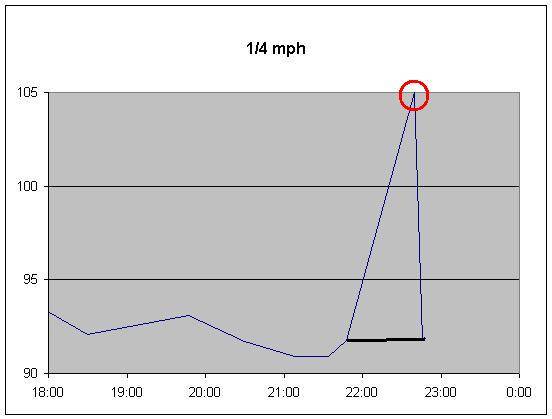

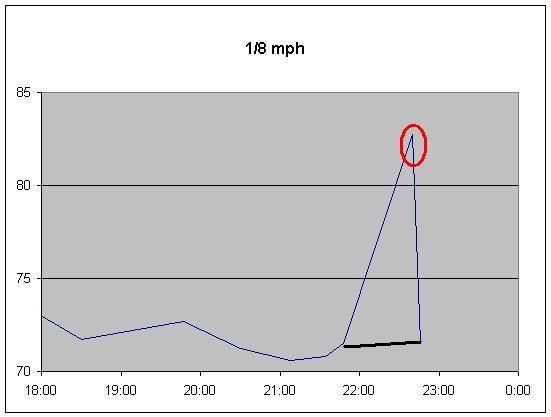

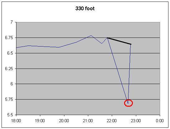

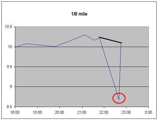

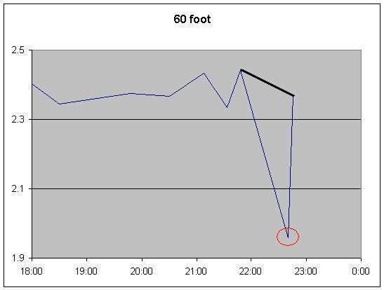

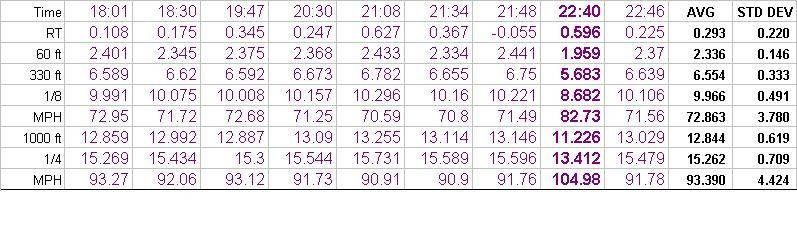

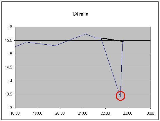

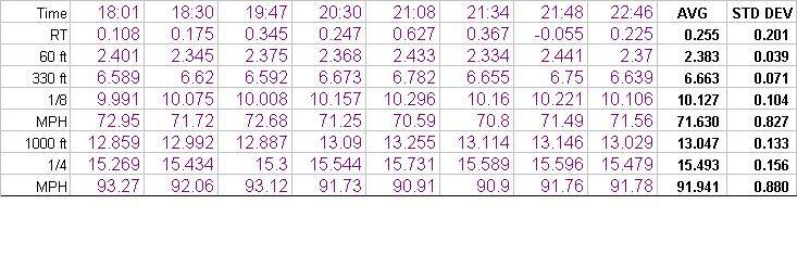

We'll I've looked at the times, and I have good news and bad news.
The bad news... the 13.4 run was a fluke.
The good news... you're not as inconsistent as you thought except for your reaction times which will only get better with practice.
Look at the numbers attached...
With the 13.4 run averaged in, your standard deviation for the most part is too high. Look at the averages and standard deviation WITHOUT the 13.4 run. Much more TYPICAL standard deviations without the 13.4 run.
More to come...
Debi , still did very good even without the 13.4 time, with more track time and more mods to her car, i have every confidence that she will be able to hit that 13.4 time again someday. Debi is really getting into racing her car. :)
mespock said:
There is nothing wrong with going over the times. We all know that that time was amazing and most of us are questioning it's possibilities.... Our experienced racing members have stated their expertise and opinions...
And if this was the movie "Bruce Almighty" I'd probably have a monkey crawling out of my butt right now.;)
I think Deb is a good person also. However, I like to deal in reality.
Take a look at her other runs. Divine intervention or whatever, that car didn't suddenly decide to run 12-15 mph faster.
Nothing personal. Just stating the obvious. People that come to this site deserve good info. That is all it is about. Good info. Unfortunately, this thread is not good info.
Continuing on...
Look at the graphs below and notive the unusually large 'spike' indicating the data from the 13.4 run. I have added a red circle indicating the data from the 13.4 run and a black line to indicate what the graph would appear as without the said run. Pictures speak a 1000 words, and graphs are very good at displaying numbers as pictures.
It becomes quite clear that for whatever reason, the 13.4 run does not fit the expected profile. In statistics, what generally happens is the standard deviation for a population is utilized to select and 'throw out' data that 'does not fit'. Similar to the often heard phrase, "throw out the best and the worst" when analyzing data for any trend.
Now, let's honestly critique the results given. :)
Start with the Reaction Time. It cannot be stressed enough... practice, practice, practice. Your eye/mind/body reaction time can be trained but you have to learn your car's reaction time. Most Mark VIII racers will tell you to launch when you "see" the last yellow. Monitor your reaction time and once it is consistent start to hone it down by recognizing your car's reaction time. Let's sat you are fairly consistent between 0.1 and 0.2 seconds. DO NOT try to leave "quicker" by guessing when you see the last yellow and beating it by 0.1 or 0.2 seconds.
If you are consistently in sync, the last thing you want to do is retrain yourself. Get better reaction times by adjusting your 'position in the box'. If you are doing everything the same you should always be in the same position at the tree. You approach the lights, light up the pre-stage light then slowly advance until the 2nd stage light is lit. You are now "in the box", ready to launch. But if you are 0.1 to 0.2 or more in your reaction time, you can nudge forward and be closer to the finish line but still keep the stage light lit. But remember to be methodical and consistent in doing so. You want to nudge ahead the same every time. Now your reaction times should be lower, proportionate to the distance you have moved in the box. This is called staging deeper. Stage too deep however and you will either "deep stage"(the 2nd stage light goes out - usually not allowed) or you will "redlight" at the launch.
Practice is the key. Too bad in today's crowded tracks, novices have a difficult time getting enough practice time. But rest assured your reaction times CAN and WILL get better.
That is a good critique driller and very good advice, Debi will appreciate the good advice. :cool:
Now let's look at the sixty foot times.
You averaged 2.383 with a standard deviation of 0.039 seconds and a high of 2.441and a low of 2.334.
THAT is consistent, but consistently high. Lots of variables come into play here, the most important is obviously traction but also important is the launch of your car. If you spin, you loose time, simple. So the obvious answer is not to spin. Traction lock differentials are not standard on any Mark VIII and without such you most likely will have the infamous "one-wheel peel" where one tire simply spins. IMHO some type of limited slip differential is a necessity for any successful sixty foot times to be had.
Tires and the track preparation play a huge role as well. If you have street tires, you usually only want to spin the tires in the burnout enough to clean them or dry them if you had to pull through the water box. Drag radials usually "like it hot"(though don't do too long of a burnout). Also you basically want to adjust your tire pressures for better traction and watch your sixty foot times for the best results. Different tracks on different days will require different tire pressures.
If you have done everything you can do and are still spinning, you need to alter your launch technique. Instead of simply mashing the go peddle, you want to deliberately roll into the throttle taking a full 1/2 second or more to have it matted.
Long story short, the first 60 feet of your race determines how good a run it will be. Most people will tell you a tenth in the sixty foot is worth TWO tenths or more in the quarter mile ET.
Your 1/8th mile times.
You averaged 10.127 @ 71.630 with a high of 10.296 @ 70.59 and a low of 9.991 @ 72.95. You varied by ONLY 0.104 seconds and 0.827 MPH(standard deviation)!
Your 1/4 mile times.
You averaged 15.493 @ 91.941 with a high of 15.731 @ 90.9 and a low of 15.269 @ 93.27. You varied by 0.156 seconds and 0.880 MPH(standard deviation).
While obviously you'd like to see quicker times and higher MPH, you can tell your car is very consistent. Once past the 60 foot mark in a Mark VIII, the car takes over as all you have to do is keep the throttle wide open and steer straight. :D
Class dismissed. Your homework assignment is practice your Reaction Times and work on your sixty foot. Be sure to study as there WILL be a pop quiz! ;)
