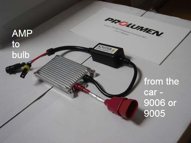

Jfeds3usS - you are going about it thinking it's more complicated than it is.
The HID ballast has a red plug on it.
that plug is the only thing your car's plug will go into. There is no need to use the adapters with spade plugs on the bulb for any 9006 and 9005 applications. <-- red so you can relate the plug from the car to the plug from the ballast. It's direct.

No need. the plug goes into the ballast as shown above.
The H11 kit however requires the spades - those spades are narrow/thin and will slide right into the H11 harness plug from the car.

Dude has anyone with 9006 bulbs installed this kit correctly? I have emaield Matt and I see he has coem on here saying same thing he did to me in am email, buttt if it was as easy as you say than the guy with the problems would have figured it out by now.
I doubt he is a dumbass,, if was as simple as red plug to plug in than this shi** would have been done.
You say its plug n play yet not one here with 9006 has plug n played them yet.
And ur answer is, your not doing it right, or ur makin it harder than it is, etc...
Sport has the H11 bulbs so his help is useless "no offense Sport", its a different setup.
SOOO how bout some pics, or diagrams or something showing the "simple" install on a 9006 bulb?
That way we can see it and you can show hwo easy it is exaclty.
Please note that the customer wasn't sure if he should fit it in correctly. He just didn't press in hard enough. Now that he did that, he's good. It's not hard to do.
