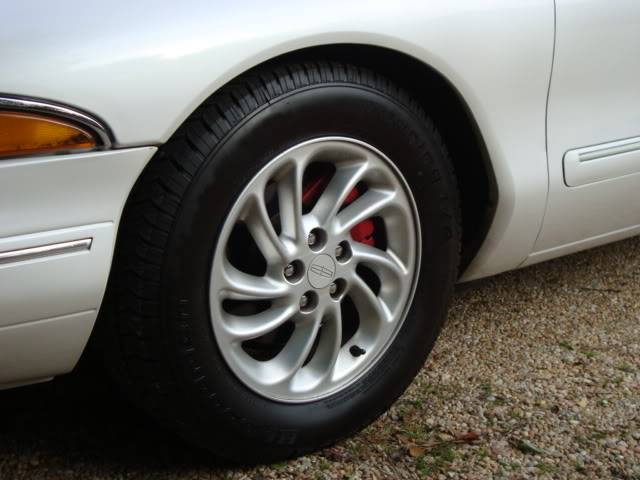

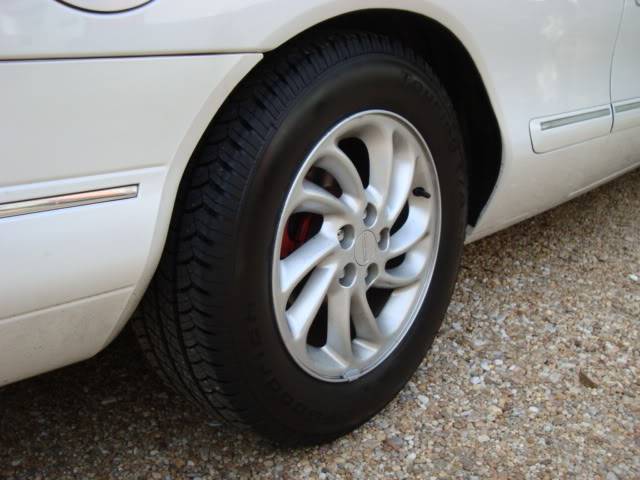

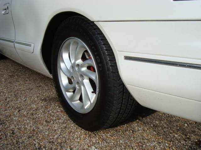

I have put BF Goodrich Touring on both of my Marks. 70,000 mile tire and they ride very good. I had the hammer on weights removed and static weights installed since these pics and that made a huge difference. 31.5 psi in the front and 30.5 psi in the rear.
Glad I bought new corner lenses lol. That one on the 2nd pic was holding some crud inside. I think this was last May.

Some here in the reviews mention noise but I hear no noise from mine. I think it might depend on what type of car they are on such as one that doesn't have much sound deadening installed or w/e and I don't have any traction issues either. The tires pictured above came off the 94, except for one of them and they had around 15K and still don't look worn and dry rot... not one sign of it. The T/A Pro Series is what I have and they were bought at Sams. I think they are the only place where they can be bought and if there is a normal BFG touring, I can't comment on those.

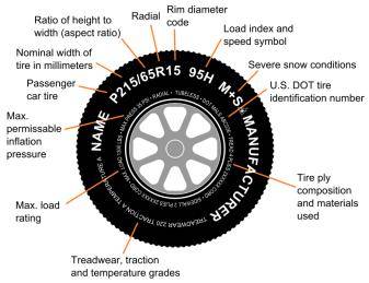

Hell, most people do not even know by reading a tire size what it truly means.
For instance a 255/40/16
255 represents tire width at 255mm's
40 represents that the sidewall height from the rim lip to top of tire tread is 40% of the tread width.
16 of course is the rim diameter
Illustration:
