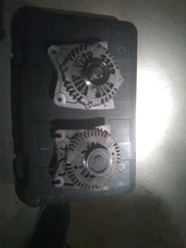

Well long story short, I went to leave and the car was dead ....so he gave me his Alt..looks a bit different...
Keep us posted if a Gen 2 Alt works in a Gen 1. I have wondered this too.
Yes a Gen2 has the same Alt, I was borrowing Lasers while I had the old one in the pic rebuilt...his motor was on a stand, so he didn't need it at the time anyway...gotta love having friends...especially awesome friends with interchangable car parts :-)
I was buying a 97 lsc for 3000 i was working for the guy he was driving it while I was paying it off I didnt like the 94 when I got it but it grew on me and I would not trade it for a gen 2 in better shape I seen on here some were head lights being redone is that hard to do?
a gen 2 alt is not the same as a gen one alt, but a gen 2 alt will work on a gen 1, you cant put a gen 1 alt on a gen 2, the stud is in a different position for the power wire on a gen 1 alt and if you put it on a gen 2, that stud will hit the intake manifold and arc out. gen 1 and gen 2 alts also have a different location for the main plug, you have to pull the harness towards the pass side to get it to plug into the gen 2 alt if you put it on a gen 1!!! damm all this gen 1 gen 2 crap!
