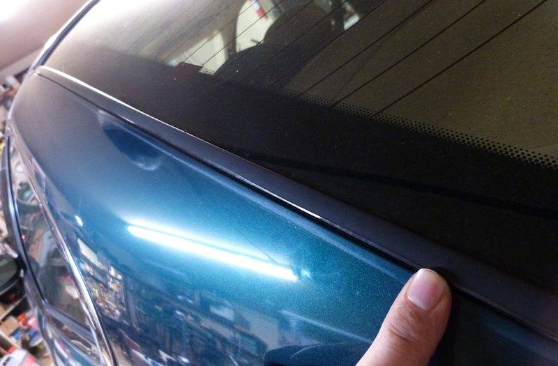

I took a different tact. After looking at everything I could find on this, I didn't want to add another molding clipping over the OEM and more importantly, I will need to get my car painted. The OEM gasket proves a problem there since you cant capture the entire panel surface with the gasket in place. So, I just used a tight razor knife and cut the lasagna off. I'v yet to do the top where there is only a couple lifts. I will eventually bend a piece of aluminum flashing into the groove and hand sand the razored edge to a rounded one. The widest part of the gap is about 1/8th and most is not even that. You can see where the original paint was under the cut away portion as this car was once painted up to the flap of gasket. Painting "should be" panel edge to edge. The gasket flap has to go......

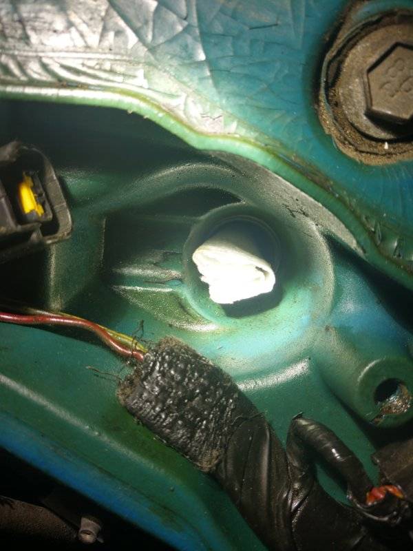

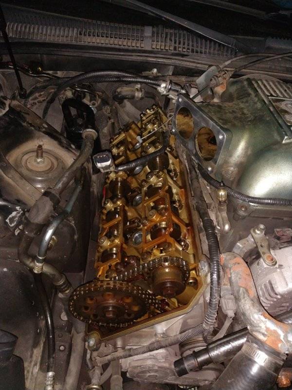

Soaking up Oil from the Leaky Valve Cover Donuts..next time those Donuts are getting BATHED in Right Stuff

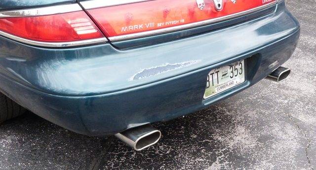

Finished up the Dual Exhaust install with my final update in the How To Articles section. Finaly....I'm done, for now anyway! :)

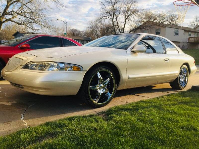

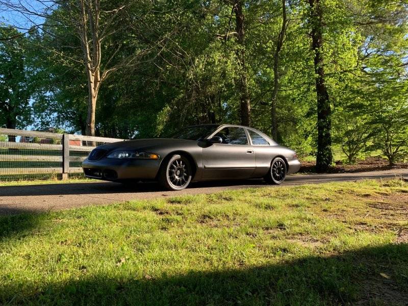

Swedie, she is beautiful, she doesn't look like a piece of crap or an ugly ducking!! I've got a few silver trim pieces for that front corner light - yours free just get s&h. Of course the plastic piece that adheres it is broke - but I've been able to make it work on my other two marks, I'm sure you could easily find a way to adhere it also.
Thank you!
I'm sure I have that trim piece, somewhere. But I'll get in touch with you if I don't find it! It fell off somewhat like 7 years ago...

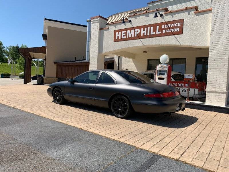

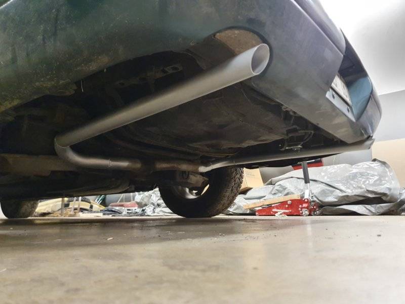

This was about a month ago but I straight piped it (still have cats for emissions).
Also I did buy these for my BMW and was thinking of putting them on the Lincoln for a "Swedish" look on the Lincoln.
But I decided to send them back. A shame, would've been cool tho.

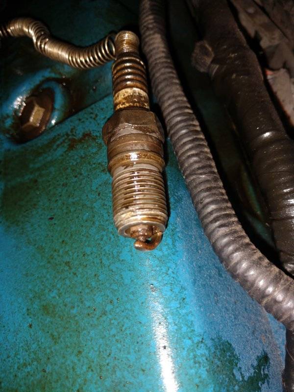

Hot wired my starter but still no start, I am dealing with multiple issues I guess. Changing the spark plugs tomorrow there is oil in them
