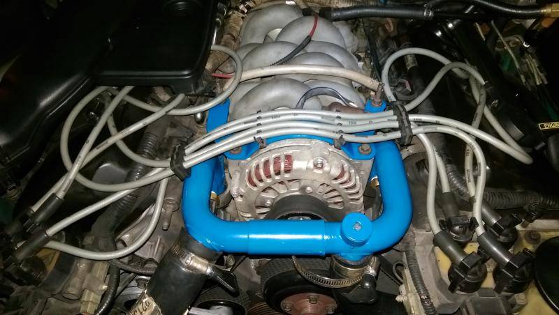

New Wix air filter, replaced the coolant temp sensor, painted the alternator bracket and installed the crossover tube I painted.
Overheat saga continues. So the fan doesn't turn on sometimes and I am thinking it is the temp sensor. Replaced the sensor and now it's time to wait and see.
