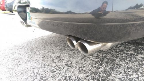

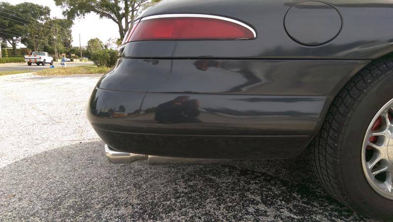

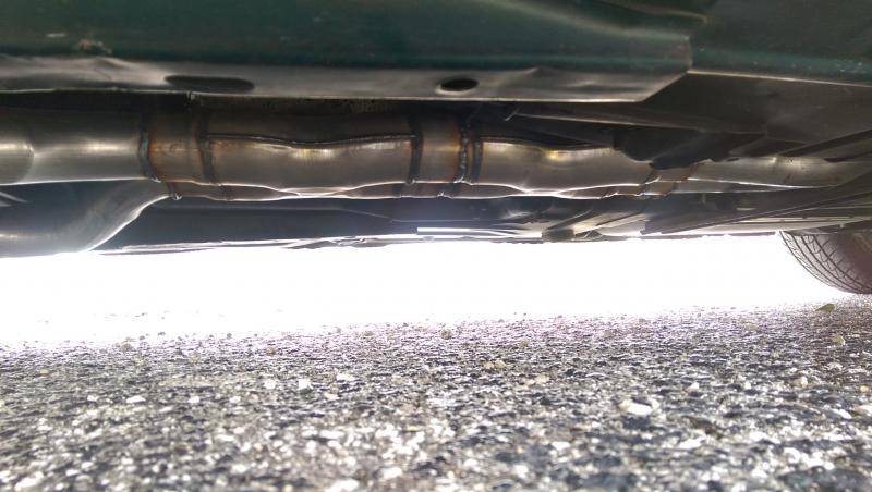

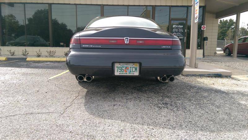

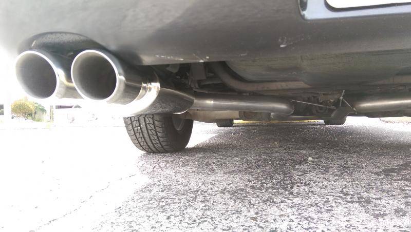

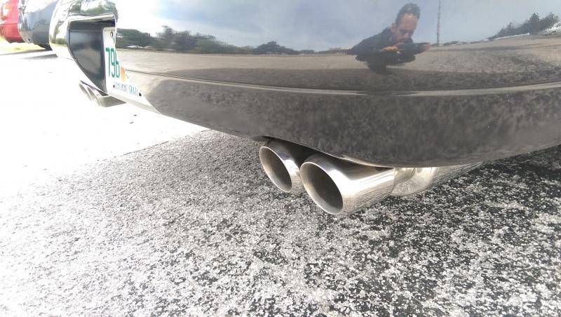

Last week I'd been in contact with Geno from Lincoln Motorsports and ended up purchasing an exhaust kit from him.
Thursday, I had my exhaust done at a shop near my job. 2.5" cat back with true mid double X pipe and some insanely sexy looking stainless double tipped mufflers out back. She sounds like a WHOLE different car. I'm in absolute love with the sound. It feels like driving a whole new car.
Curiously what did that kit cost?
It was $299 plus shipping.
