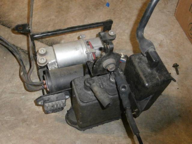

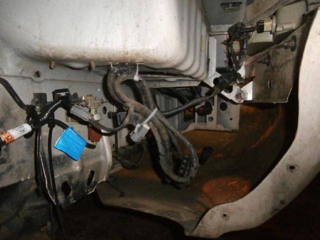

All I remember doing is removing the fenderliner, Air res and maybe the intake box to better access a bolt. It's been so long...
Changed both O2 sensors and replaced all my rear bulbs with new bulbs plus put an LED bulb in the tag light. So much brighter :)
after I removed the air intake box and the snorkel, it came out easy...only had to remove the fender liner, Thx SBCap
(3) 13mm bolts, relay supply, motor line, supply and vent hoses...done

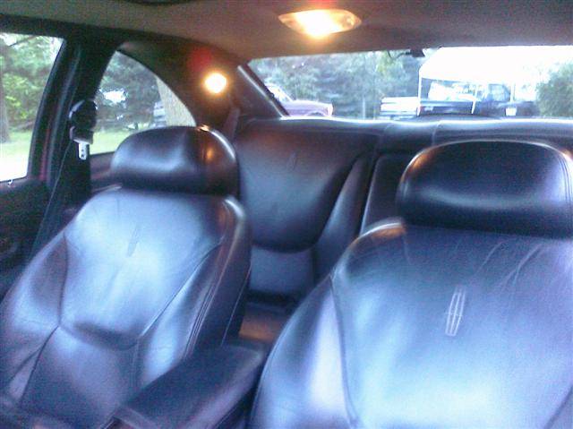

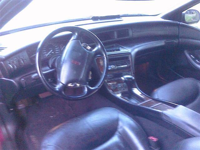

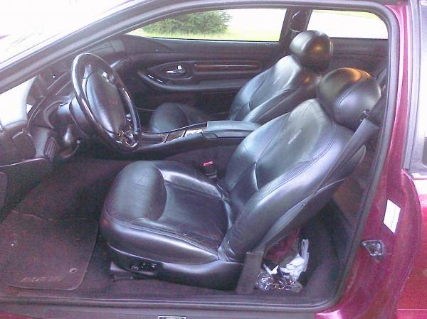

I took the seat skins and foam off Gen II seats and installed them on my Gen I frames. just take your time and gently roll the leather up. just be careful of the hog rings and the super velcro.
Here are some crappy cell phone pictures of my gen II seats in a dirty Gen I.

I now have LSC floor mats and a CE wheel with a 98 airbag.
That's pretty awesome. Did the seat control switches have the same connectors? Or did you have to do any rewiring for that? I'm planning to do this with my '95.
I don't think he touched the seat controls, those are gen 1 seat controls, just swapped the 2nd gen leather and seat foam, which is a good idea..never thought of doing that.
