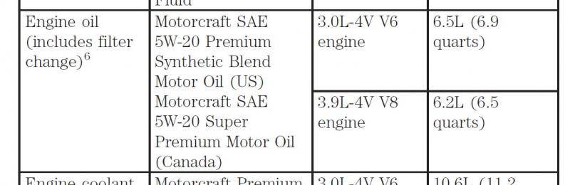

From the 06 service manual:
http://deneau.info/ls/s6x~us~en~file=s6x31001.htm~gen~ref.htm
Note that while they disagree, neither says 6 quarts. The owner's manual says 6.5 quarts, and the service manual says 6.9 quarts. My own experience is that 6.9 is right, because 7 quarts brings both of mine to the max fill line.

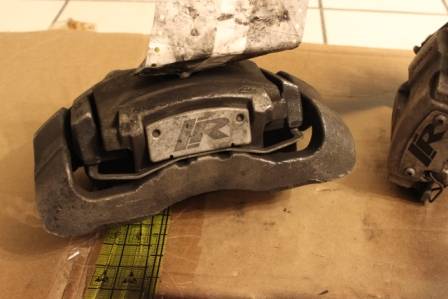

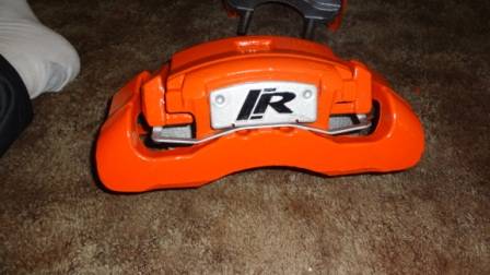

Calipers
I finally finished painting my brake calipers. It took a long time just to clean and prep them for paint.
Wow! Nicely done. Someone said there is no aftermarket support for the LS? With work like this we don't need it. We have US! Not just this one here. There are many others on this forum that put in so much time and effort for the love of their car and then share it with the rest of us. Thank you very much!
