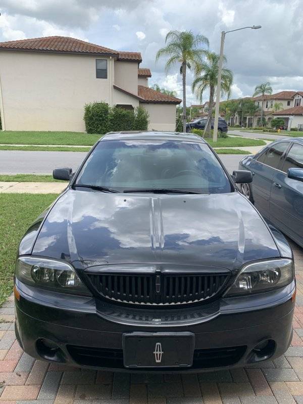

Trying to get it show worthy again.

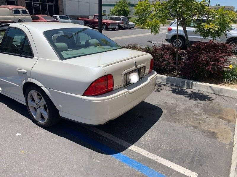

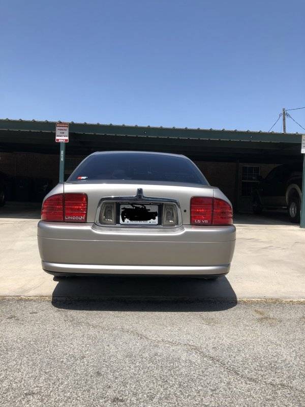

Installed some Gen 2 LSE tails! I really like the way these look. Almost done with my Gen 2 LSE conversion. All I need now is the rear valance and/or color match my existing one.
And....just got the spoiler painted and installed. Nearly have a full LSE conversion. Just need the rear valance color matched. I haven't 100% confirmed if the Gen 2 LSE rear bumper valence is just a color matched version of the stock black one.

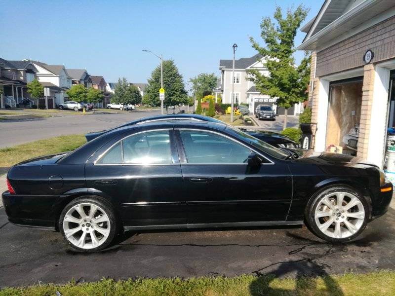

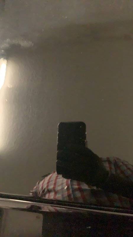

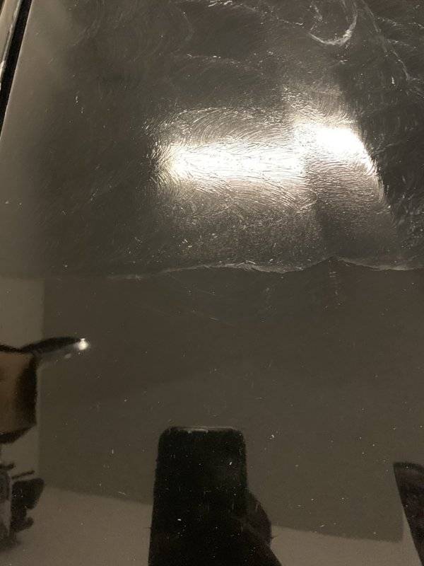

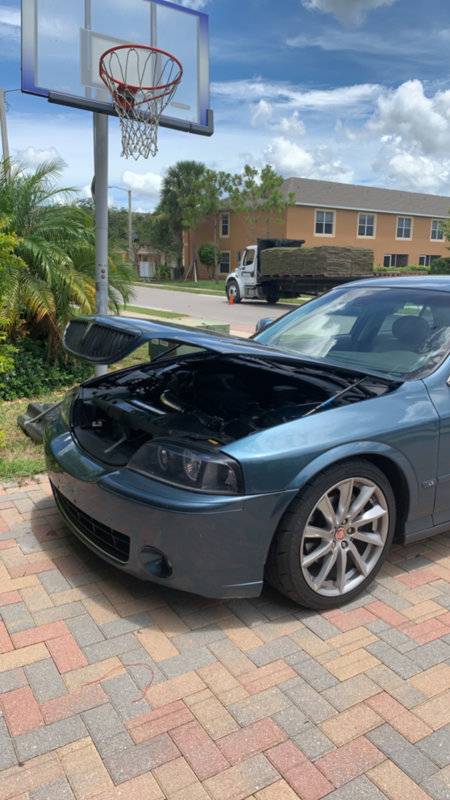

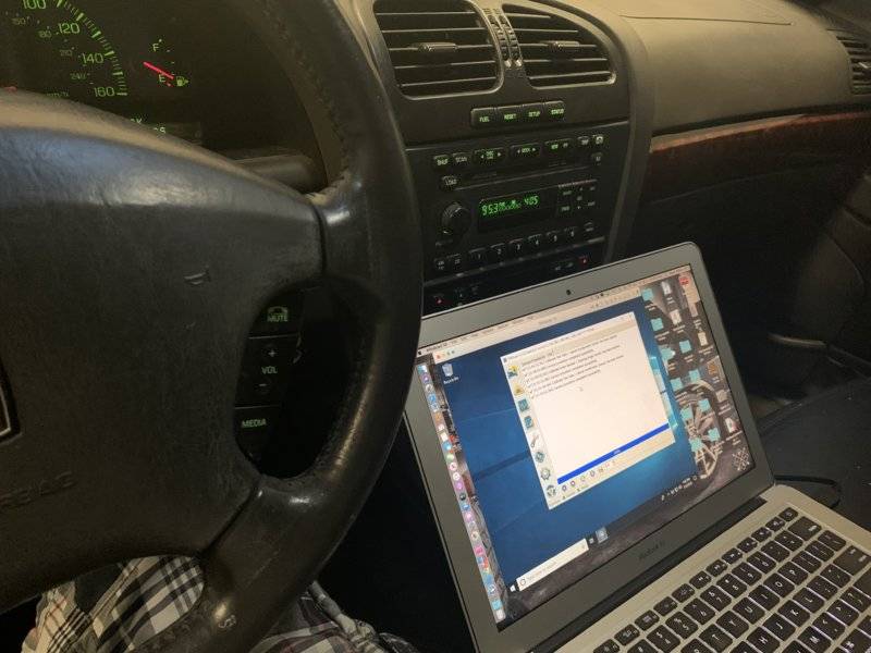

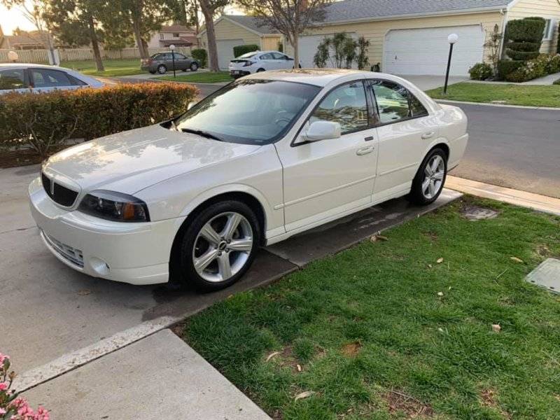

Working on paint.. wash, compound, polish, wax. Tedious!! Finished full LED light conversion interior and exterior. Running some Forscan tests... changed factories 17” for jaguar Tritons. Put in clear turn headlamps.

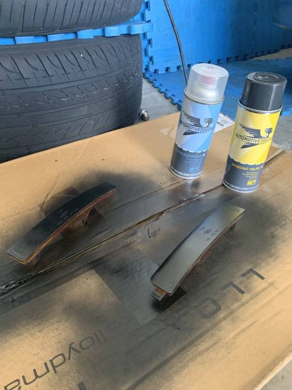

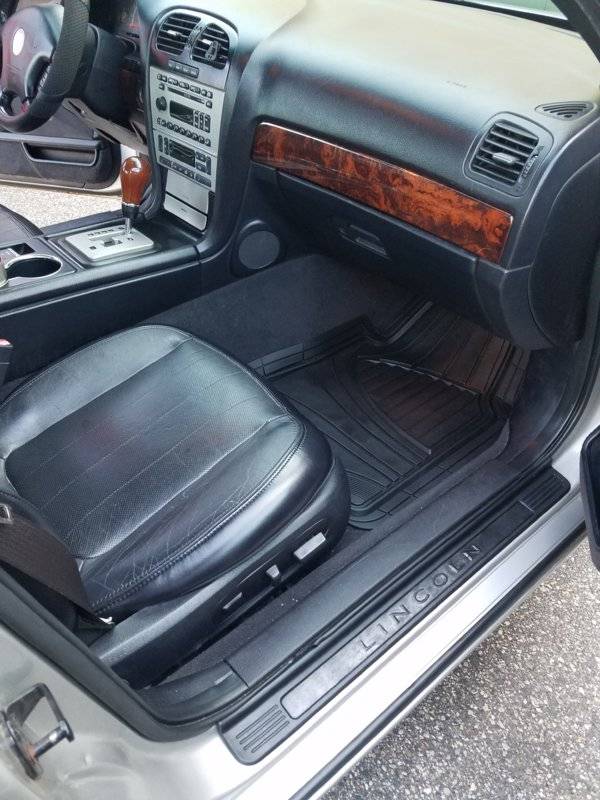

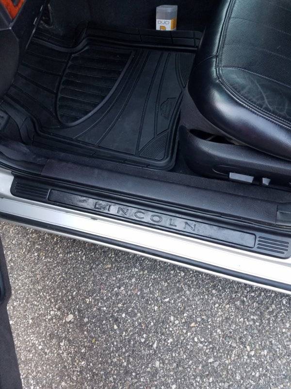

Meh....Better than the bubbled out lettering that was on there before I blacked it out ...also I'm starting to black out the silver ...going semi-gloss black ...kinda like the sheen look

This is something I need to do also. Kills me to open my doors and look at that awful deterioration that has happened to the lettering. How easy is it to remove and reinstall them? Do I need to purchase new clips when I do it?

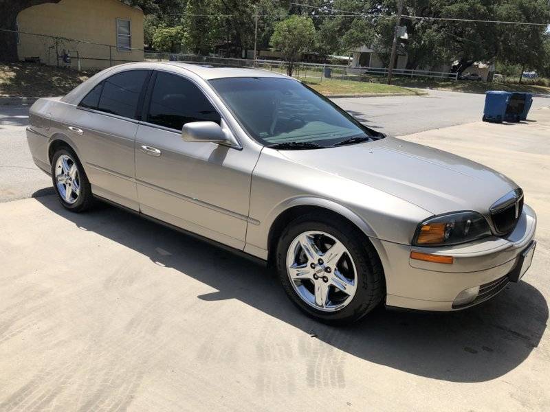

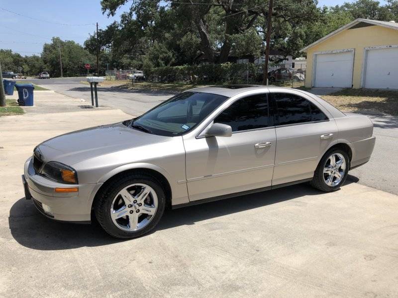

Today I used a polishing compound on the headlights and they almost look new. I’ve had this car for three months. It is a 2002 LS V8. Took half the morning to wash and wax. It looks nice I think..

You can pry the plastic up with a plastic pry bar so not to scrape the paint ...it pops right out...then pry the thin metal tabs up in the back and pop off the Lincoln letter plate ... wash the black plastic and allow to dry ...paint the metal lettering to your liking ...easy... peezy

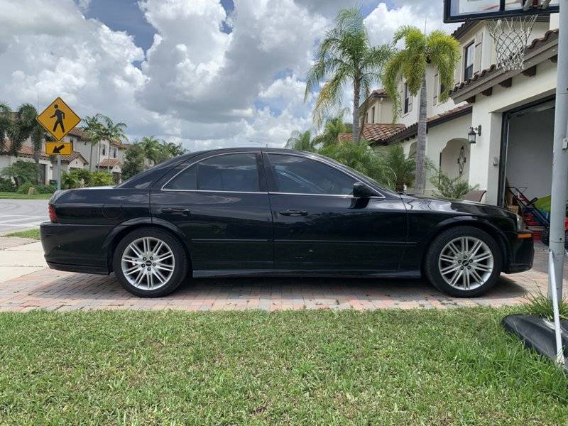

Here, I just tried these. The rears are too wide 285 30 20. The rear rims are ten but I think the fronts at nine would fit nicely all around.

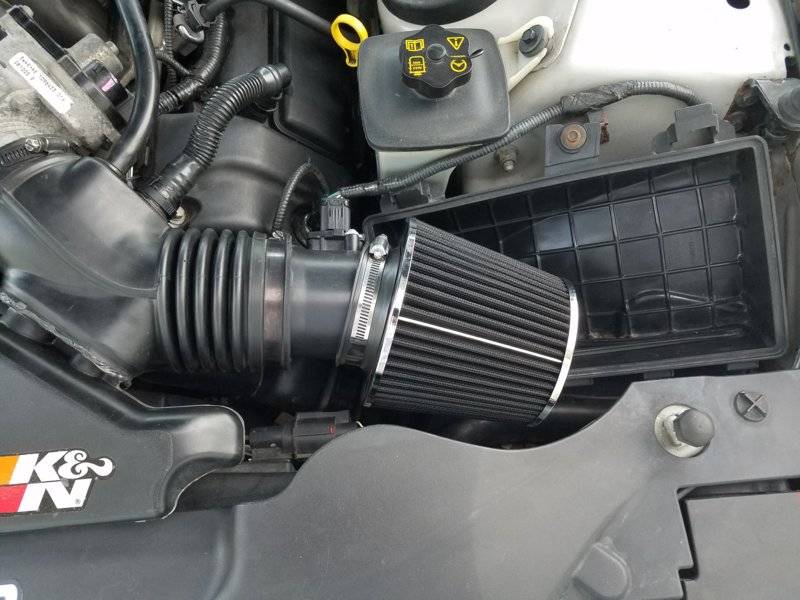

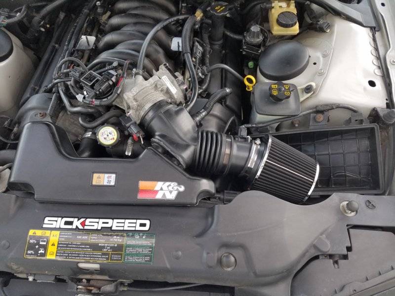

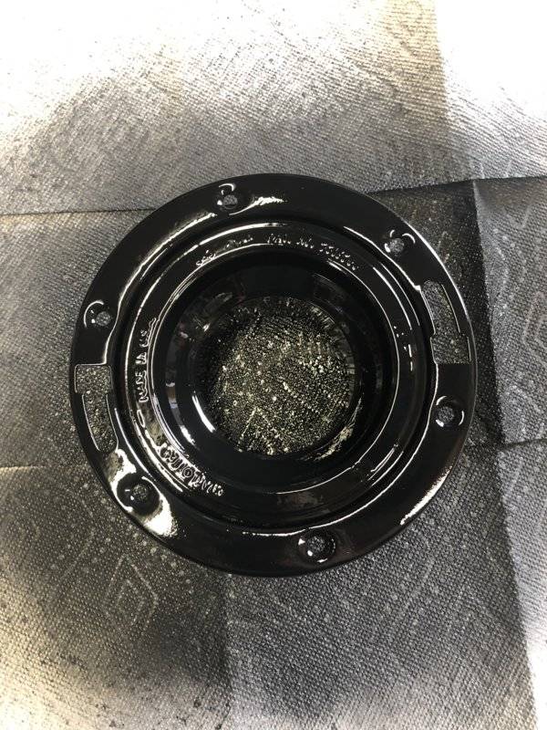

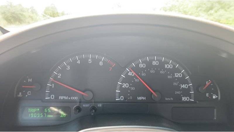

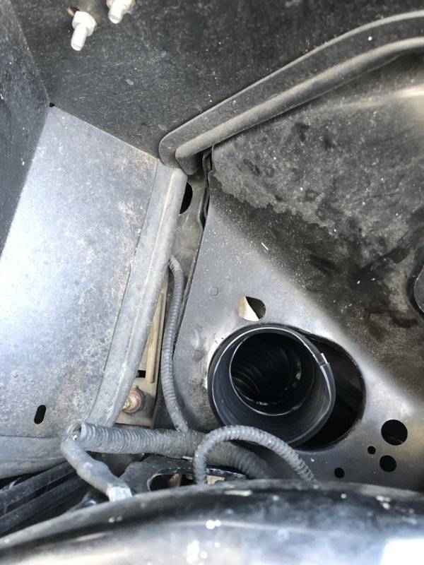

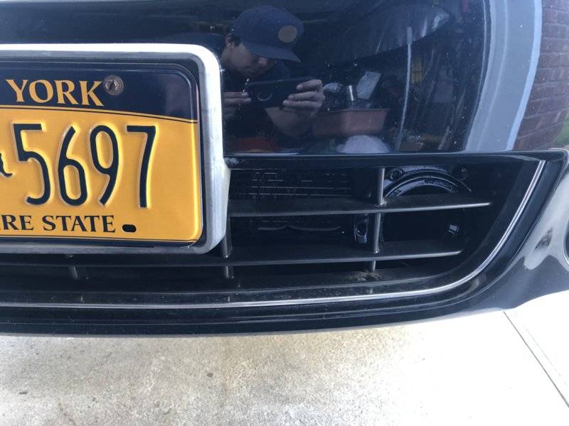

I was running high engine temp numbers after bleeding and bleeding and bleeding and bleeding the cooling system I decided to try something different...... seemed to lower the engine temps on the highway by atleast 10 degrees went from running at 217 to 210 and below easy
Pretty much a homemade velocity stack and some flex pipe. the goal Was to lower operating temperatures so far it seems to be working great mainly on highways around town there’s rly no difference.
Hmm I’ve never seen that before. Is there a restriction on airflow? Cooling issue?
Google homemade velocity stacks and you'll get an idea of what he is trying to do with the air...this has been done before by other members on the forum ...
