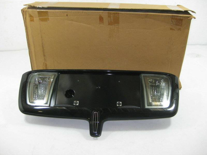

Found a complete LSE NOS rear grille for the car, only it was black, so a repaint was in order. Took the front grille apart and freshened it up as well

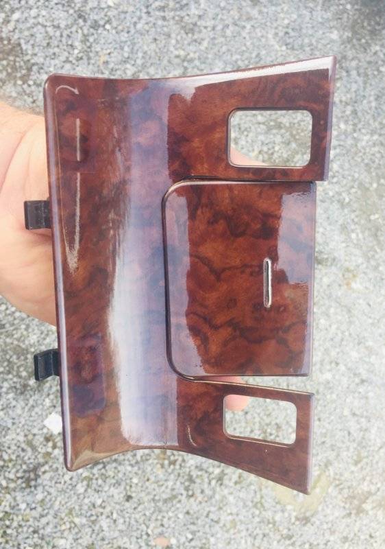

Some small details that make huge differences. After the shiny new walnut shift knob the ashtray and heated seat control walnut trim items were showing dullness ageing / scratches and not as vibrant. Took them off, wet sanded with 600, shot 5 heavy coats of clear, let dry two days, wet sanded with soapy warm water using 1000 then 2000 grit, and then a good hand polish with compound. Perfect match now. Wish I had taken some before pics.

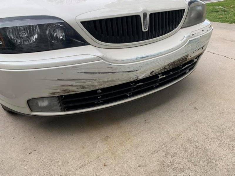

Oldest son messed up front bumper. Fortunately, I had a silver '03 LSE front bumper in the garage rafters. Got it painted and the guy did a fantastic job of matching the tri-coat color. Also, went from 17" 8 spoke wheels with 235/50/17 to 18" 5 spoke with 245/45/18. Looking very sporty, I must say!!!

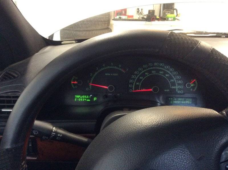

After 201,000 miles had to replace belt tensioner today...Replaced with OEM Ford part...Rock Auto....not bad at all

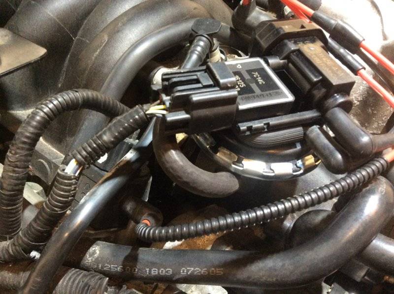

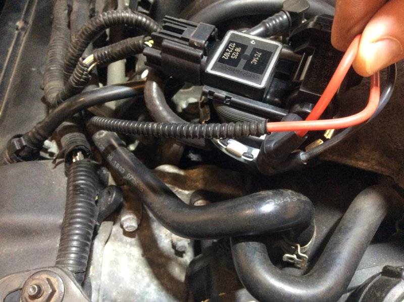

Replaced the EGR Valve ...This was a breeze ...also put my Electronic Parking Brake lever back in place with new screws ...No Check Engine Light ?...for now :)

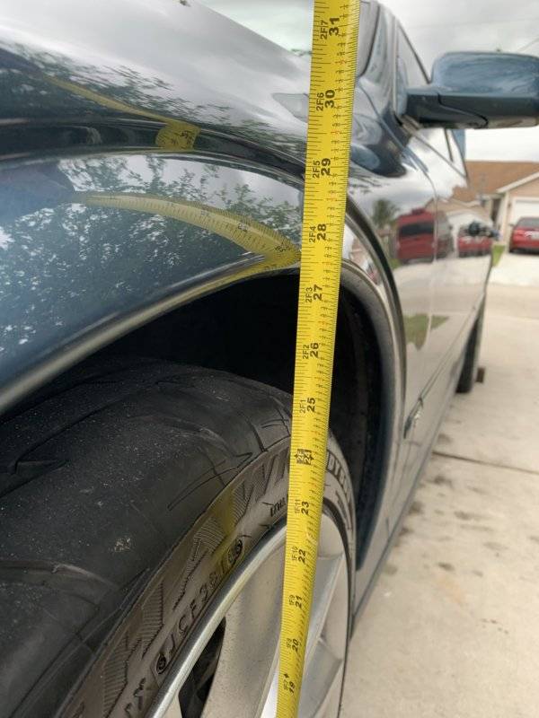

Finally lowered on Eibach’s. Amazingly I was at 27” before upfront before springs and went down to 25”!!

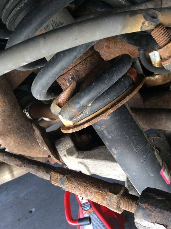

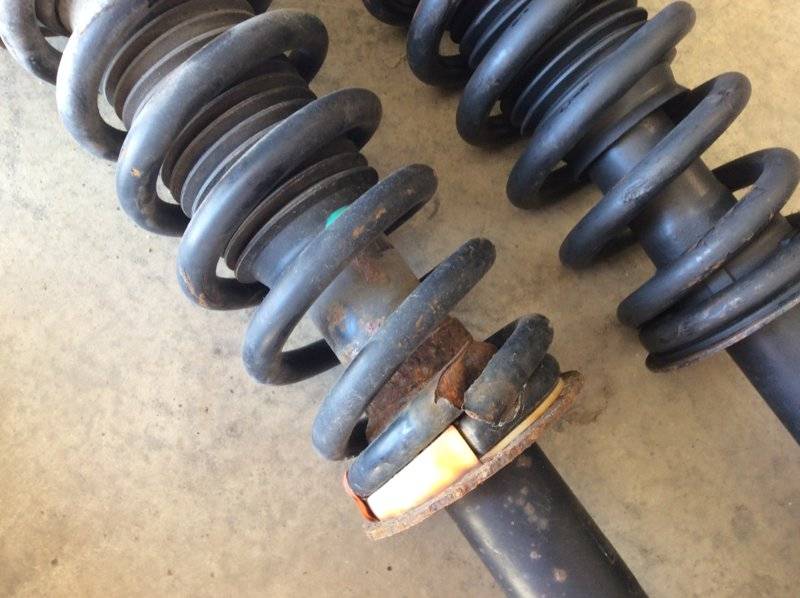

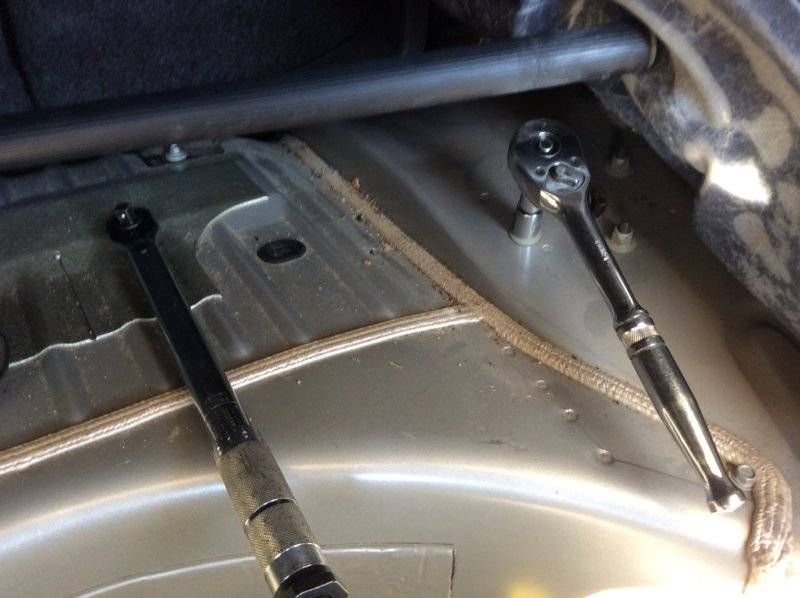

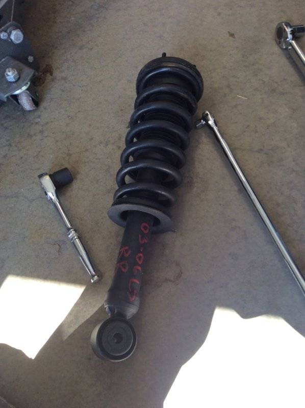

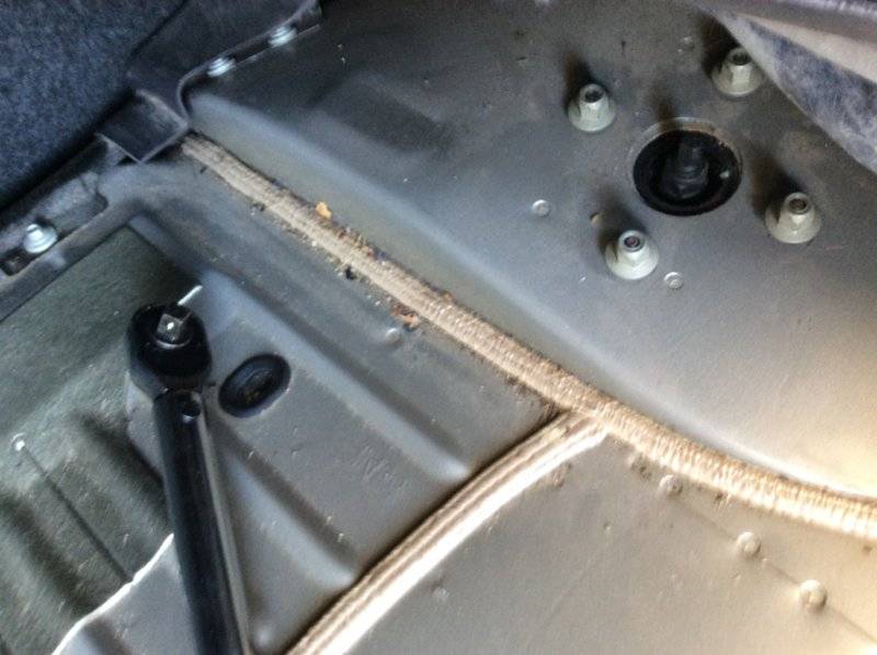

Changed out my Rear Shock absorbers ...boy good thing I did the Coil Spring went from a crack to cracked in half ...I got a great deal on eBay out of Keller, Texas OEM Shocks and Springs for $200 dollars ...Thanks eBay ...its really simple and straight forward to change the rear shocks ...21lbs. Per foot for top four nuts and 98 lbs. per foot for The bottom bolt ...they slip right out and in...don’t be intimidated with these absorbers it’s a really nice set up that Lincoln/ Jaguar designed ...I actually think the rears were easier than the fronts ...took me about an half-hour for both left and right rear Shock absorbers...the LS is riding like a dream again

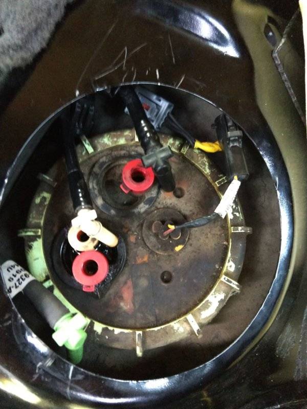

Today I dropped my car off to replace the rear suspension, front suspension (with exception of the front control arms and front shocks as they seem to be good for now),front wheel hubs, rear wheel bearings, valve cover gaskets and the fuel tank pressure sensor. Then after a alignment I think she will be almost good as new again!

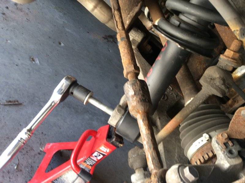

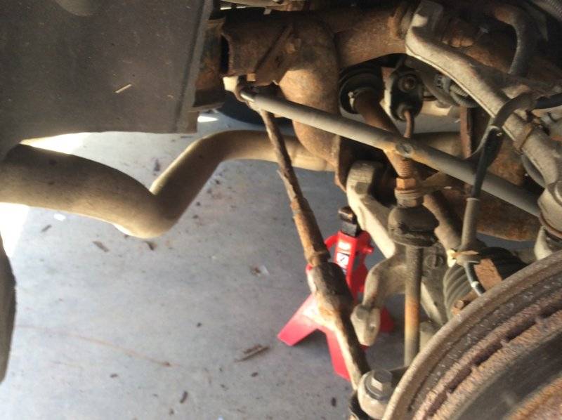

01V6 211k miles. changed the rear stabilizer links, the old ones had the rubber covers completely gone exposing the ball joints. New ones tightened up the rear end. My daily driver for 17 years.

How did Moog parts let you down? I just had some major difficulty with rear sway bar links. The nuts and bolts didn’t match broke.

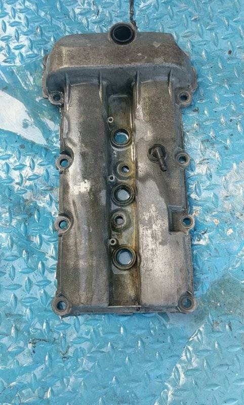

Doing my coils and plugs on my 3.0 so its a perfect time to do some painting!
Steps:
1) remove valve covers
scrub with dish pad/wool pad and your desired solvent/degreaser
2) sand down with 400 grit.
give it a nice wipe down with alcohol and wipe till dry
3) spray using high heat engine paint (if in step 3 you sanded it to the bare metal be prepared to buy high-heat primer and try and keep the brands the same)
4) Let cure for a few hours or if possible 24 hours before you torque down the valve cover bolts.
Can be waxed after curing process to protect the paint from unwanted dust and engine grime.
