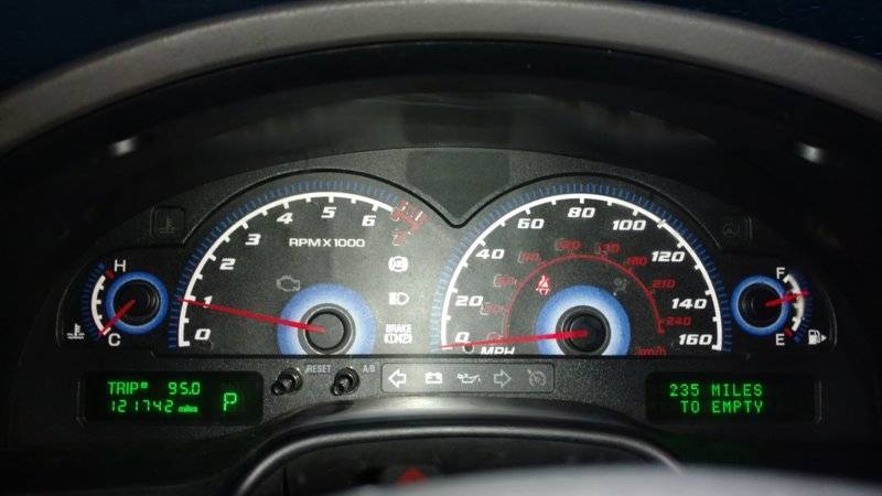

    Started the process of upgrading my gauges!
    Gonna work on that Green text tomorrow and then wire the backlight up to power.

      To have the instrument cluster illuminated without the parking or headlights being turned on, let's say when the key is turned to accessory or the engine is running, is it as simple as getting power to the dimmer switch from a different "switched" source? Like from the cigar lighter? I suspect the dimmer switch get its power from the headlights switch when they are turned on.

      No. It's data on the network that tells the cluster lights to come on, same for the radio and few other places.

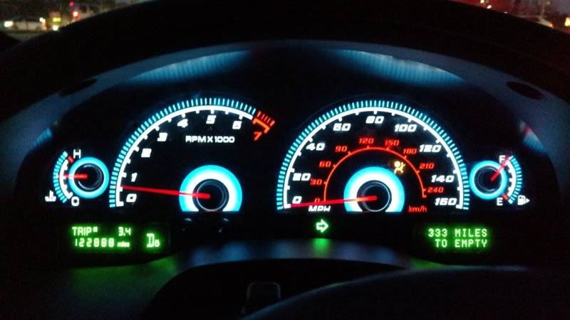

        I finally installed the light to my gauge kit! Will be working on the green text next. Also sorry that my camera is not the best on my phone! Also I need to clean the display a bit!

          Could you post how you accomplished to have the dashboard gauges always back-lit? It may be a good article to post in either sticky "Please read before posting" and/or "LS info.....". -Thanks.

          It came as a kit, the insert and the lighting have instructions that come with it. All you have to do is wire it into something that comes on with the key. If you are interested in that here is where I got it from. Free Ship Blue Glow 2000-2002 Lincoln LS Gauge Face Overlay LSE New | eBay
          I have not made my wire permanent yet but the wires are out of the way a

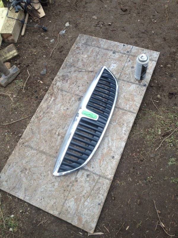

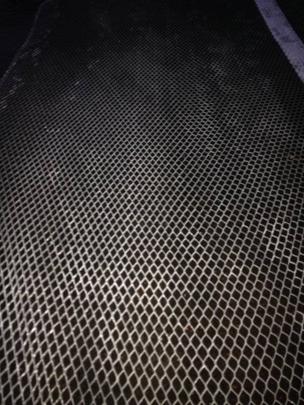

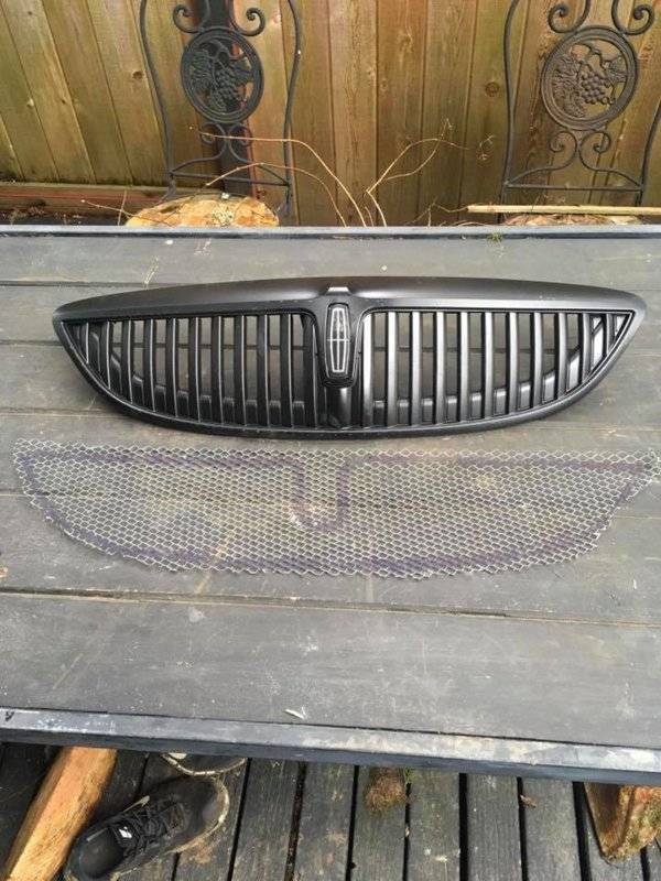

          Sprayed the grill with some primer and got my mesh, it was the thickest gauge mesh but it's still not thick enough, I'm going to double up to sheets and create an "X" pattern by overlapping. Out of Dremel discs so I don't know how the hell I'm going to remove the grill insert of the trim itself.

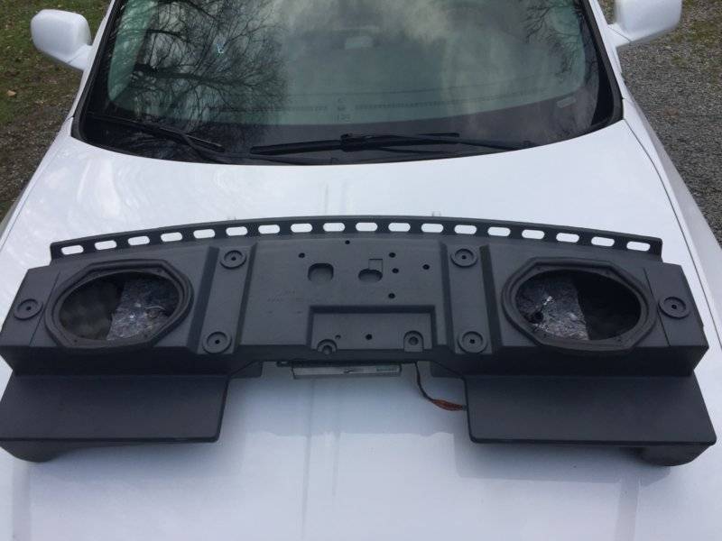

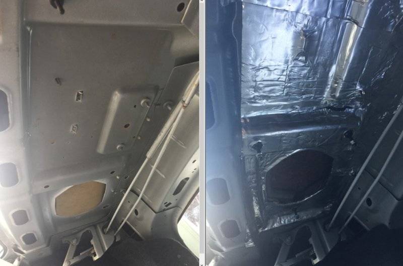

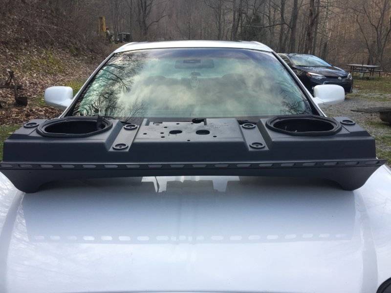

            Found the optional factory rear speaker enclosure local finally. Did some Roadkill 1st and added the mounting bolts. Went a step further and spray dyed the enclosure a matching grey to the interior and trunk plastics. Will be adding some Focal 5x7 component set of woofers in this with the tweeters mounted in pods on the inside of the car and a Focal 2 channel amp. Grabbing some Focal 6x9 grilles for under the rear glass section as well. I will mask off the logo and spray dye those to match the grey carpeting. Didn't post but already added Roadkill to all four doors and went with Focal 6 1/2 components up front, 5x7 coaxial in the rear doors. I also dyed the metal mesh grilles in the door panels.

              Those overlays have their own lighting built in them. They also have oversized needle holes to avoid removing them, so I assume its all in the name of minimizing difficulty and risk

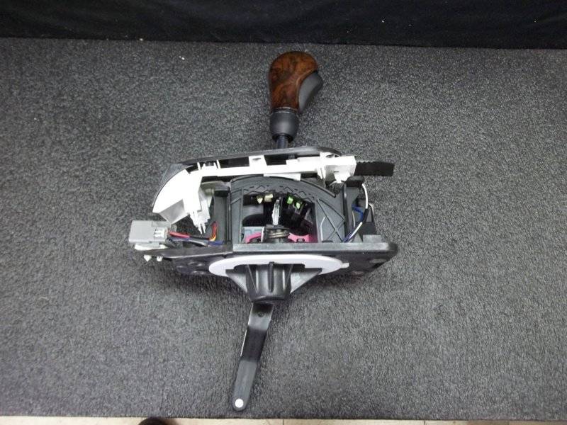

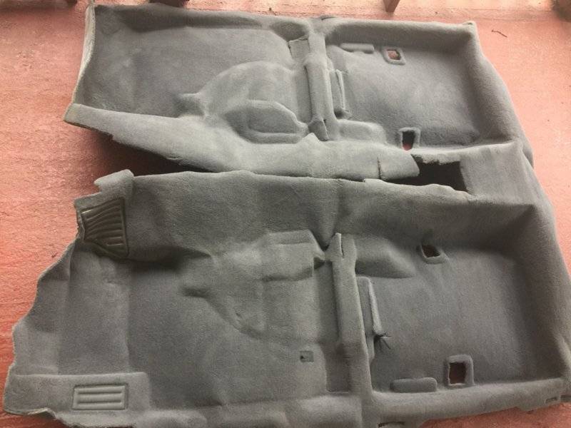

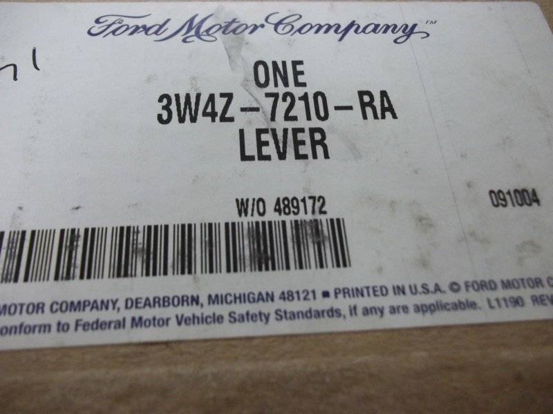

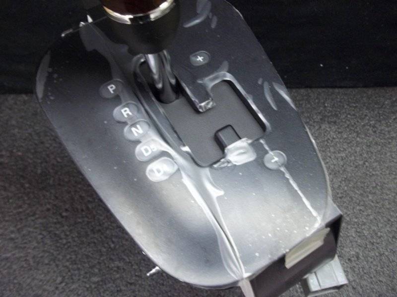

                  Sourced a NOS carpet and shift assembly to freshen up the two most worn out items of my interior.

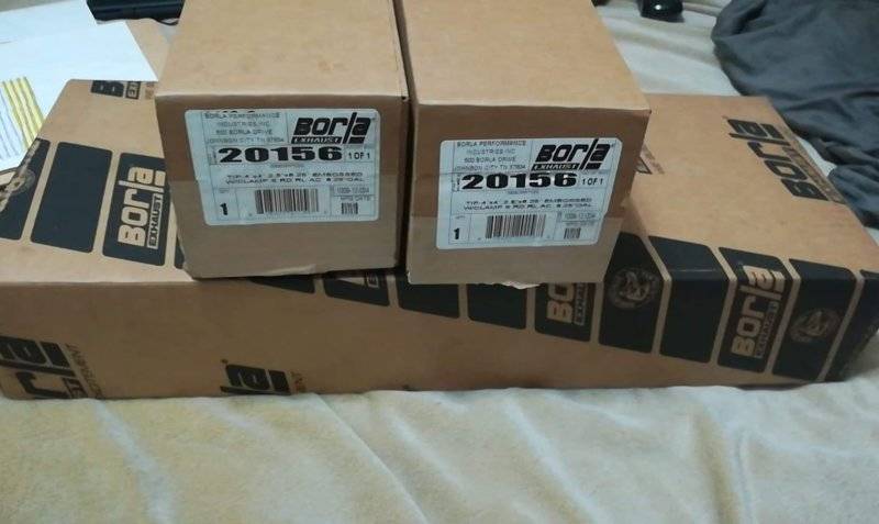

                    She's too quiet boys.

                    How much was the the entire exhaust system with tax and shipping?
                  • Destineal
                    Destineal LVC Member
                    Messages:
                    37
                    Likes Received:
                    4
                    Joined:
                    Feb 14, 2017
                    Location:
                    Fayetteville
                    $139.99 for the muffler, $69.99x2 for the tips, and $19 or so in tax. I live near a Summit Racing so no shipping. Muffler shop wants $240 to do it. I actually wasn't expecting to spend so much on tips, but when in Rome...

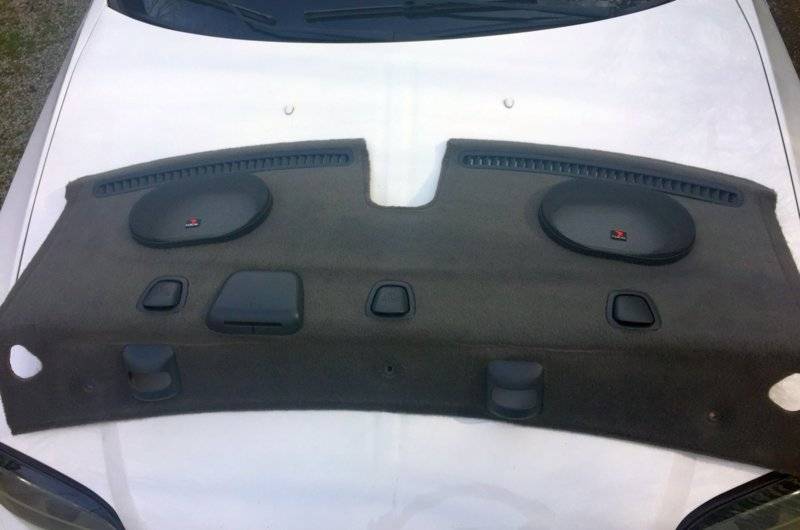

                        Pulled the rear glass panel, disassembled it, shampoo'd it, spray dyed the Focal grilles and plastics correct OEM color, and reassembled. Also found a new LSE rear license plate bezel that will be repainted and freshen up the rear.
