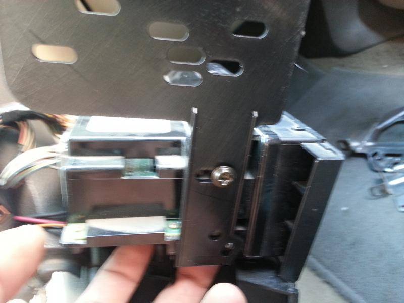

Hi!

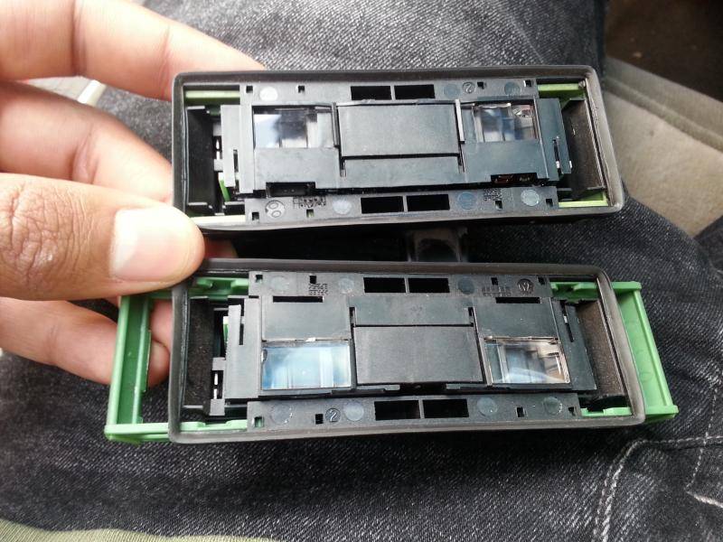

I replaced the rain sensor , now it's working :D .
The stock one was not flashing and never worked, the light stay at 50% dimm.
The new sensor stay full bright at startup then few seconds later start to blinking . I test it with a cube of water .
Check the photos , looks like the donnor was a 02. xD
-- Mine just blink once then it stay like 50% brightness and never work
-- looking for differences I noticed that mine has not a transparent rubber on the optics sensor.
year 00
-- Donor sensor stay full bright for a few seconds then starts to flashing.
works at first attempt.
year 02
https://youtu.be/dki2GbSFpGk

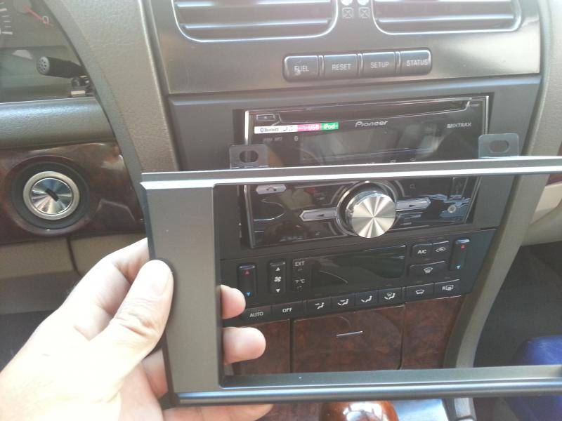

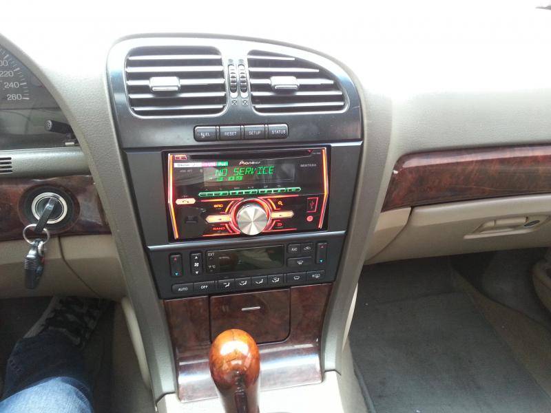

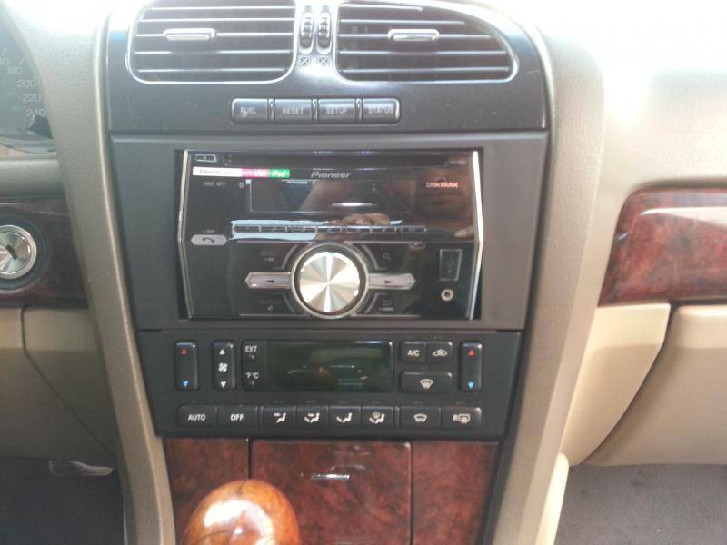

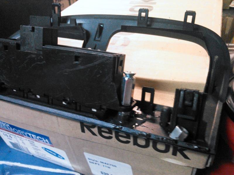

I changed the dash kit , the first one had a matte rubber finish and the plastic radio brackets does not fit , the new one match better and fit correctly.20151206_154845.jpg20151209_120622.jpg20151209_122221.jpg20151209_145944.jpg

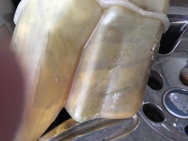

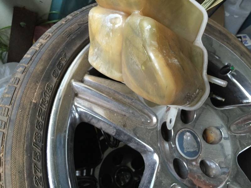

Temp jumped up and went back to normal. Usual suspect. Ordered oem one through body shop my brother works at $175.00. Also slight pic of my spring wheel project. One rear wheel has a crack that needs fixing and some curb damage on spokes.

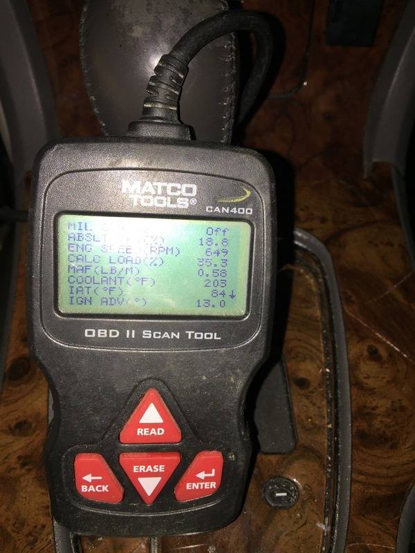

Got the degass bottle changed. Very easy. Had to bleed it twice. Seems alright now other than too much coolant in bottle now. Anybody know what temperature it should run at. It always run at halfway mark and my diagnosis tool says it fluctuates between 212 and 230 and the hand never moves.
That's too high. It should be in the 195 to 205 range much of the time.
V6 or V8? What year?
2002 v8. I do know the hand got 3/4 way up. The fan kicked on high and the temp light come on. This was During the first bleeding process.

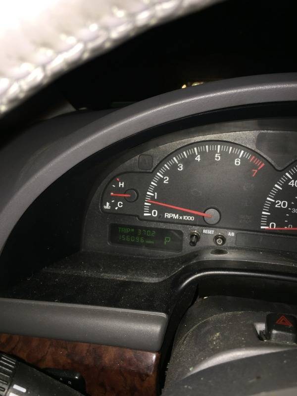

So instead of just checking it in the driveway. I figured I would drive it and see. This is what I'm getting. It 61 degrees here. Pulled over to take pics and post. Probably worrying for nothing.
Did you leave the degas cap off till it warmed up fully?
203 is okay, but if you haven't changed the thermostat housing, you will be...
Paper work says it was changed at 121,000 miles.
Along with t stat for some reason. It looked good on inside when I removed the cap to refill the coolant. I did put a new cap on it any way.

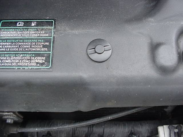

I changed the cabin air filter.
can't find ANYTHING in the owners manual about it ?
searching here solved all problems including how to take out the plastic rivets over it :)
replaced the fasteners holding down the cover over the radiator.
from Lowes.
hillman part # H#881209
they are 7/16.
the two outboard ones i had to tap down on the center pin to seat because the plastic there is thicker.
got the info from an old thread after searching..
