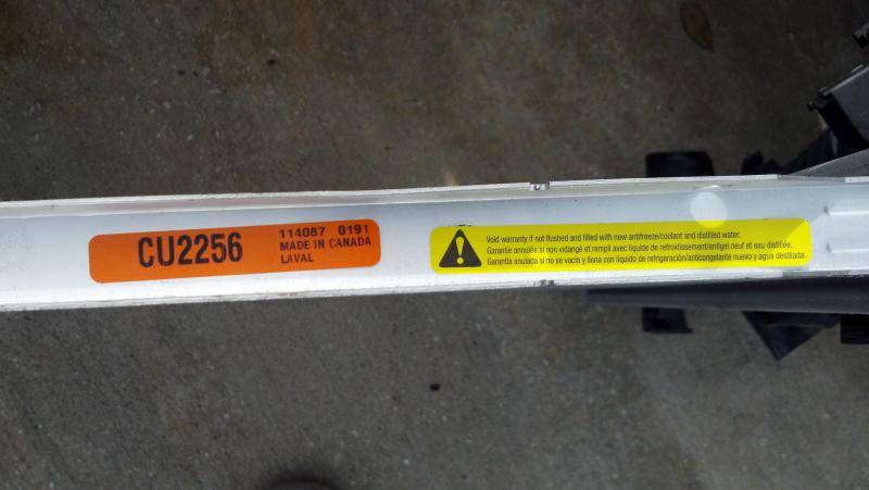

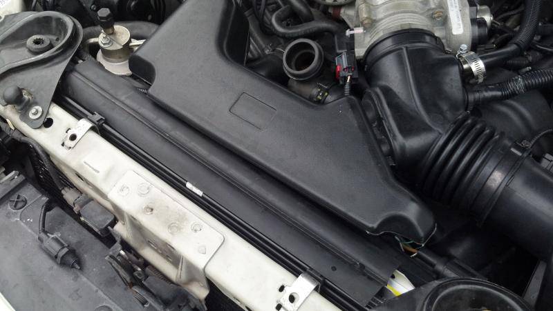

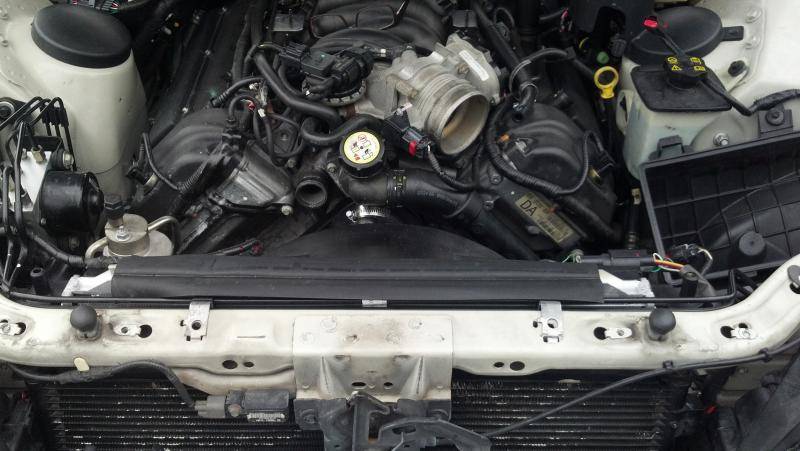

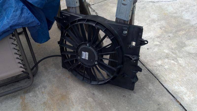

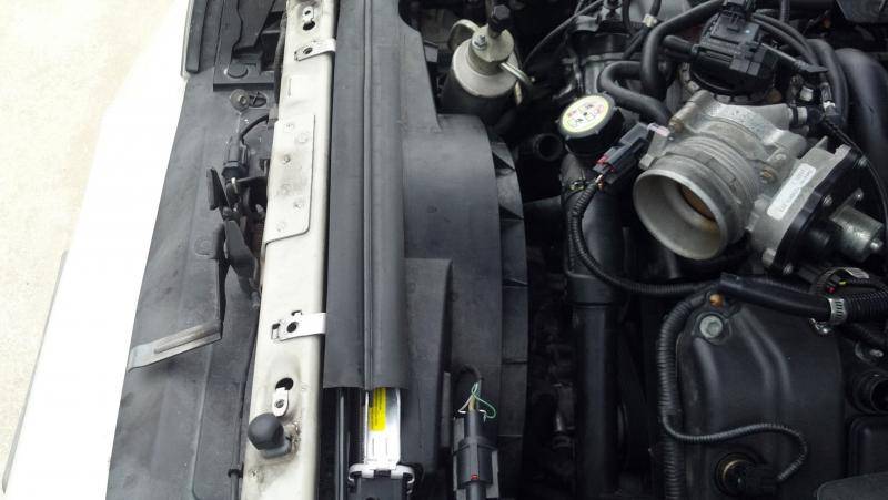

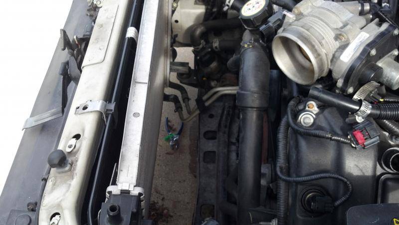

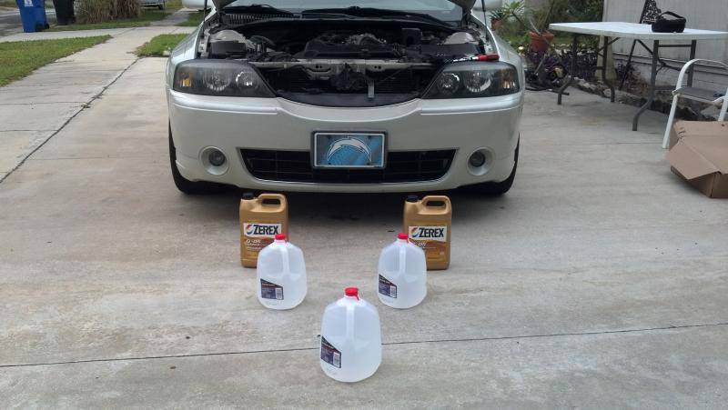

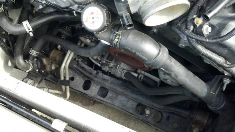

Today, I finished replacing my radiator. I started the project on Monday. It was a real PITA! I was going to have it done at a shop but they wanted nearly $500 just for labor. I pulled it from the top and without jacking it up.
View attachment 828474747uploadfromtaptalk1450910042203.jpguploadfromtaptalk1450910075926.jpguploadfromtaptalk1450910105766.jpguploadfromtaptalk1450910144998.jpguploadfromtaptalk1450910180888.jpguploadfromtaptalk1450910217847.jpguploadfromtaptalk1450910248772.jpg
She is bled, fed, and I'm nearly dead. I got my radio on, I got my pretty red goggles on, and I'm ready to go to bed!
... It was a real PITA! I was going to have it done at a shop but they wanted nearly $500 just for labor. I pulled it from the top and without jacking it up...
Just for reference, you can pull it from the bottom just by driving up on ramps. There is plenty of room to tilt the radiator in and out that way. It looked to me like it would be (much?) more difficult to pull it out the top because of the parts of the radiator that stick out and the refrigerant pipes that are in the way.

Thanks for the tips. Do you think the lower shield that goes from the bottom of the bumper cover the rad housing would effect it much on these cars. I know on some cars it could. Mine was gone when I bought it and the dealership could or wouldn't tell me if there is a difference between the LS one and the LSE. I would like to get one. It is running a tad lower on the temp gauge than it had before but I never thought about putting a scanner on it to check before now.

... lower shield that goes from the bottom of the bumper cover the rad housing would effect it much on these cars ...
It should be present, would naturally be best, any car is designed to move air in around the fins of the radiator, when there is a large gaping hole due to some plastic missing, one would think there is a disturbance in the air flow, as much would escape down below. If it's contained as designed, it would correctly force it directly through the fins thus providing optimum cool down.
I was looking at the refrigerant pipes for a while. When you disconnect the canister it will fold down out of the way. The other pipe on the driver's side can be pulled aside too. I lowered the condenser and that made it a lot easier.
