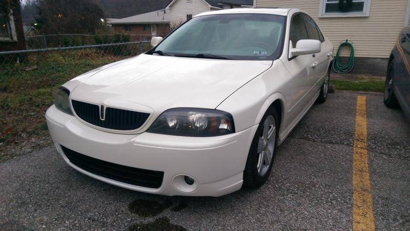

This was for the opposite end, (will new headlight ideas)...
Picked it up from the body shop.

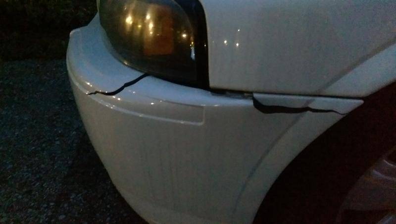

2 weeks ago a nice lady backed up her rental Dodge Dart into the front driver side bumper. Cracked it, not too bad. I was home when it happened, but I park my cars in a parking lot across the street so I didn't see or hear it happen. I just happened to walk by a window and saw the lady standing outside her car writing a note and my stomach immediately turned because I knew what she was doing. So I went outside and she gave me all her info (Erie Insurance). Erie actually called me ASAP, before I had a chance to call them and said everything checks out and gave me a list of places I could take it. One place was a mom and pop body shop from the area I went to high school. I picked that one. I didn't have any direct concerns but in the back of my mind I kept thinking, man what am I going to do when I go to pick it up and it has Gen I bumper on it.
Took it to them last Thursday for an inspection, took them about 20-30 minutes. Dropped it off for repairs Monday morning and they called me Tuesday evening to say it was done. It was super dirty when I dropped it off because they have been on a rampage recently cleaning up the neighborhood and have demolished 3 houses and built a parking lot. I don't drive the LS a lot so it's been covered in dust and dirt from the construction. I went to pick it up today and it had been washed and given a new inspection sticker, they just took it upon themselves.
Looks perfect too, couldn't be happier. It's rare enough someone does minor damage to a car in a parking lot and actually has the moral fortitude to leave their information, then to have a completely painless repair process with a shop that goes the extra mile. Too good to be true, had to share.
Cheers, fellas.

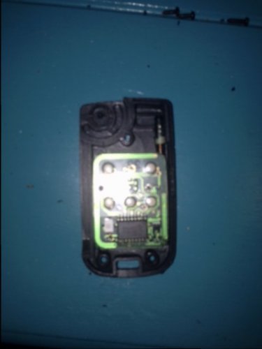

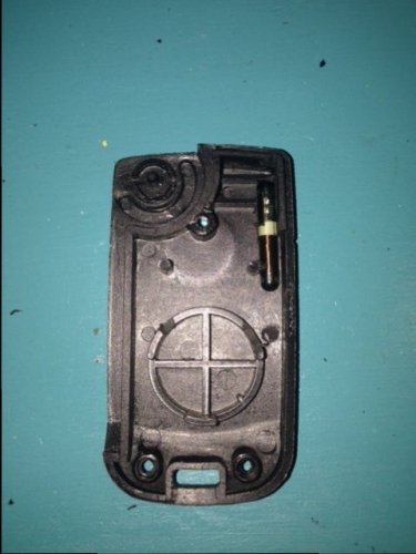

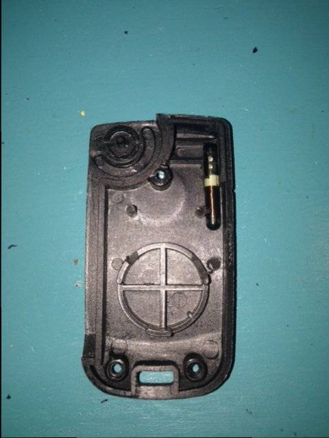

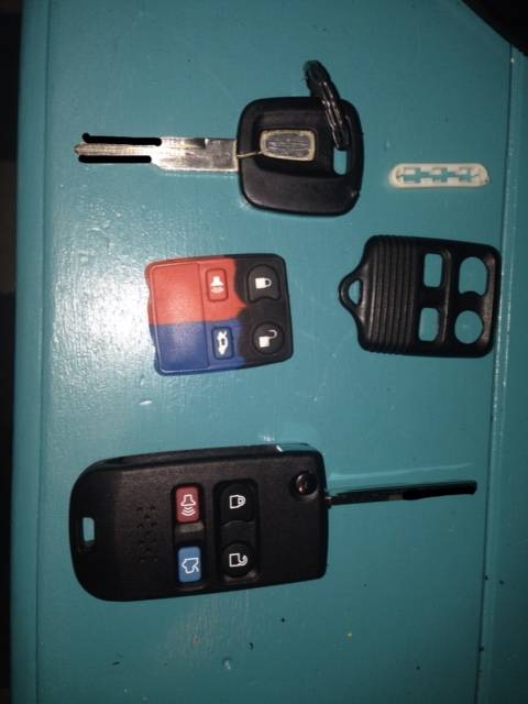

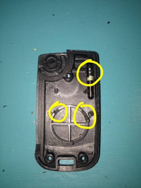

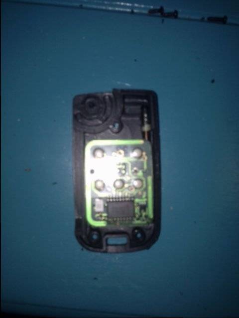

Completed my flip key. WOOHOO! no more separate key and fob.
I had to modify the inside to get the fob guts and the chip to sit appropriately. Other than that it was smooth sailing. I got the keys cut at Lowes for free. They didn't charge me anything. I first tried Homedepot and Ace. Neither would even touch the keys because they don't cut customer keys. Here you go:
