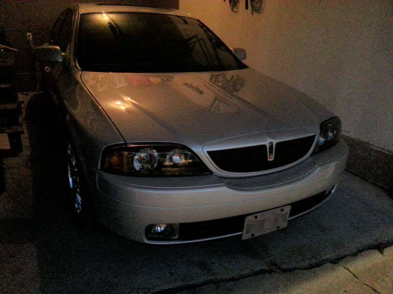

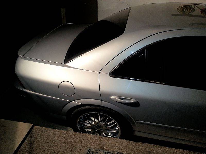

Polished it all late into the evening.
yup, took much longer than it needed to but all the major work is done. I'm sure there'll be more.
