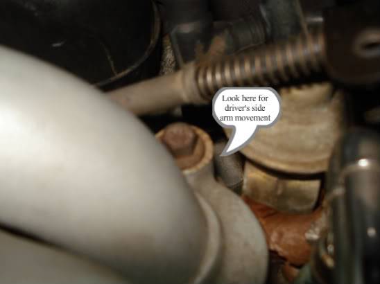

Gonna try to snap some pics now of the IMRC function, to reinforce what has been said already...
Ok, just did it. My engine was cold so i did not rev it up to operate the IMRCs. Instead, i looked at the arms and disconnected / connected the solenoid a few times to verify their operation. Engine stumbles slightly when you do this.
At idle, the IMRCs should be closed. When you disconnect the solenoid, they will open. (or if you rev over 3K - but never rev a cold engine)
Can't show you the arms themselves, but can show you where to look.
To clarify: Pic 2 is looking below the throttle cable.
Pic 3 is looking under the air intake tube.
If you look in those locations you cannot fail to see them moving. (assuming they work)
BTW, they move pretty fast!
Need to make sure the shafts on the IMRCs are turning.
you can see them from the front of the motor, if you look closely.
drivers side is harder to see than the passenger side, but take a look "behind" the crossover tube" where it enters the intake.

93, Thanks for the GREAT pictures! I might not be able to get to it tonight because it is getting dark out but tomorrow i'll definetly grab a buddy and have them rev it up to 4k right?
No problem. You can do it on your own just by operating the throttle linkage, but if a buddy is available then by all means, use him.
Remember: If the engine is cold, and you want to see the IMRCs move, try the solenoid trick. Once the engine is fully up to operating temperature, then do the rev over 3K. (i hate it when people rev up cold engines - Lol)

I'm more of a visual learner, those picturs cleared everything up. I'm gonna try and test this out tonight at a gas station - just removed teh electrical connection at the solenoid right? or the vac? You had your hand on the top part of it which what looks like the electrical part of it.
When i did the test earlier, i disconnected the electrical connector at the solenoid so i could operate the IMRCs without revving a cold engine. It's like this: Engine at idle, IMRCs closed, disconnect solenoid, IMRCs open, plug solenoid back in, they close again etc.
If you are going to the gas station, drive around for a few minutes first, to warm the engine up, then, you can simply operate the throttle linkage to rev over 3K - no need to touch the solenoid in that case.
Use a light to see down there - you'll have a hard time catching the fast movements otherwise.
BTW, i don't think our OBD 1 cars throw codes for sticking IMRCs - my 93' definitely does not.
ok drivers side works but the passengerside is more difficult to see... That's not to say it's not working. The car drives like shot with the solenoid unplugged. I did this to see if it would throw a cel and to test drivability. Passengers side is def harder to see I'm still having trouble finding it, maybe it's stuck because it's the movement of the drivers side that catches my eye.
Keep looking - you using a light? It is a little more difficult to see, but you will see the movement if that side is working.
Edit: Ok, cool. Move on to your next checks!
Oh, how much do they move? Should be approx 90 degrees, very fast and kinda 'snappy' (just trying to confirm that they are not sticky, sluggish or hanging up)
yea they are fast and snappy! Thats kinda why they are hard to see they move so fast. I wonder why gen 1's don't have a code for this. They are pretty important.
