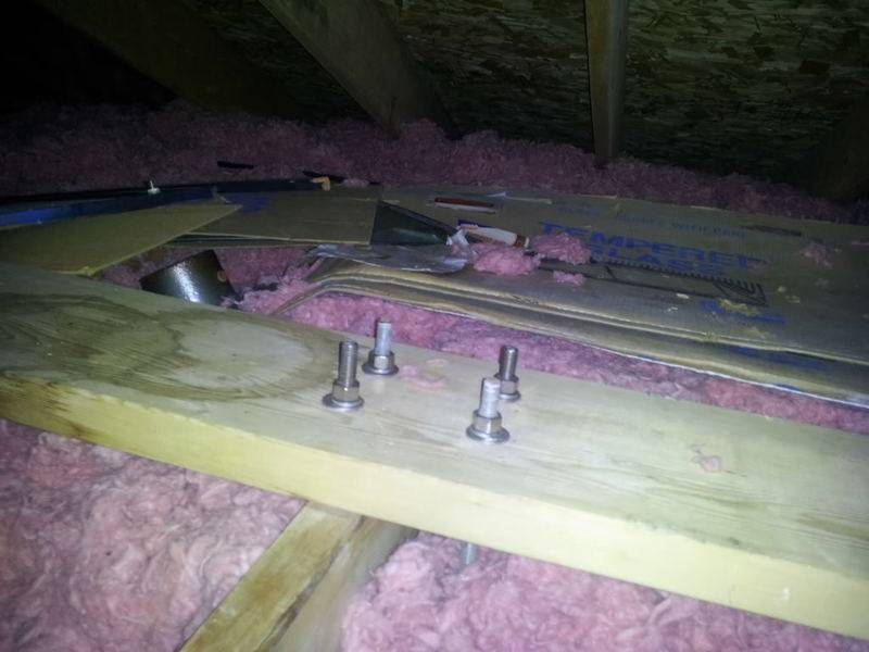

Its plenty strong,
Ill describe it more later. I'm drilling my anchors for the hoist right now.
You might want to consider a square metal plate to eliminate the possibility of those bolts pulling through.

And Doug, you have a good eye.
I noticed that the 1st time I poked my head up through the hole in the ceiling.
I already have the plates drilled and ready to install.
Good. Just looking out for a friend. ;)
