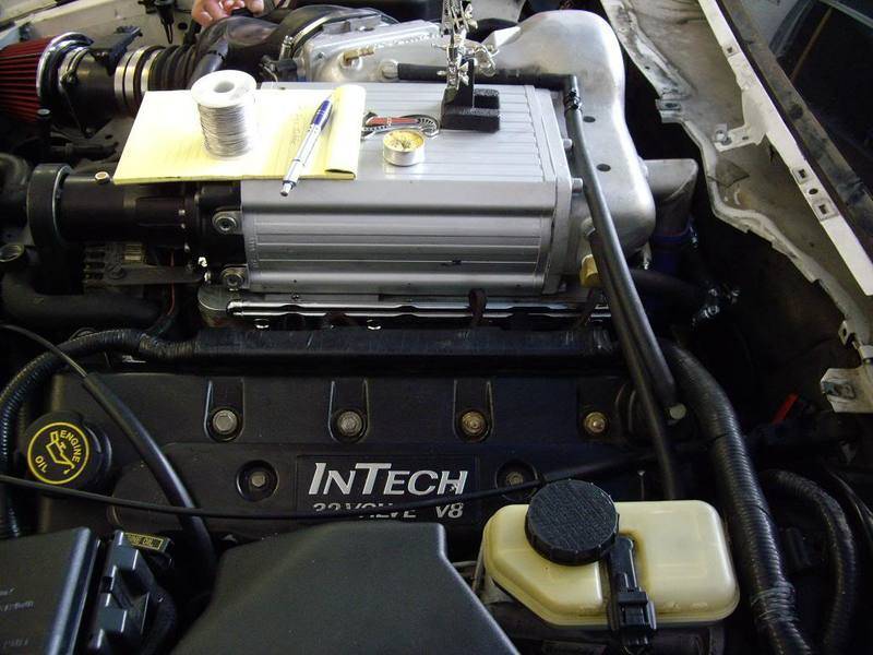

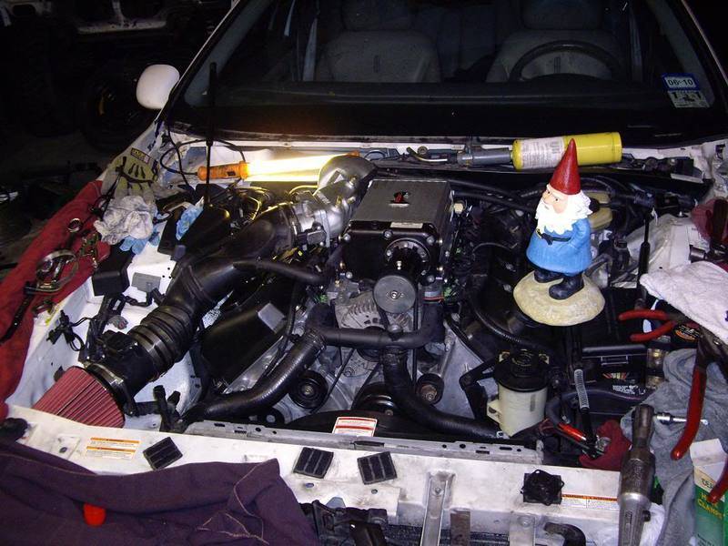

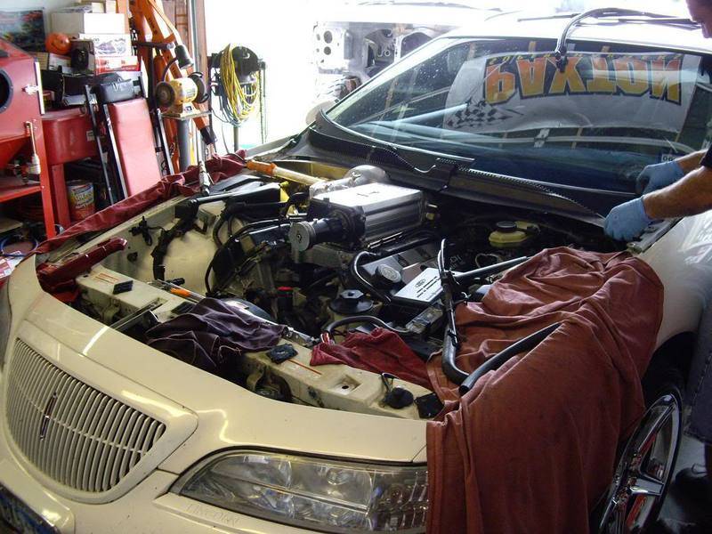

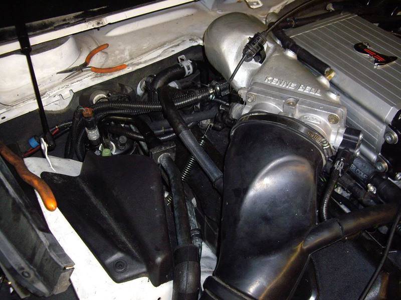

Still in the middle of the install. The Doctor decided removing the hood and cowl was the way to go so that is what we did. Made thiungs much easier to drop the blower in place.
You can see a huge difference in the space available wih he cowl off. Also showing where the IMRC box is since I see i asked so often. We removed it since I now have deletes.

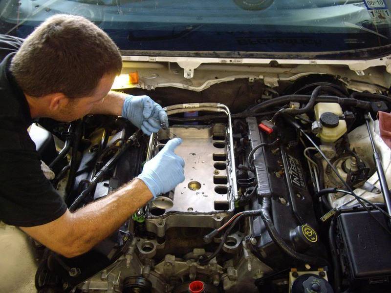

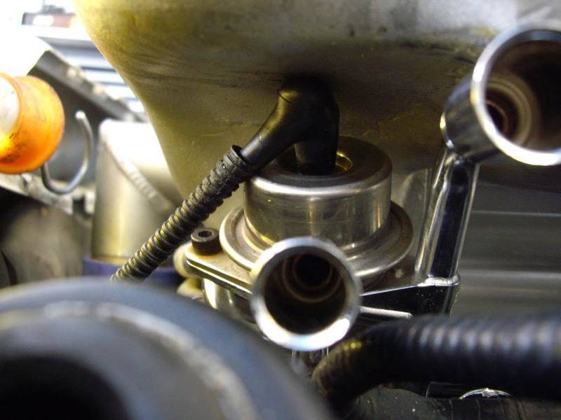

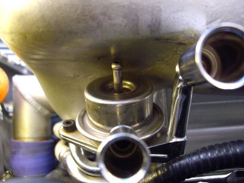

So next we took the blower back off and then gooped up the plenum.
Of course that led to the next problem.
Somehow he managed to get it in there.
So this is where we took a break to make the 6th parts store run and locate some fittings as well as a 120" belt.

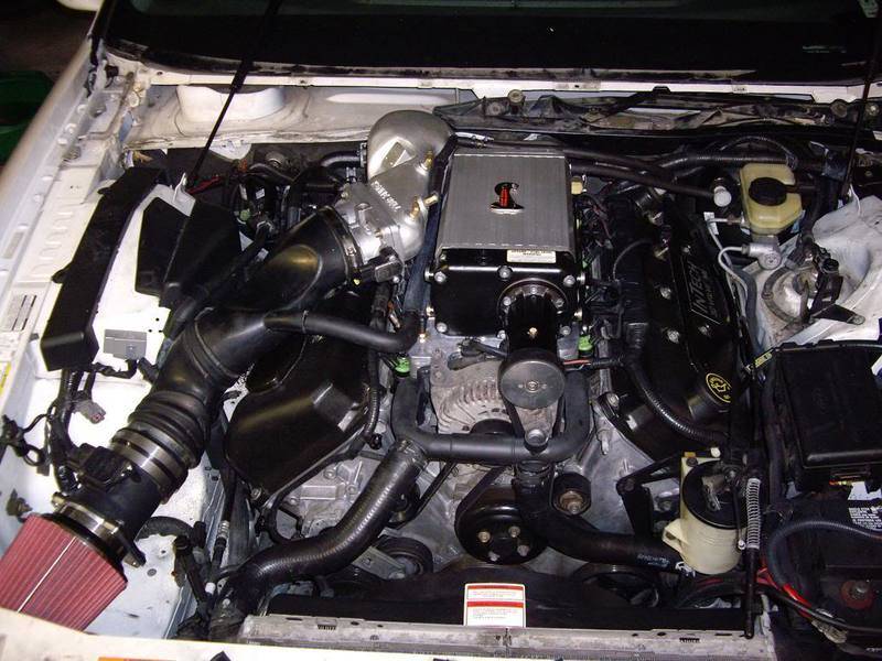

What a day! Jeff has absolutely worked his pointy hat off! Lots of snags along the way but all dealt with very well. His attention to detail is amazing! He worked very hard to make it look OEM and hide or remove all hat wasn't needed. My hats off o him!

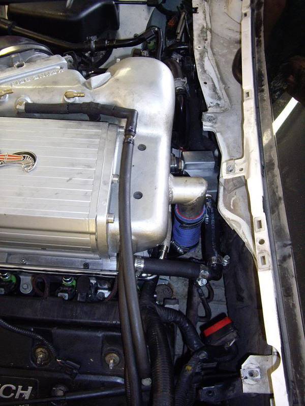

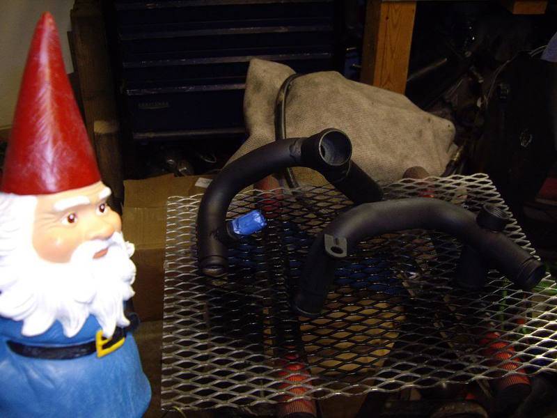

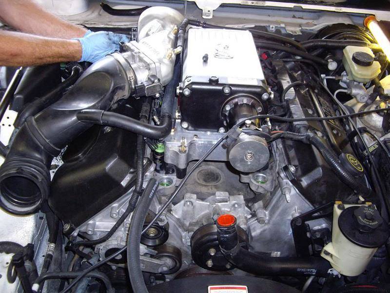

So after deciding that the air injection pipes had to go I watched him go in there with a sawsall, torch and finally a welder! :lol: It was nuts but really looks great.
Then he cleaned up the crossover tube and put in new o-rings.
Go it all together and did some other minor touches to really give it an OEM appearance.
And here he is admiring his handy work. :D

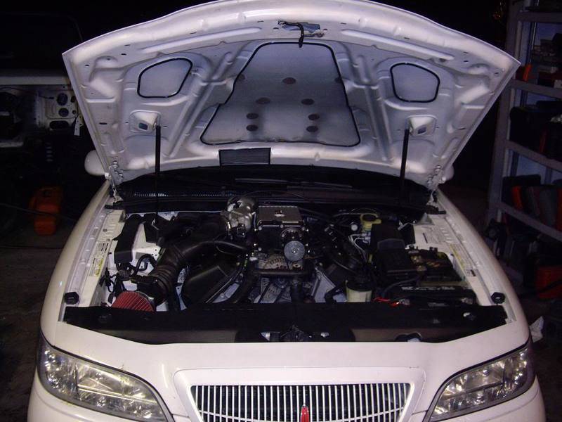

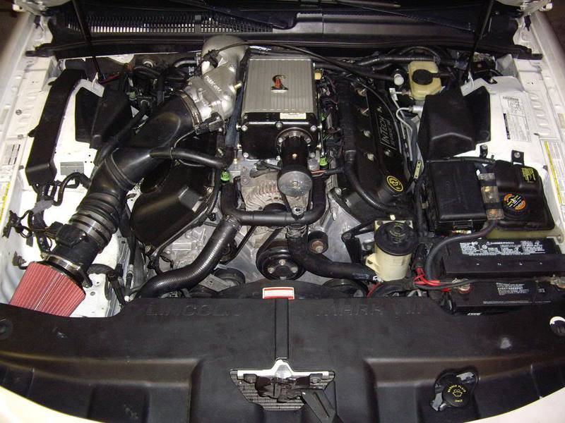

This is where we called it quits. Still have to trim the hood some and do some wires but its pretty much done. Did a through fuel leak test and was perfect on the first try.

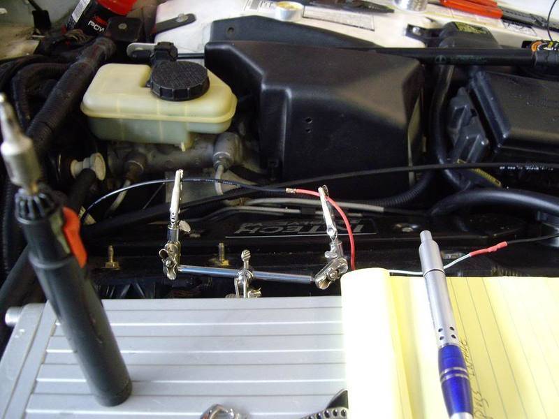

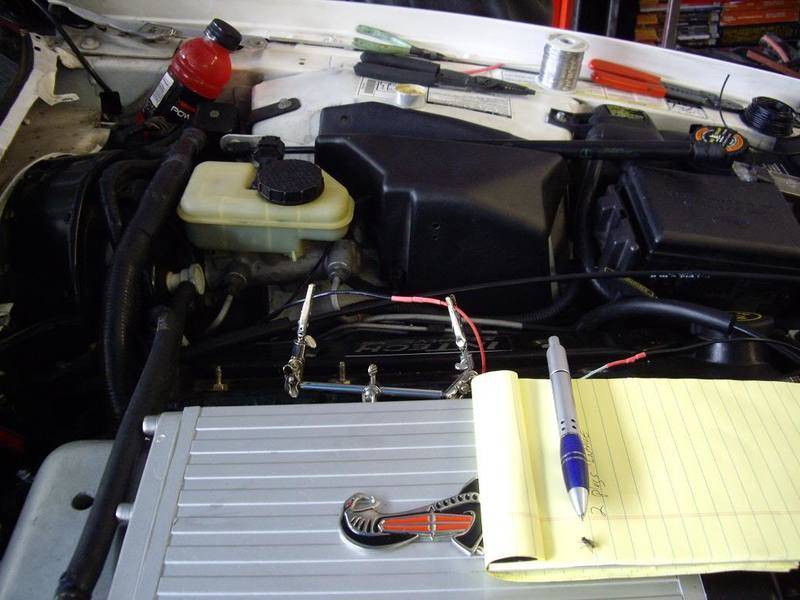

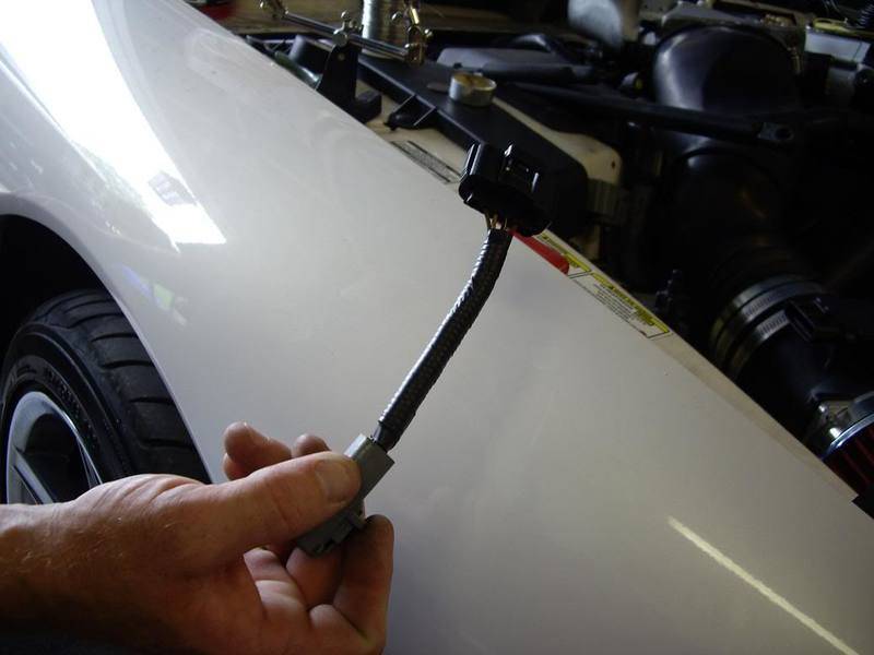

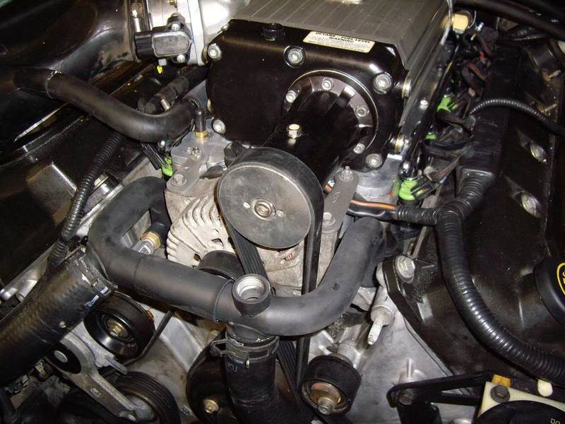

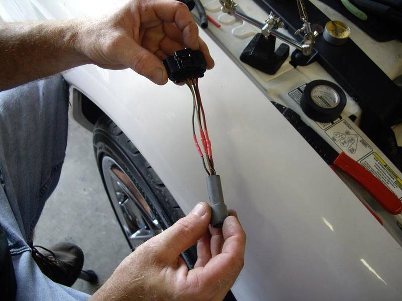

So onward and upward. We are very close to initial start up of her. :) Had to extend some wires for all the relocated stuff. This first one is for he IAC.
And doing that cleaned up the drivers side of the engine very well.
Aside from the throttle cable its done on the drivers side.
Then had to shorten the MAF wire.
SVO also extended the IAT and TPS wires in the same fasion. After that he covered them factory style and hid them away.

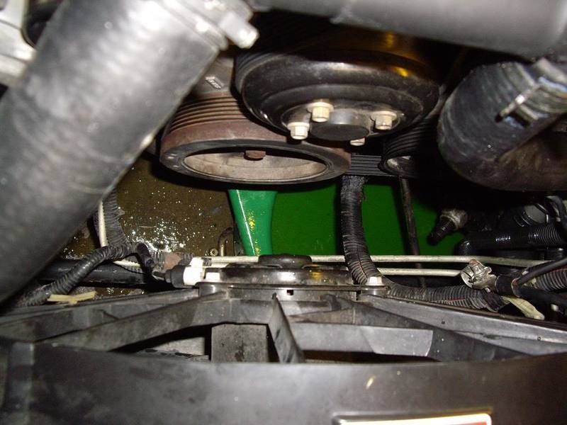

So here is a shot of all the rest of the air pump stuff going away. :)

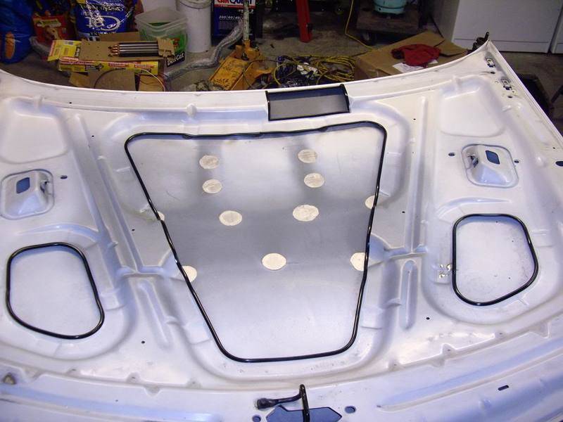

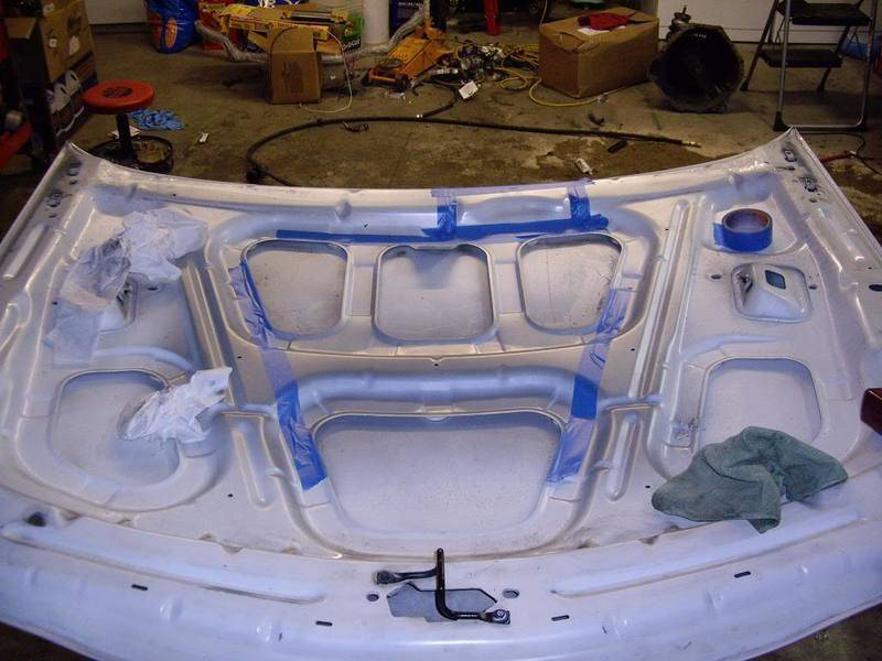

So for the last part of our journey into hell SVO had to cut the braces and then I scrapped off the old rubberized glue crap.
And here is our finnished product. Had to space the back of the hood up 1/4" to clear the throttle cable bracket but its hitting the brace. Again, we just did not have any more time. I got hom at 5:00 AM and then left for work at 7:30. :eek:

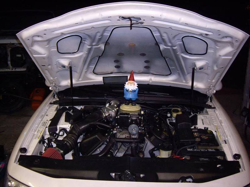

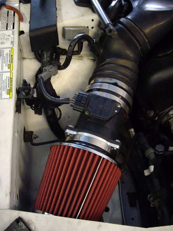

Ultimately I tried to make this look as factory stock as possible except for the conical air filter, but including the hand made bracket for the MAF/filter.
If I could have had some more time I would have done a WHOLE lot more detail work, maybe here in a few weeks he'll let me get my hands on it again and I'll do some really nice tidy up work on some of the nasty looking parts that need to be cleaned that will reall make the engine compartment pop.
All the pulleys, alternator, clean the inner fenders, replaint the underside of the hood, ah hell you all get the idea.
And fab another cruise/throttle cable bracket.
Enjoy!
