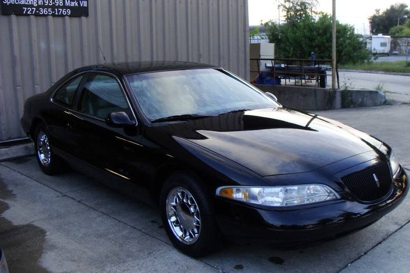

the 98 is finally on the road!
nope, in one week??? i highly doubt that. no one will guess because i havent even put out a single clue.
It is a body kit of some sort..
I think I remember him stating a few times where he hates body kits on these or any other car.
His rims are being black chromed. I have to be getting damn close because I know this dip sh!t. Normally he would tell me what it is but not this time. I knew it wasn't 22's but I have a feeling it has something to do with the wheels. Might even be going back to stock size.....:eek:

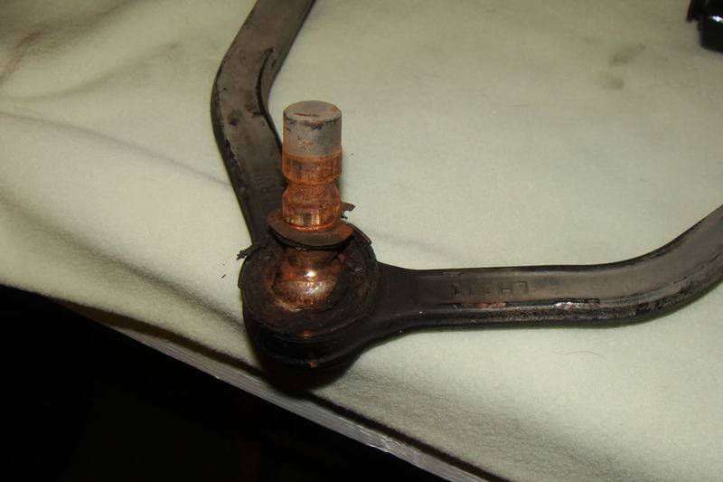

hey Jamie what are the tools need to remove the lower control arms ? I'm looking to purchase them and have them in case i need to replace mine instead of paying someone to do them....
From what I saw Jamie do to mine, nothing special. The big problem with mine was getting stuff to break loose. Be sure to have a balljoint seperator fork and a 15/16ths (I think) deep well socket is the only odd tool you may not have in a regular set. Some of this stuff is on there like a SOB so some PB blaster and 1/2'' drive tools and a cheater bar or air tools would be great. Be sure to mark your alignment before you pull it apart so it goes back together close until you align it.
