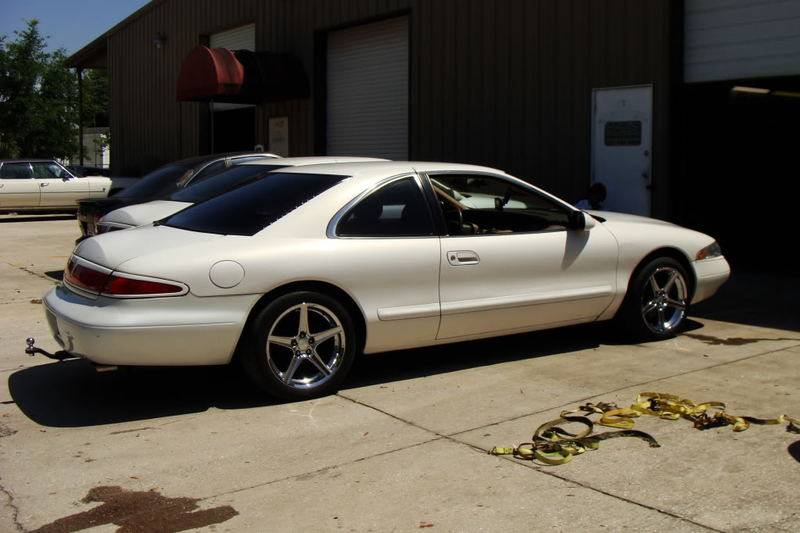

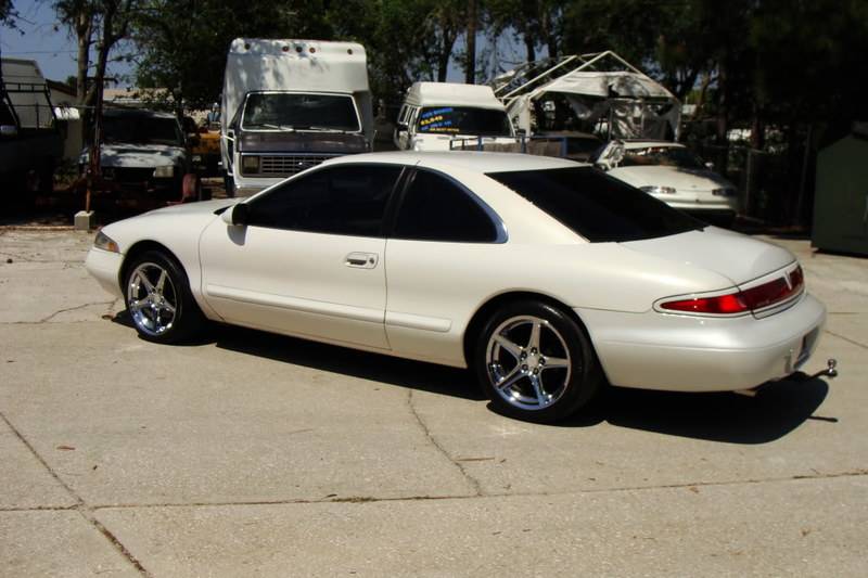

We are running 24mm offset mustang wheels.
ok then explain to me why my old speedstars, which are exatly the same to my black ones in every way, are rubbing on my great 8's 98 mark, with stock air ride and its an inch and a half higher than my car in the rear?
Are they rubbing on both side or just one?
If its just one then I would say his car is just a little off center... I've heard of cars being off by an inch or so...
i dont know i think he said only the driverside rear rubs, it doesnt make sense unless the air ride isnt fixed and still leaking which would explain why it rubs, rich why are you still shutting the air ride switch off if you fixed the leak? those tires should never even come close to going up in the wheel well.
I have the same wheels as Jamie and they rub on both sides. Car at normal ride height and they sometimes rub on dips. When over 60mph they rub much more often. Soft sping rate and super soft shocks allow for much more suspension travel then high rate coils and stiffer shocks offer.
That being said, Jamies car is low enough in the pics that it should rub if his suspension traveled more then 1.5" in the rear. So you (Jamie) drive slow or have very smooth roads OR there is a slight roll and you just never noticed it.
Is the plastic ear still on the upper part of the rear bumper where it screws to the fender? Thats the worst spot for rubbing and I have had to cut it off before.
See this is how low mine goes before it starts to rub bad. The area circled in red is where the plastic ear used to come off the bumper. I think Nolan cut them off before I got the car.

I shaved the fenderwells with an angle grinder nice & slowly until nothing was touching anymore, sanded to smooth out the roughness & applied Rustoleum to the bare metal. It worked well for a 40 minute job, not show quality well but you can't tell unless you're 3 inches away from it.
bill you can ask diesel dan today at my shop my fenders are not rolled, and driving slow in florida will get you killed. we have our share of dips and bumps i think you guys have other issues cuz i dont ever rub ever.
