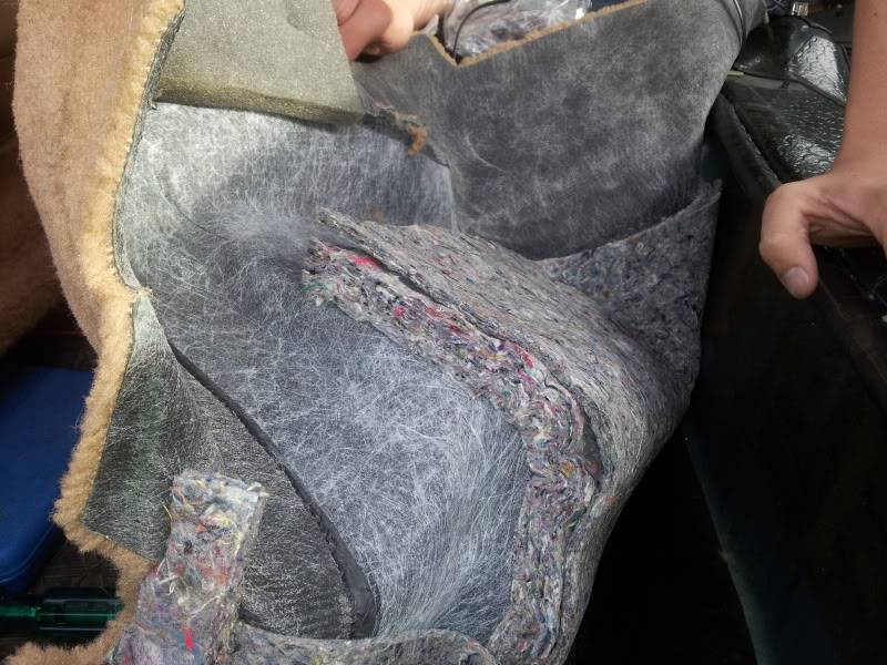

They are really isolated these cars from factory.

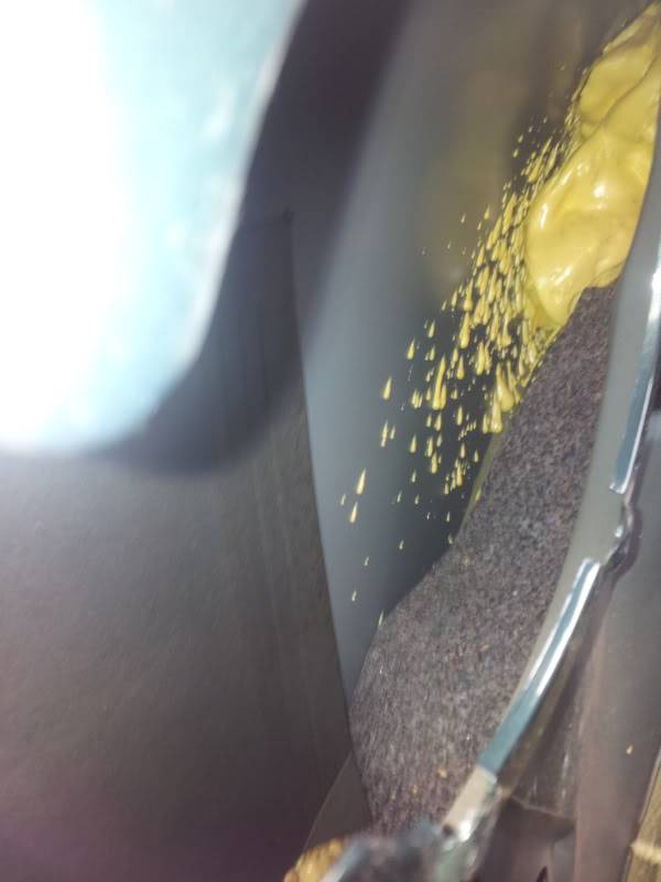

Wheel wells filled with foam :D

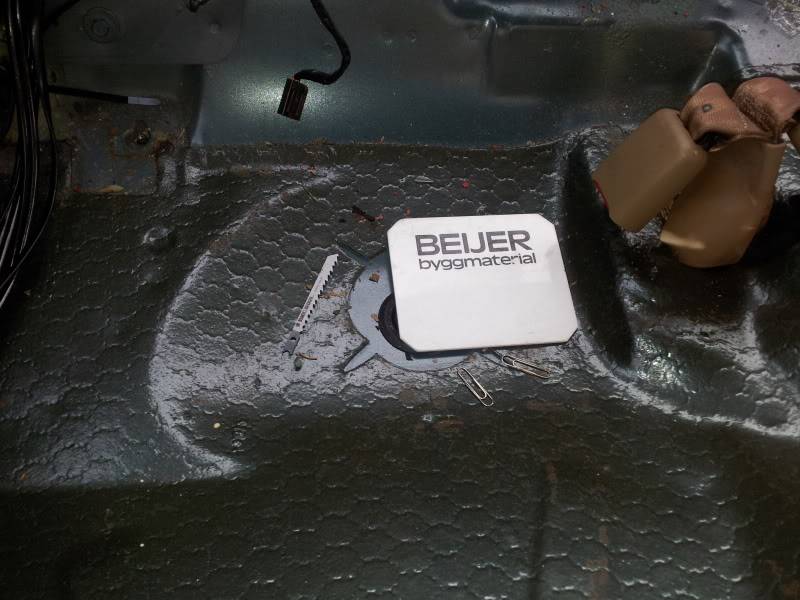

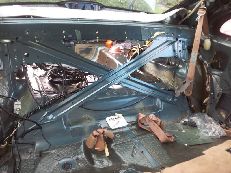

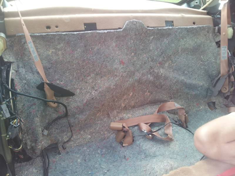

What I found UNDER the isolation under the backseat. A saw blade, ice scrape and some paper clips.
How the hell did that get under the isolation?
Isolation under the floor mat, damn it's thick!

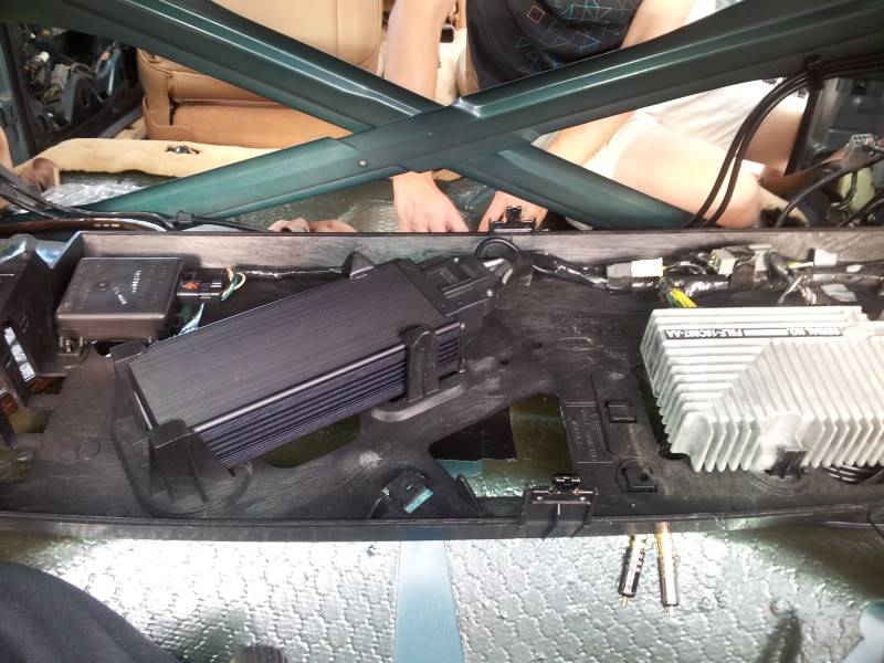

The phone unit, compass and original amp :)
Tadaa! It's empty now!

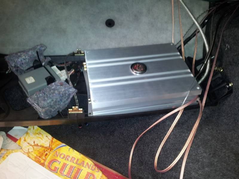

A picture of my fathers installation in his 1993 Mark Viii with a DLS CA41 amplifier in the position of the original amp (it's gonna be hanging upside down in the metal, not in the plastic thing as it is atm).

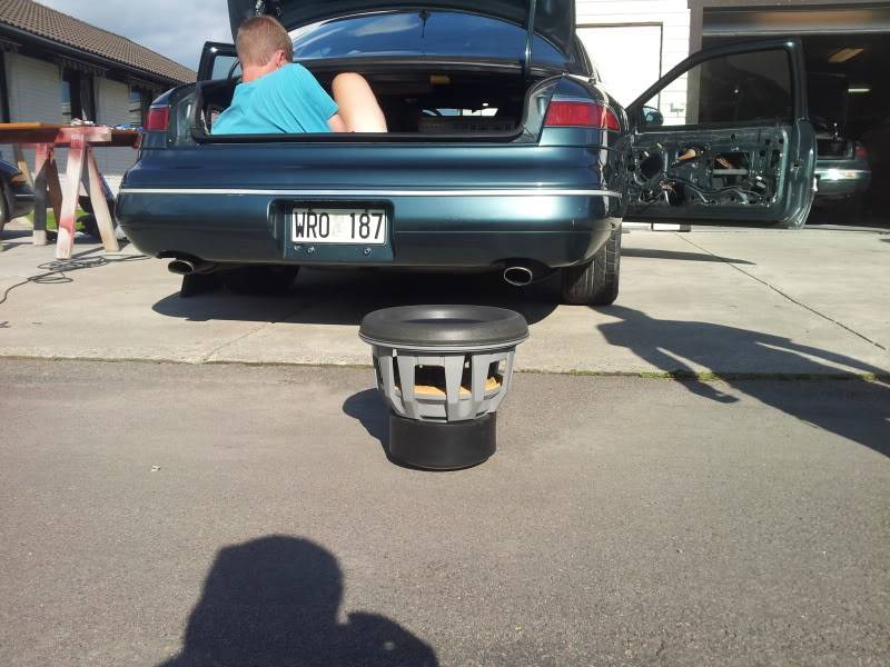

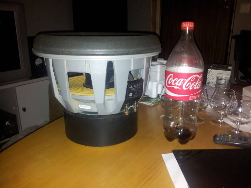

For those of you who havn't seen a JL 12w7 sub before, it's huge. It's really big! Next to a 1.5L coke bottle

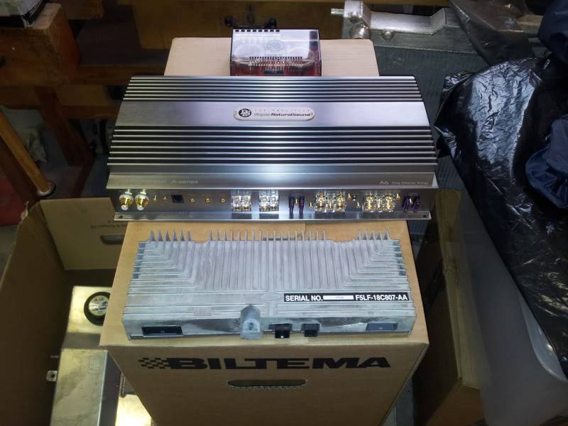

Bonus pic of the original amp, my DLS A6 (my A3 for the front system is the same size as the A6 mono) and one of the crossovers for the front system. They're HUGE! Doesn't fit in the doors so they will have to go in the trunk.

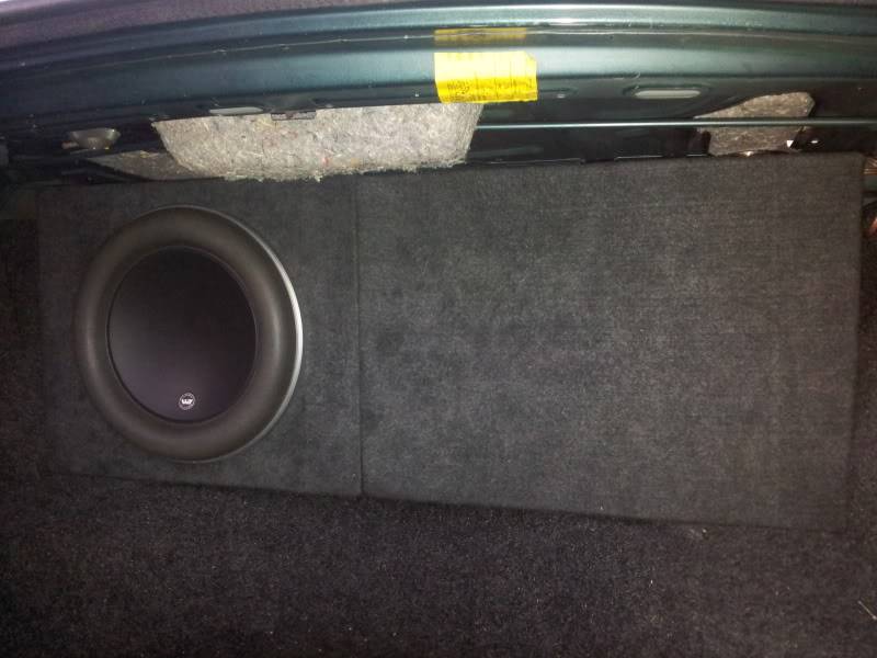

All for today! I've been doing som measuring for the subwoofers box and it's gonna be really tight. Really tight! But it's going to work, hopefully :)

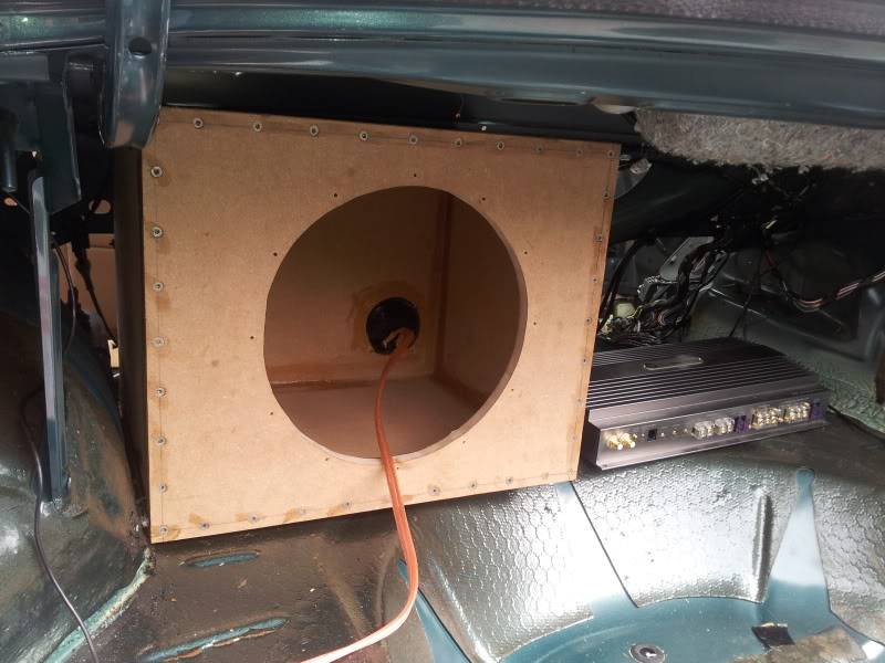

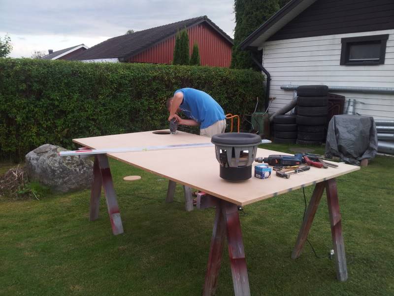

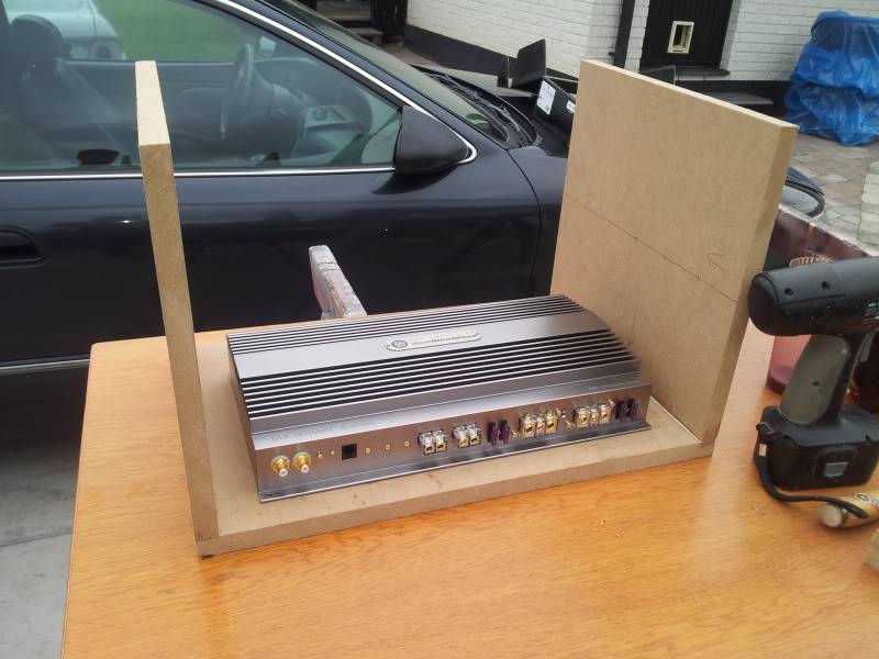

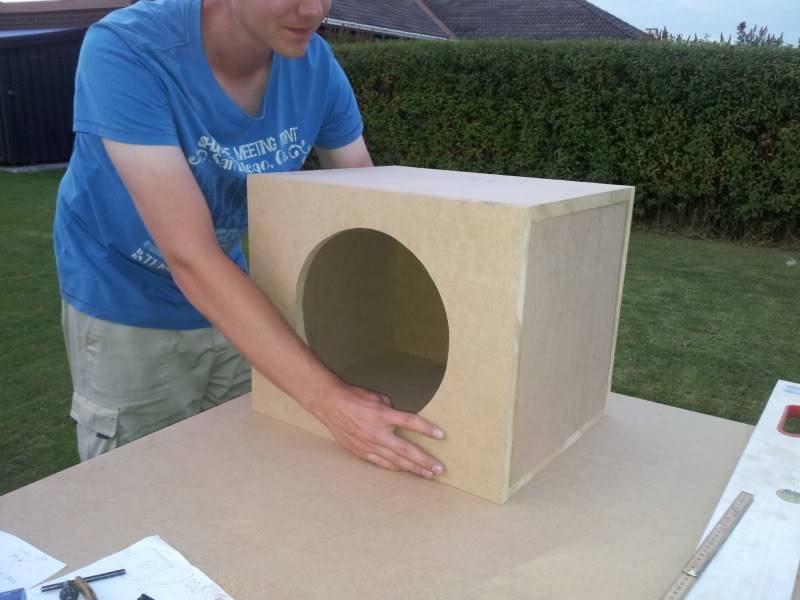

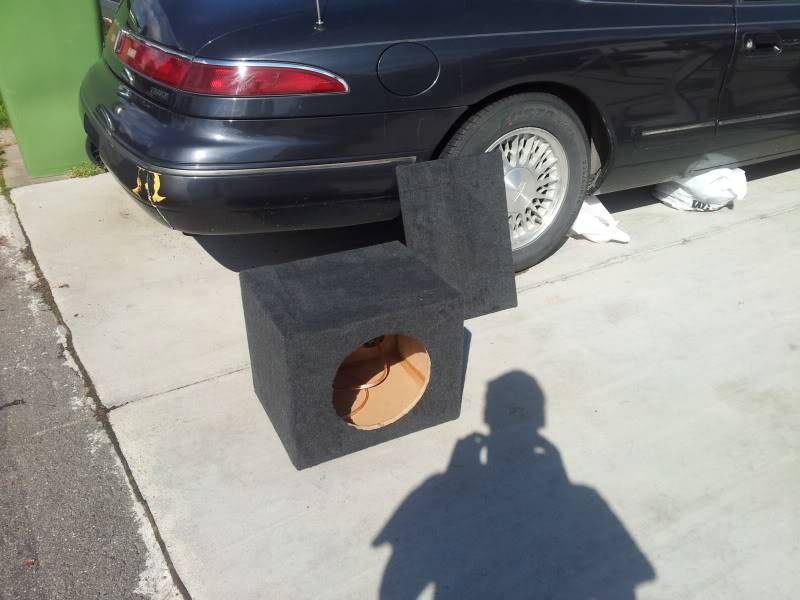

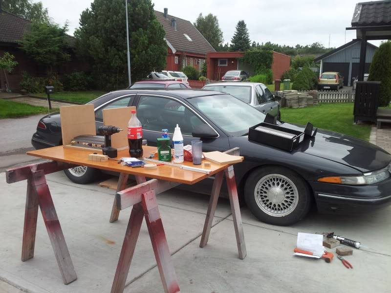

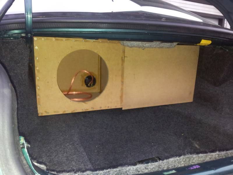

Bought some wood and started building the box!
I thought I bought 22mm but actually it was 19mm. And the woman in the counter even measured it saying it's 22m!!!
Damn women, can't get anything right. As useless on practical things as a cheese on rollerskates trying to fight grizzly bears.
Anyways, got the box together, sort of. Still need to glue and screw it ;) Only test fittings have been done.
Might do that tomorrow or on saturday.

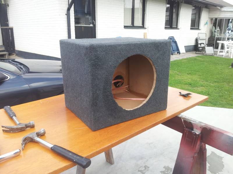

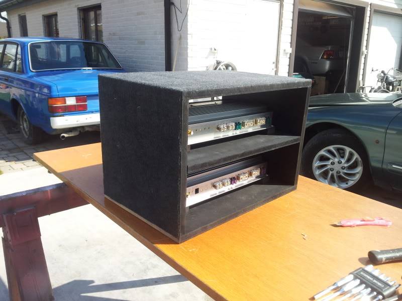

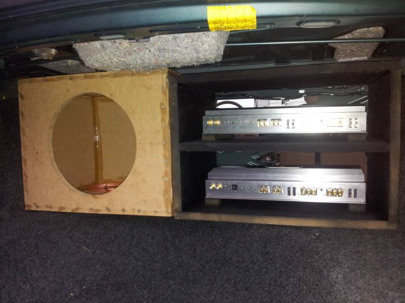

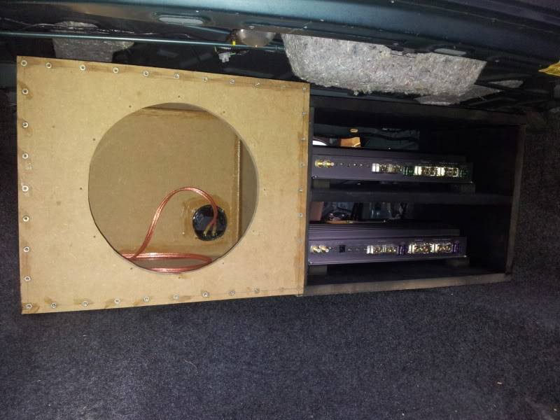

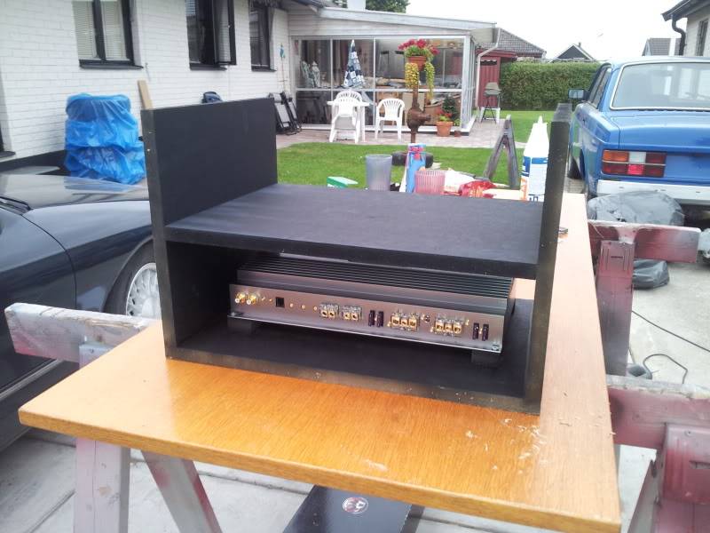

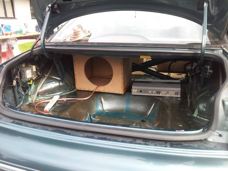

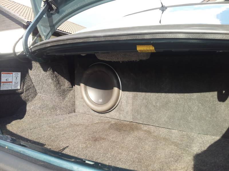

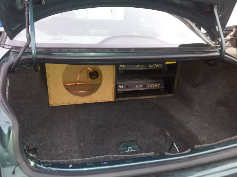

Finished the subwoofer box today and also the box for the amps.
It was a REALLY tight fit for this. If anyone wants measurements just ask me! ^^
Anyway, here's pictures

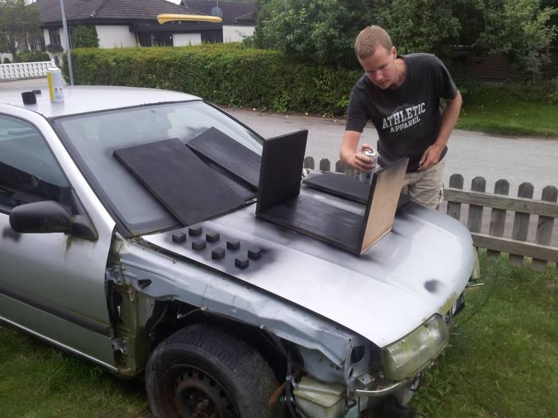

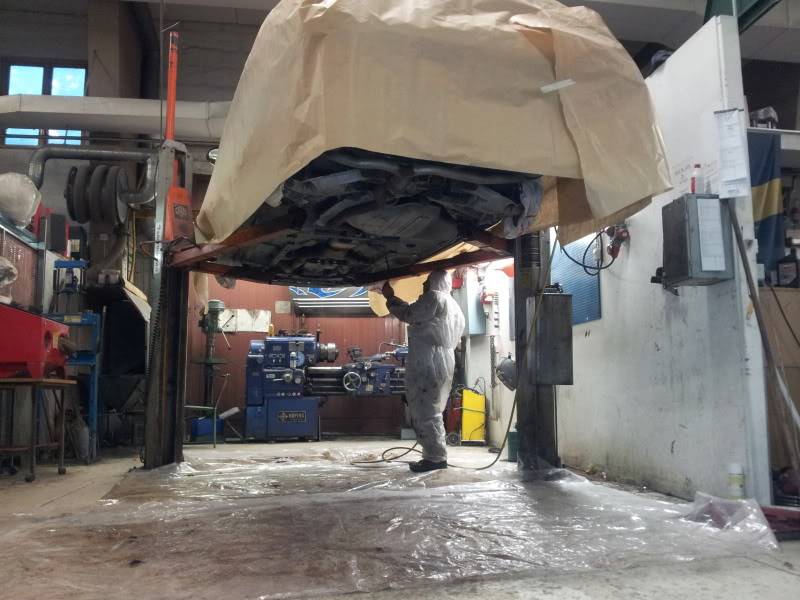

First from yesterday when we were rust proofing the car (is it called that? o.O)

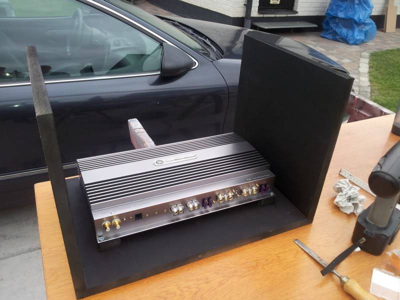

And here's with the box built and I'm measuring the amps
Building the box for the amps
An old Nissan can be used for more than just a house for the cat (yes, our cat loves to climb through the rust holes and sleep in there)
In the car
With the cover on
All of that will also be covered with a grey cloth.
I think this will end up looking great, all you'll see is the subwoofer.

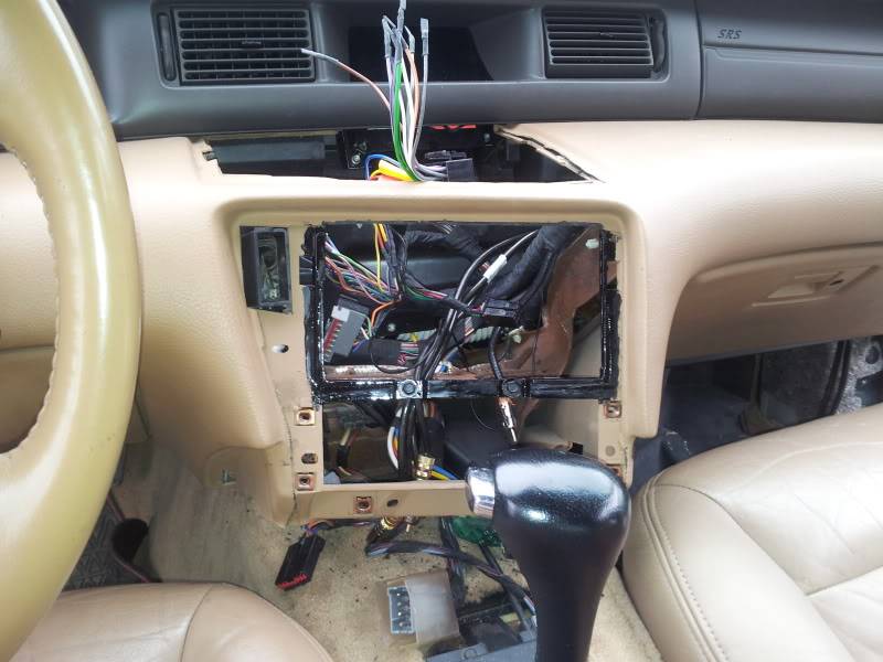

Added som black on the backside of the dash because I could see the interior color through to the empty spaces around the new stereo.

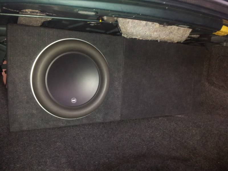

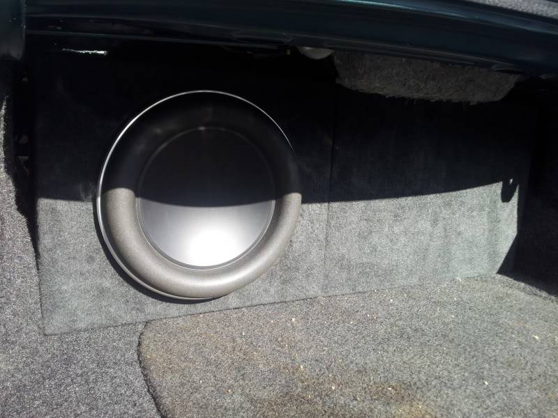

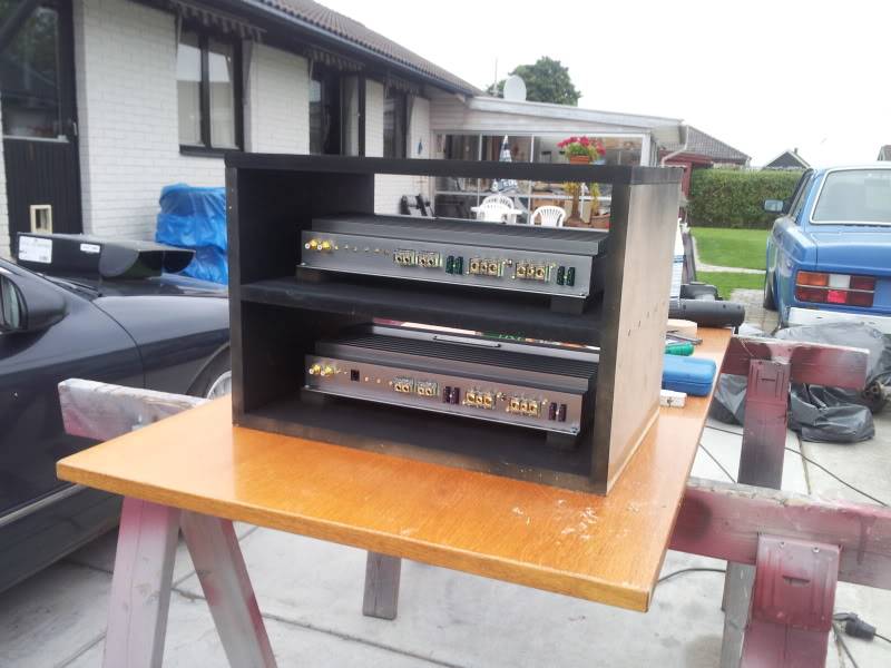

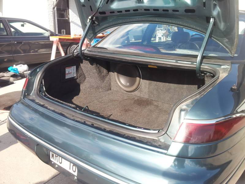

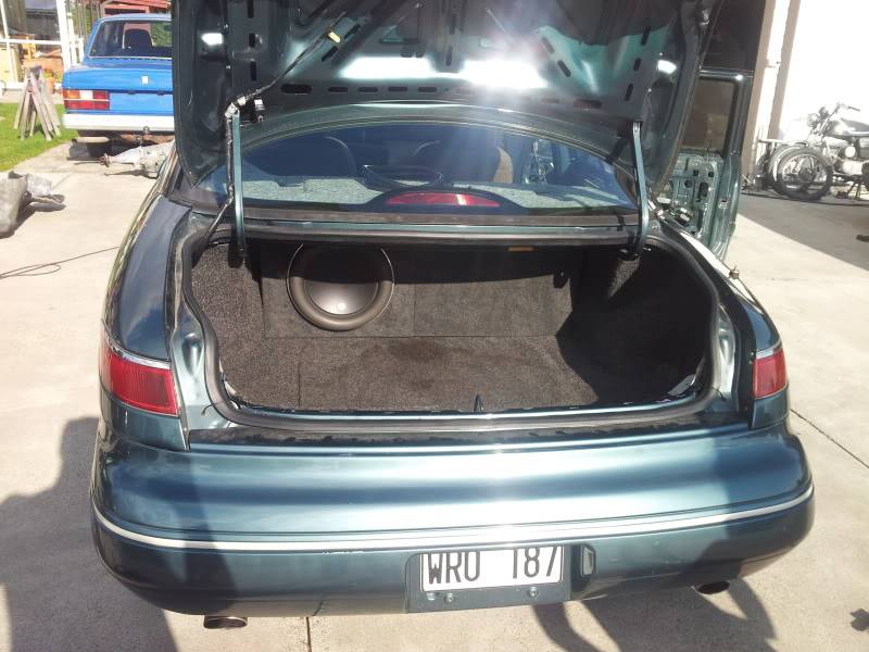

Got the boombox done
And the ampbox
The size of this thing is bigger than Wales!

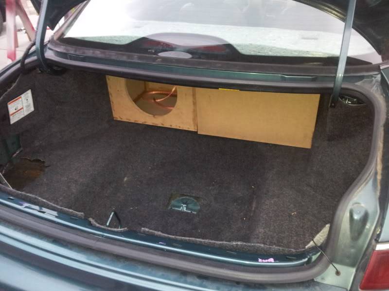

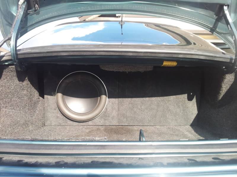

And it's in!
Sorry for the dirty spare wheel cover, mine is in storage so took it from the parts car

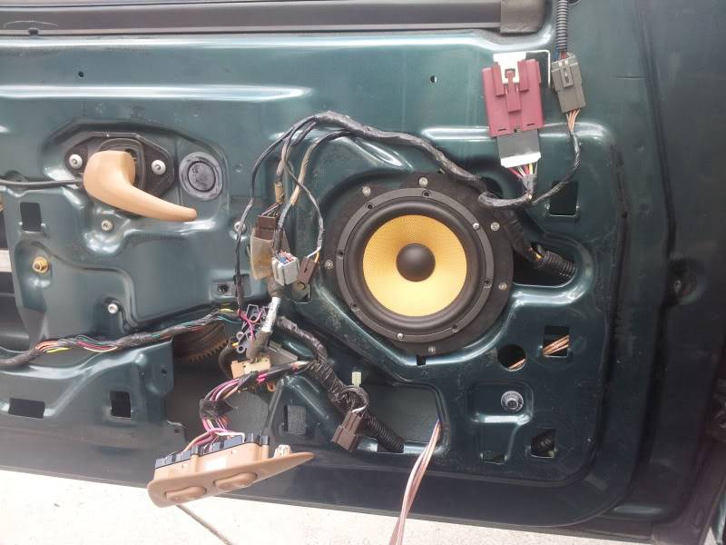

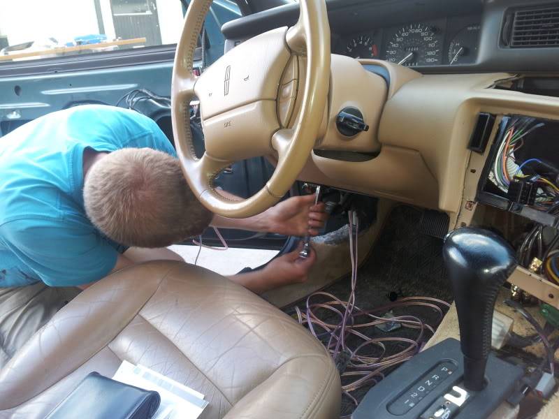

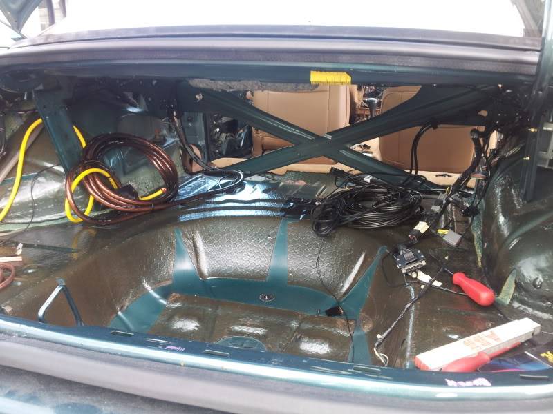

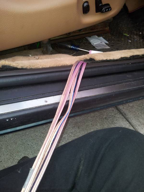

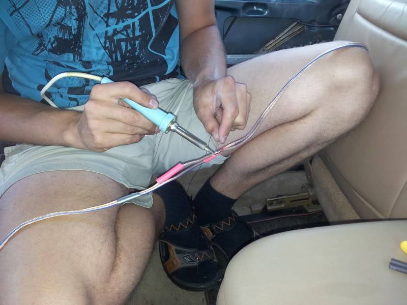

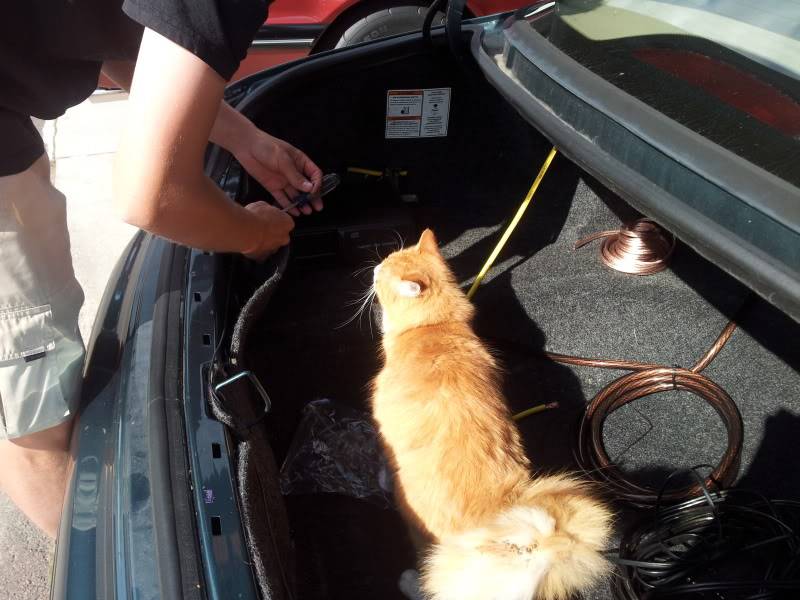

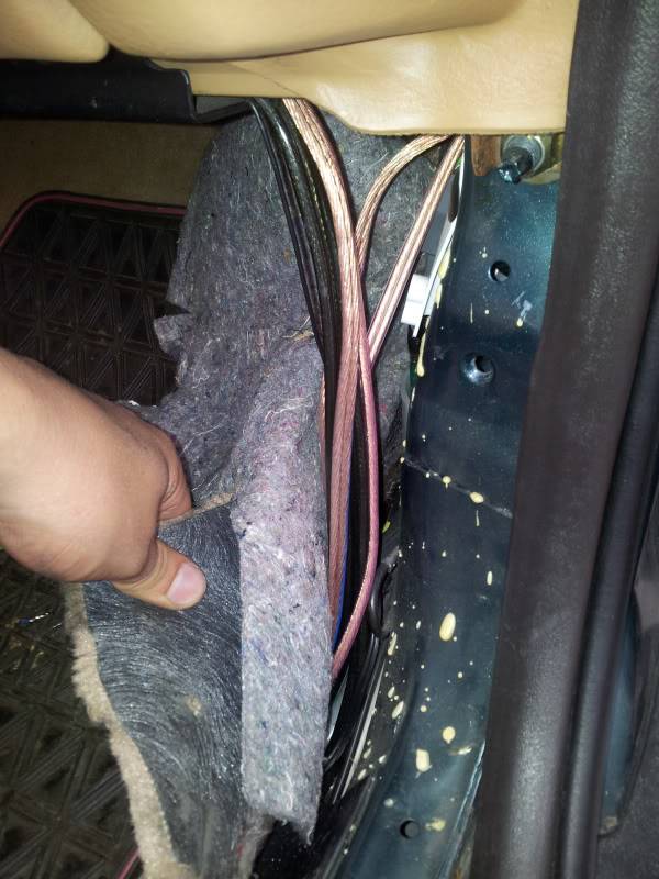

Time to get the wires out to the doors for the front kit
Look what I found under the shifter! Put it back in the same place again for future owners ;)

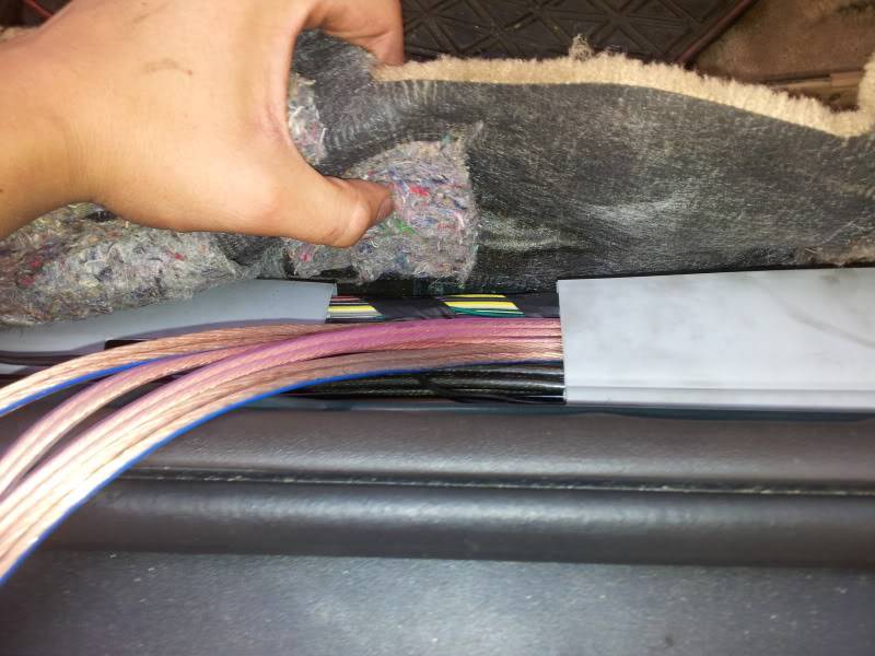

More wires
It was abit too short so we took care of that

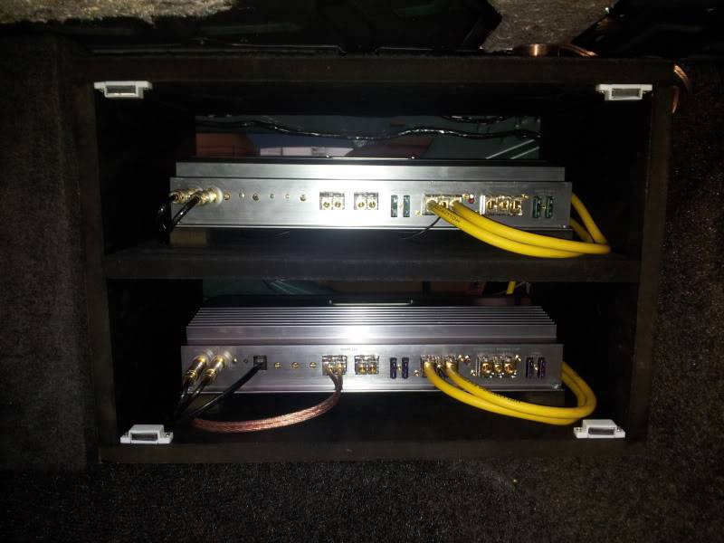

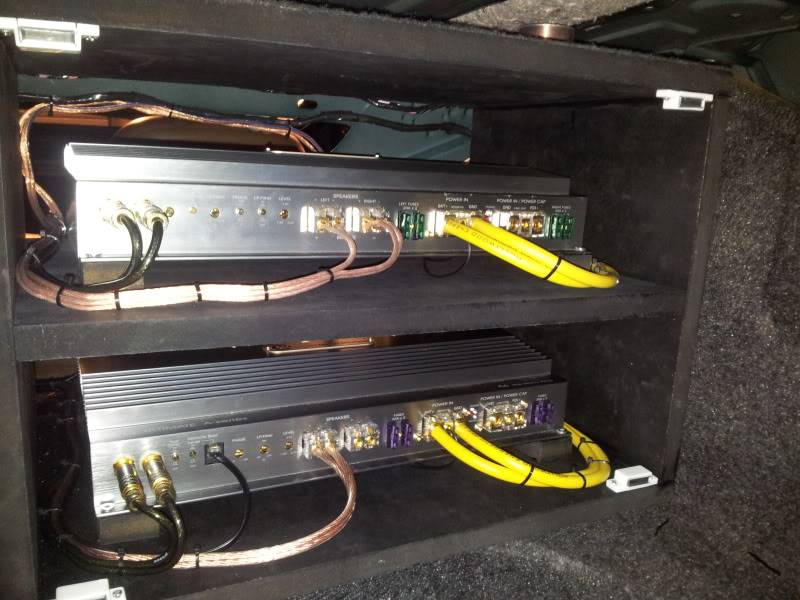

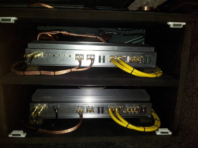

Amp box cover off
Cover on

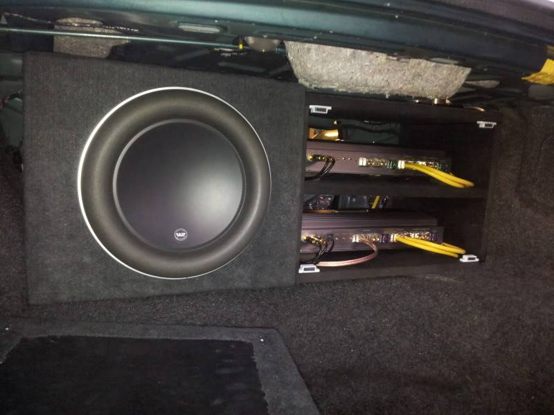

In pitch black on a late evening me and my friend mr flashlight made the amp wiring abit better looking with some tie wraps.

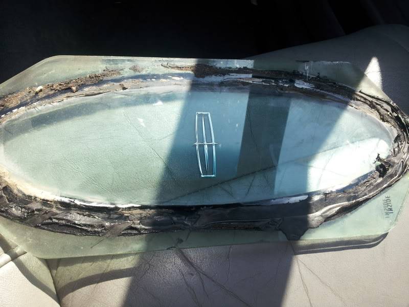

I took one out of a Mark 3 a while back, but it has a gold emblem in it. Finally found this one today. I think its a neat idea, and for $1.60, why not.

Kind of a shame to hide these beautiful elegant looking amps but it's a cleaner look with them hidden :D
What amps and sub(s) do you have? ;)
with the cover on , i know sweeden isnt as hot as florida, your not worried about heat? maybe a fan in the side of the box.its supposed to blow along the cooling fins for maximum effect. anything in a box or enclosed space without ventilation here in fl wont last long, but a great job for an experienced builder let alone your first try!
Love those DLS Ultimate A-series amps!
Those are probably a lot less expensive there than they are in the USA.
What a coincidence? Sapperfire and I have the same idea. Using an original Lincoln opera window for the amp rack. Mine has the chrome lincoln star though.
SwedishMark- Keep up the good work dude. Can't wait to see the finished product!
I am definetly abit worried about the temperature of the amps. Especially the A6 (the mono).
I've been thinking about fans and yes, I will put one or two fans in there but I'm gonna try it without first. The box will be open on the backside for more air.
If they get too hot I will put a fan in there.

97 Octane: They're gorgeous, the best looking amp I've seen so far in my opinion :)
I don't know if the prices are less in Sweden, we have insane taxes on everything. The A6 mono amp is 850 USD in Sweden and the A3 is 1030 USD.
They're not really cheap no matter how you think of it o.O
Thanks mate! :)
In my opinion you shouldn't wait. You will regret it. Buy a good fan & install it so that it keeps those amps cool. When amps are enclosed (even with one side open) they tend to get hot. Worth the extra cash to save an amp from getting ruined.

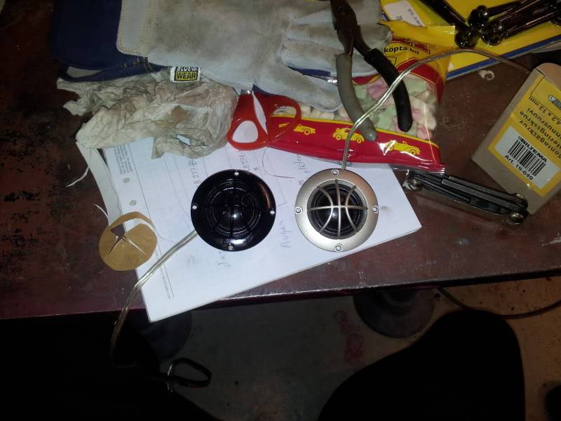

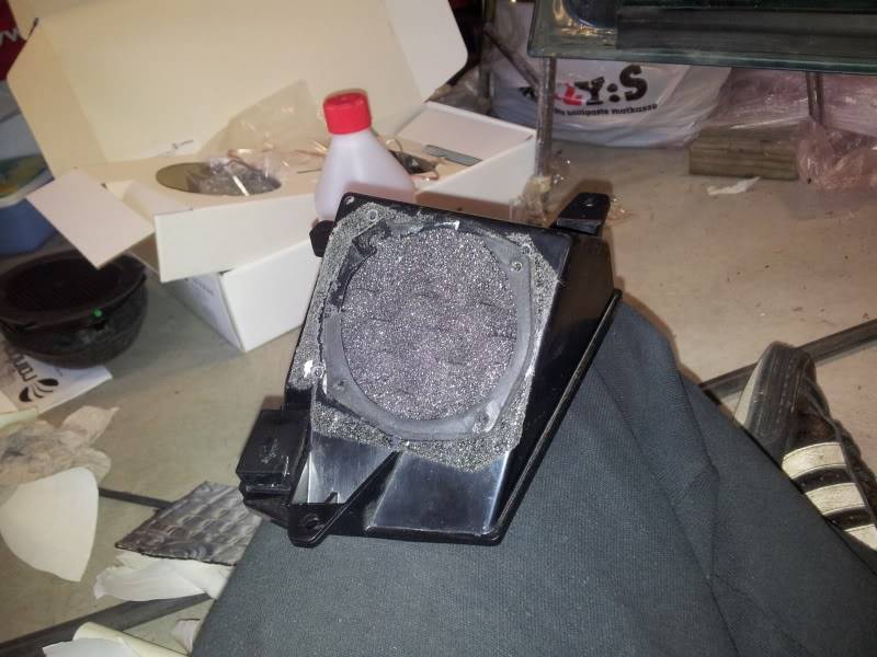

Decided to paint the tweeters black so they wont be seen through the tweeter mesh

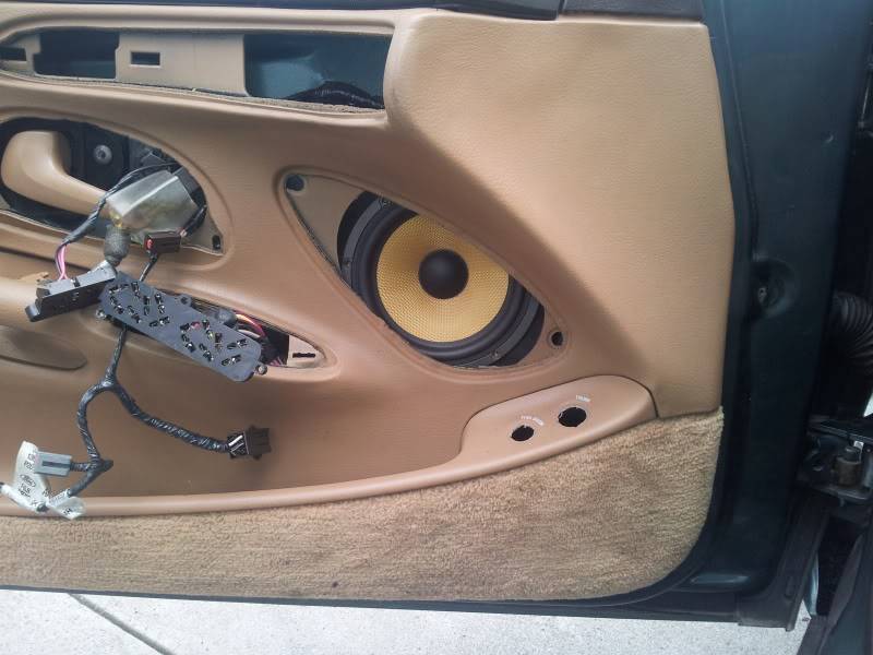

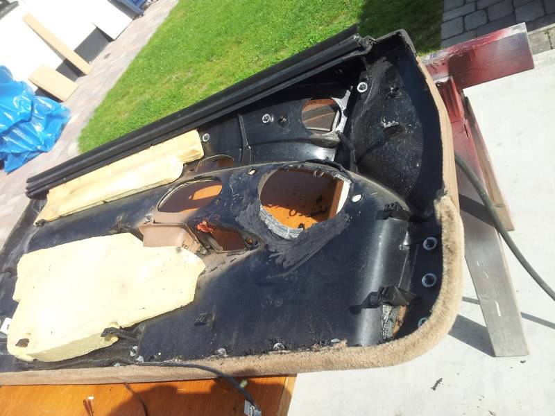

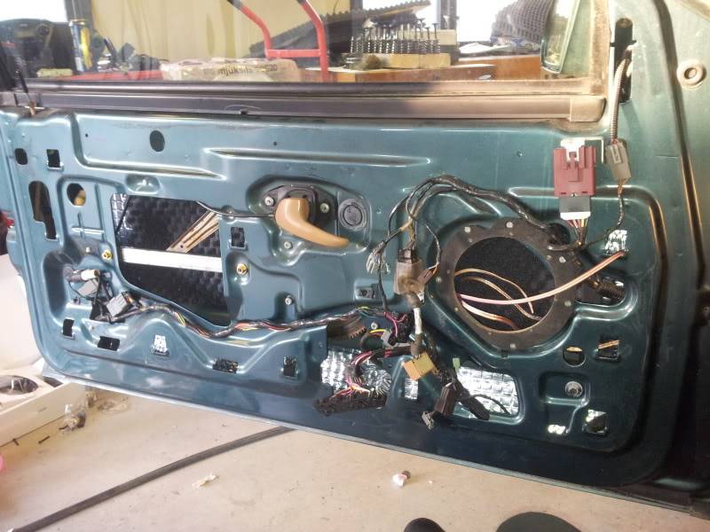

Had to do some massaging on the door panel. Those who say 6.5" is an easy fit they're wrong, really wrong! Atleast 6.5" this deep as mine are :rolleyes:
Test fit with door panel on

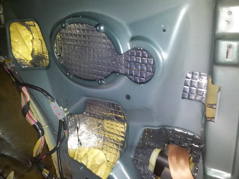

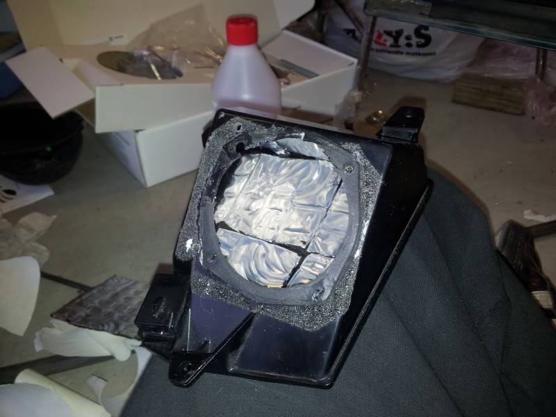

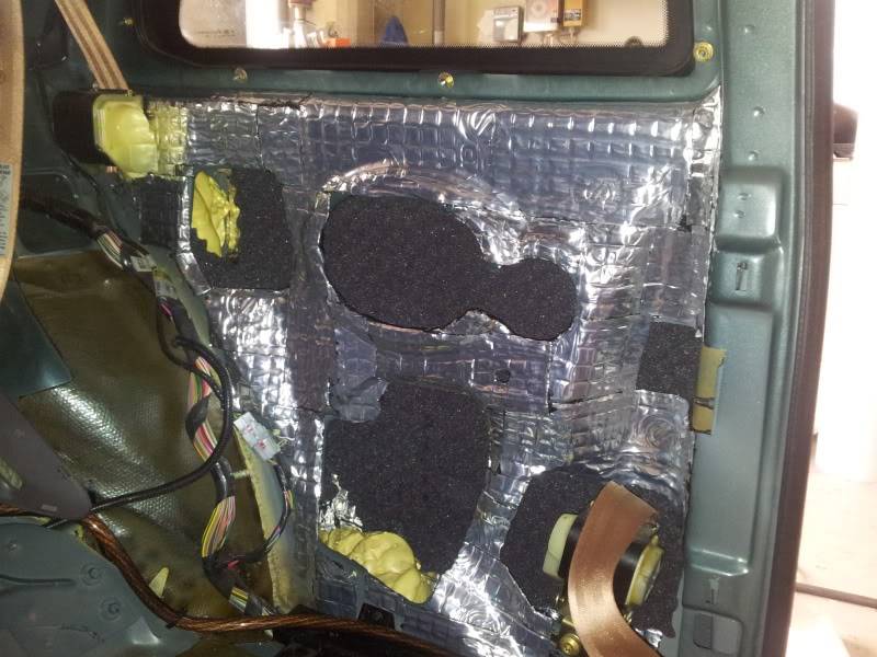

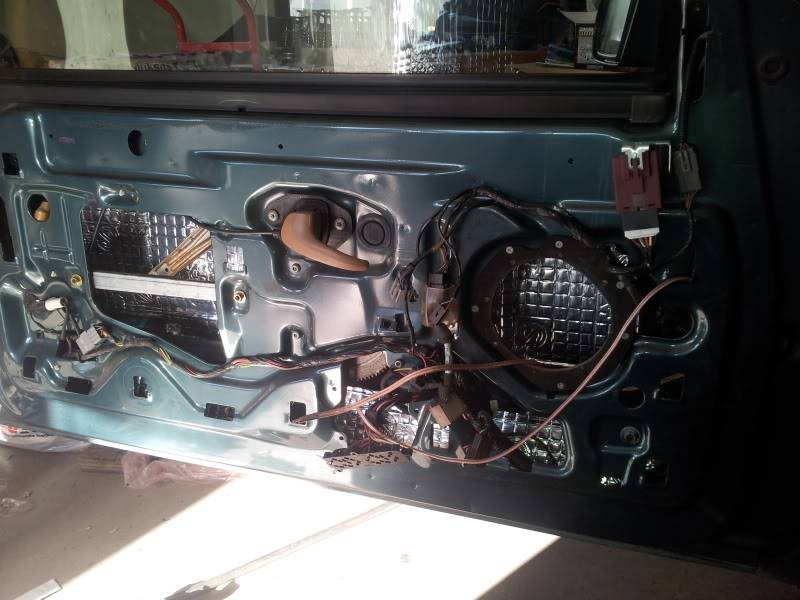

Then time to do some sound deadening on the doors! Used 3 layers total
And then thick foam on top of the 3 layers of sound deadening material
Worked some on the tweeter pods too. Don't know if this was much effort for nothing but atleast I'm 100% sure they will NOT make unwanted noises ;)
Filled with foam

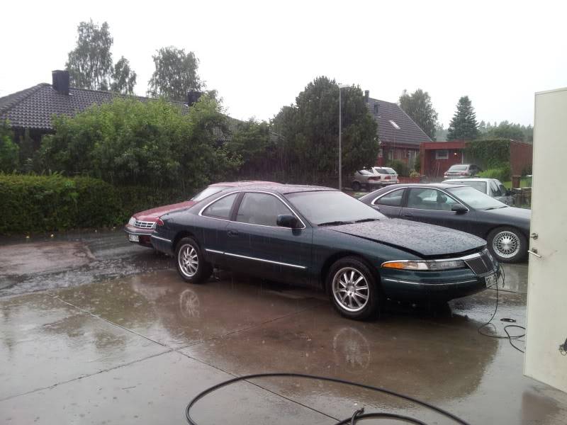

Typical Swedish weather...

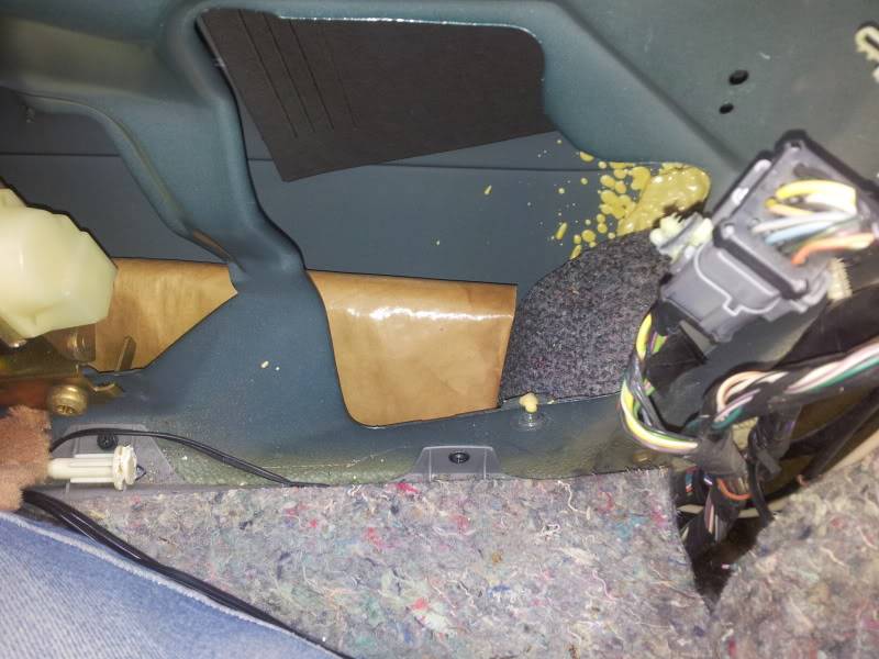

2 layers on the sides in the rearseat. I will not have any speakers here but I did some in there too
Foam in there too!

Doesn't look very much on pictures because all weekend I've been working on sound deadening the doors.
Very nice work mang. The sound deadening will make that thing whisper quiet.
I hope you didnt paint the cone of the tweeters?
I really hope it will! Definetly a big difference from just knocking on the doors :) And a whole different feel when closing the doors.
I might be stupid but not that stupid ;) No, just the surrounding area :)
