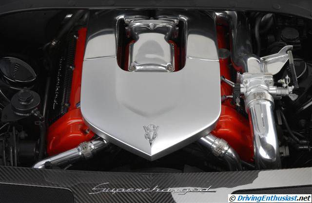

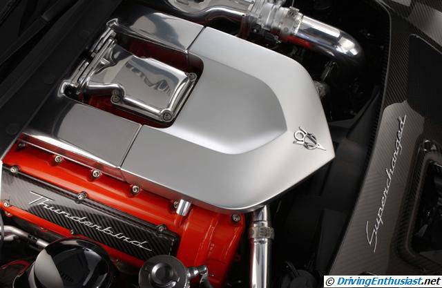

Folks: somebody needs to build one of these. This is the 2003 Supercharged Thunderbird Concept, which debuted at the 2003 Los Angeles show. It was planned to be built, but disappeared when little Billy Ford condemned all things Jacques Nasser and put an end to LS and Thunderbird development. Jacques drove one of these around for his official ride, and took one with him when he left.
Factory: 390 HP, 390 torque. Now you can build one too, thanks to Quik LS.
Here are more pictures, plus the press release: http://www.drivingenthusiast.net/sec-blog/?p=7383
That's one thing the LS could use - better appearance under the hood. I'd like to see somebody ditch the cover, paint the intake silver (aluminum-look), and the valve covers red. It doesn't need (and shouldn't get) any chrome, it should be understated like the car but draw interest to the engine.
