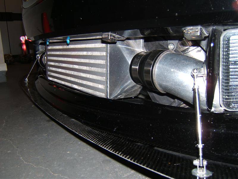

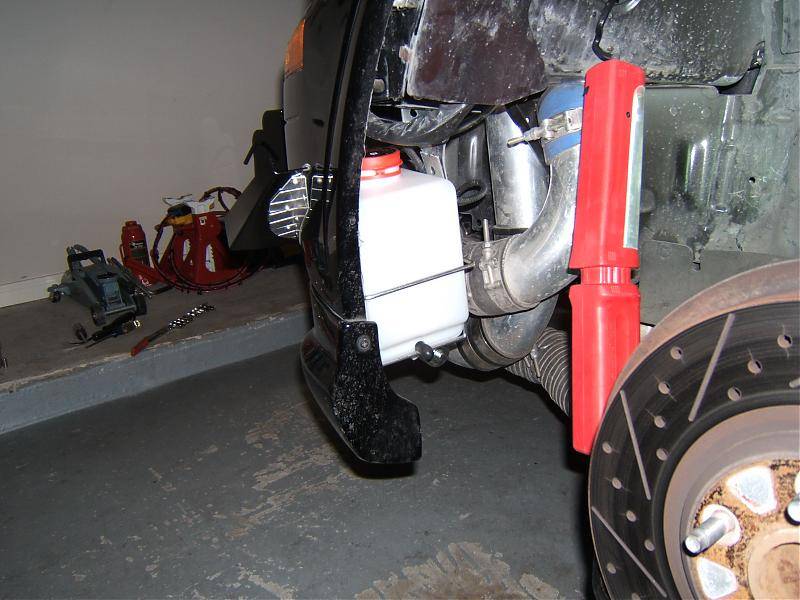

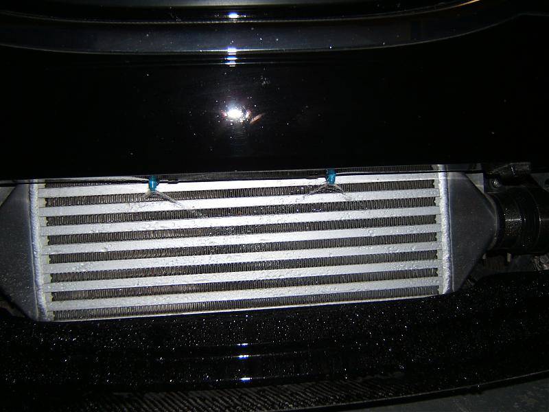

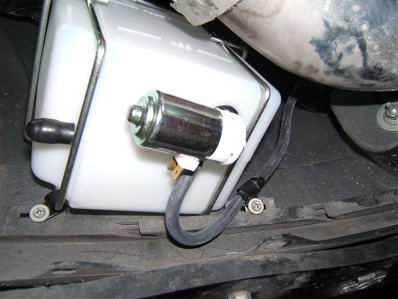

Second - I added a intercooler sprayer.
took a coolant tank, added a washer pump. Sprays through some hose out through some 'pot misters' from Home Depot. I trigger it through a relay and a push button from a WRX STI. I added a checkvalve to prevent the water from draining since washer pumps rely on gravity to prevent draining.
