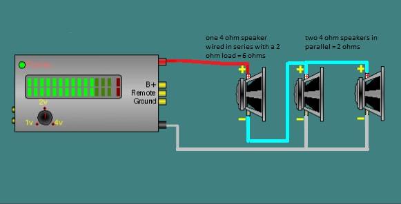

And one of the subs will not get pounded harder? If not, can you show a pic of that connection? I'm all for more power to gain back what I lost in series but I want all 3 to get equal treatment.
No, the amp sees the subs as a single load, it doesn't matter what your configuration is, they all get the same amount of power. Here is a quick drawing to illustrate the series parallel config.

I saved that pic to print out. I might get out in the garage again and bring it down another 6 ohms. This just keeps getting more and more confusing. I'll most likely leave it like it is for now until next week. I ordered all the new wiring last night and finished ordering the rest this morning. Moving the amps and the bridge in between them isn't very easy, especially when it comes to lining them back up again. When I get all the wiring and connectors and w/e else I ordered, I'll get it all straight. Up until now, the ohm law has always had me confused but now I understand it. Wished I has understood it when I was 18 lol.

Thank you!!! I knew there was a way and for some reason I just could not for the life of me remember how to do it that way! I told him a different way then realized it was wrong so I told him to series it, Like that then the amp will give close to its 4ohm rating.
Man I feel dumb for not remembering that. My bad.

It's all good, I've been a car audio fanatic for 10+ years now and I still forget from time to time. There is a lot that goes into a good design and quite a few things to remember. Having an electronics background helps when working with wiring speakers and calculating loads and outputs. It never hurts to ask around, I still call my installer, a buddy of mine, from time to time to ask simple questions.
How much more power am I expecting to gain going from 12 ohm to 6 ohm? I'm going to do it either way when everything gets here, hopefully by Thursday or Friday. I was wired at 4 ohm when I had the three 12 ohm subs in so only a 2 ohm loss should put me extremely close to where I was. Also, these subs aren't tired like the ones I took out. Nice and tight with a bigger foam surround.

Laser, me and you kinda have the same home life and I know how that is. Sometimes it's mind disturbing so it's understandable that something like that could slip past you. It never even entered my mind that there was another way so don't even sweat it. I'm just glad to know I can come down another 6 ohms.

I agree, same goes for the subs I bought. If I would have done research first, I would have gotten three 12 ohm and not 4 ohm. Now that I have another wiring option, I'm only going to be losing 2 ohms from the amp. That should be just right for the amp I have and the subs also.
