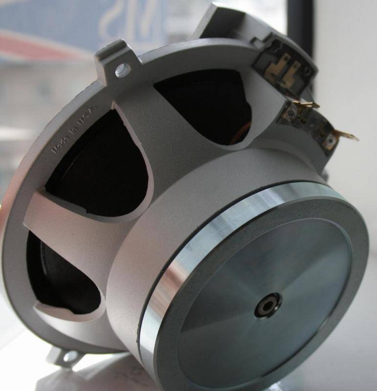

I would be willing to bet that a single Boston spg555 will be louder then a BTL 15 (SPL sub) yet cleaner then a Q 12 from them. Yes, the FI looks like a quality product and has decient specs but its just decient. The Fs is nice and fairly low but the system Q is too low. They will sound muddy on fast drum music. Even bass drums will be more of a loud thud then a sharp impact. No doubt the Boston will sound better then FIs Q series (their SQ sub).
It is an expensive sub but its the best sub out there short of a top end Focal but still louder then any Focal could do. I had a hard time selling them cause they were as much as a W7 or T1 and everyone was familiar with Rockford and JL but when I did sell one the customer was always blown away by them. If I was doing a deck upgrade on another customers car that I had already installed a couple W6 12's in and also just finished a spg555 install I would show them and they always say "Wow, wish I would have gotten that instead." 100% of the time.
IDK the OP was willing to spend that kind of coin. The spg555 would have been the only sub I would have reccomended.
I bet after he installs it he will post "Its almost too loud but damn it sounds good." ;)
Another plus, the spg555 will never wear out. You burn it up and its only 6 screwes to replace the coil. You wear out the cone or surround and it bolts right in, no glue or mess.

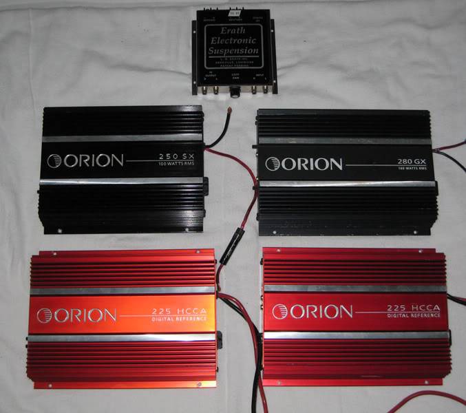

Gawd I miss the old red Orion HCCA amps from back in the day.

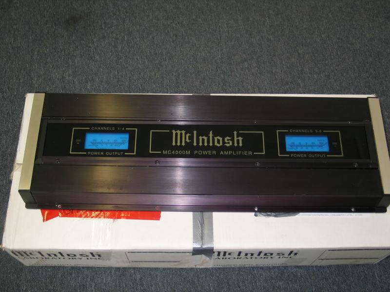

If you have the money buy a McIntosh amp.

Laser, remember these?
Yup. I never heard a NT in a car though, only in a sound board. :(
But I mean the OLD HCCA's

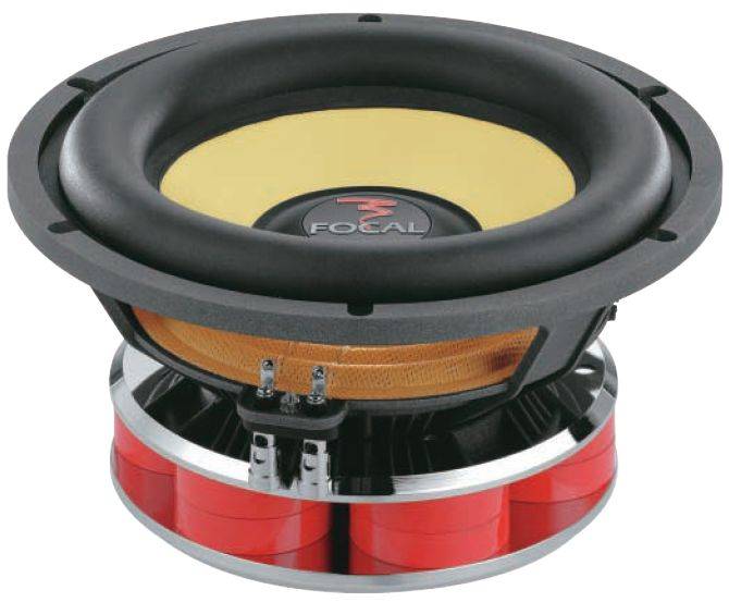

My dream system in my Mark of components I could get would be a Pioneer AVIC-Z3 hooked to a McIntosh MC 4000 and a pair of Focal 27KX subs, Dynaudio 3" soft dome mids in the factory tweeter location, Infinity Kappa EMIT Ribbon tweeter laying sideways behind the factory grill next to the mid and some Boston Acoustics Z6 midbass speakers in the stock locations.
It would be my masterpiece, the sound would bring a tear to anyones eye with the right song.

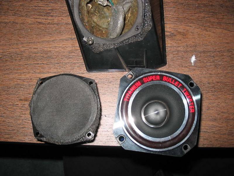

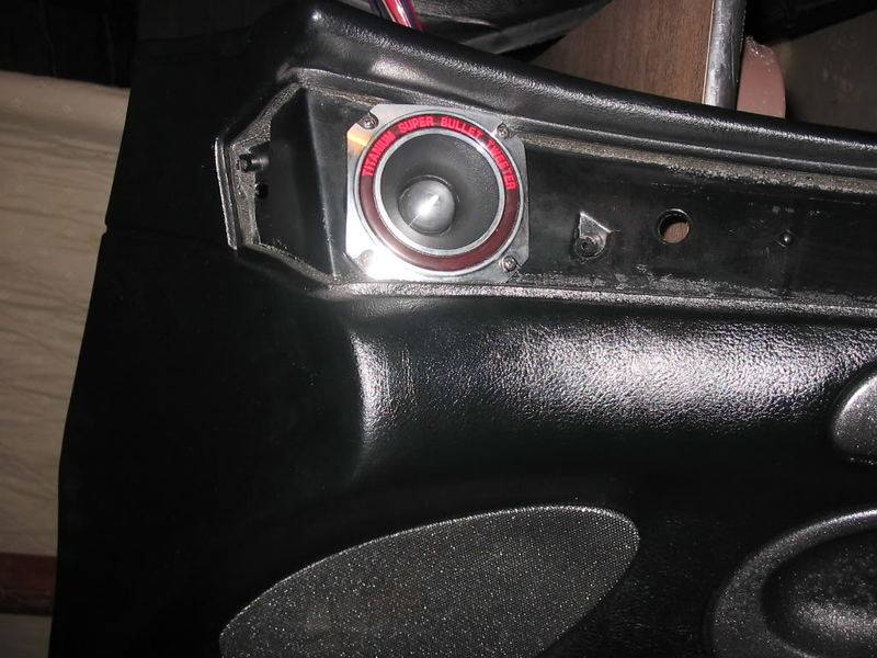

This is not the tweeter but close. I cant find a picture of the Kappa Ribbon that they made but I know a place that has a new set in the box I am gonna buy anyway. Gotta see if he will still let me have them for $200 :D
The car version is just the rectangle piece in a plastic case.

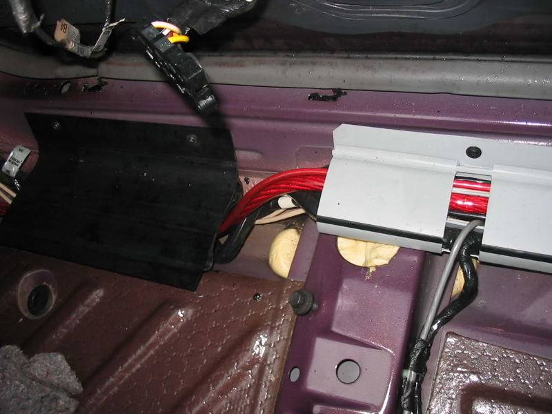

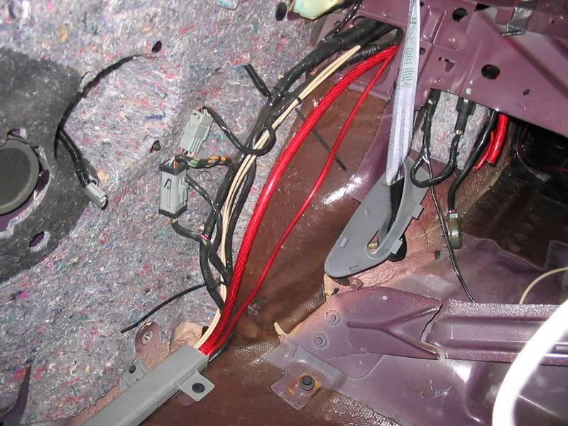

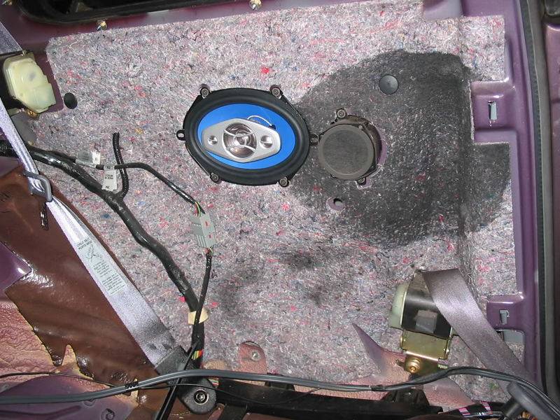

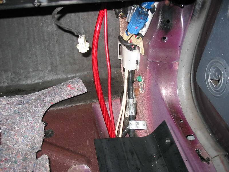

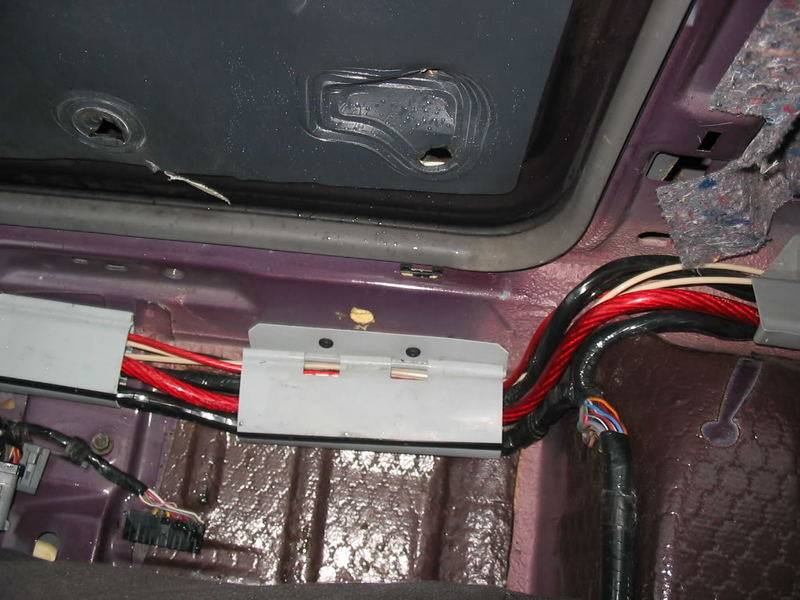

here is current progress of the stereo. ive got 0g and 8g ( 8g already in car ) power wire ran. the 0g for sub (obviously) and 8g for a lil 4 channel. Ive got the menace super bullet titanium tweeters and menace tri's. And im looovin the way the wiring ended up. just another step closer!! And when lookin in the pics its the red wire (uh dir)
You do nice clean work!
Its funny, I see mpre and more cars wired with dual power cables these days. Used to be we would take that 0 gauge wire and run it to a distribution block and then feed the amps.
That wire is thick enough to support 5000+ watts. :D
What are the light tan or off white wires? Are they the speaker wires? I always try to run them on the opposite side of the car.
A few years back Mostor made this flat speaker wire that ... I forget what was so special about the materials but damn if it didnt make high freequencies sound better. Ill try and figure out what kind it was.
Its a damn shame the rear speakers are such a PITA to replace. I have new Boston SX's to go back there but was too lazy to remove the seat and pannels to get to them. I guess as soon as my Xtant is sold I will get back there and replace them for the new five channel.
BTW, you also want to run an additional 0 awg ground wire from the battery to the frame and adding a couple 4 awg wires from the engine block to the frame would also help. I was noticing a minor high pitch RPM dependant whine when I muted my system after pounding it for a long time as my Xtant pulls 100 amps like nothing. The charging system was getting bottlenecked at the ground locations and after adding two more grounds it cleaned it up and now I dont get that minor (yet bothersome) dome light flicker if I tap the brakes at night with the door opening when the car is at idle. :)

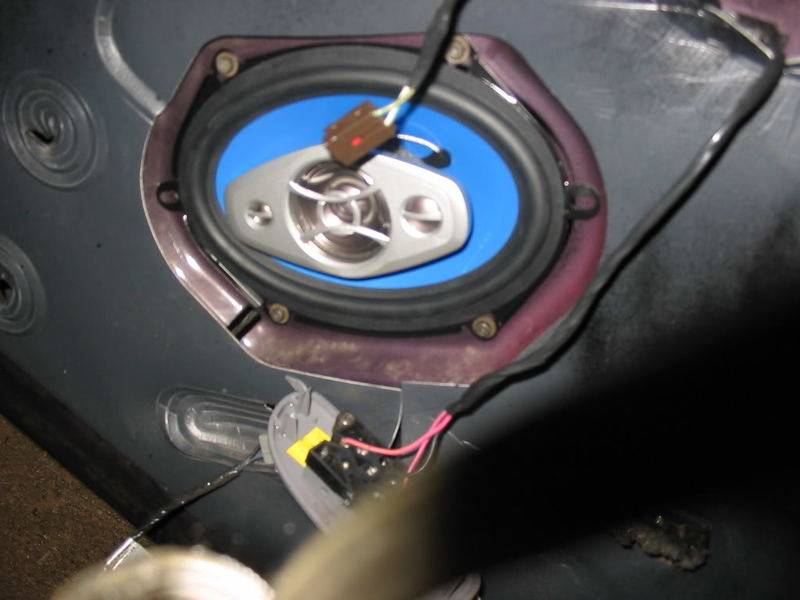

Laser, the Gen 1 rear speakers couldn't be more easier to swap out because the grille to them just pops right out, giving you access to both speakers behind it. I'm sure he just has his seat out because he was running the 0 gauge wire. I agree about the distribution block running off the 0 gauge and then disperse from there.

Yeah, the Gen1. I have the Gen2 and my grills dont pop off... well they could but they are the same kind of folded metal tabs like the front tweeters so I would have to pull the pannel to re-seat them. :(
i honestly have not a clue what those wires are (tannish ones) the are unfamiliar to be from previous times.I was going to run a dist block but since the 8g was (carelessly) installed i figured i would take advantage of free wire. I have always been against caps (beleive in high amp alt) but as always thats prolly gonna change and i will run one.Due to the lack of being able to find higher amp alts for the mark. Its crazy how expensive they are too (caps)

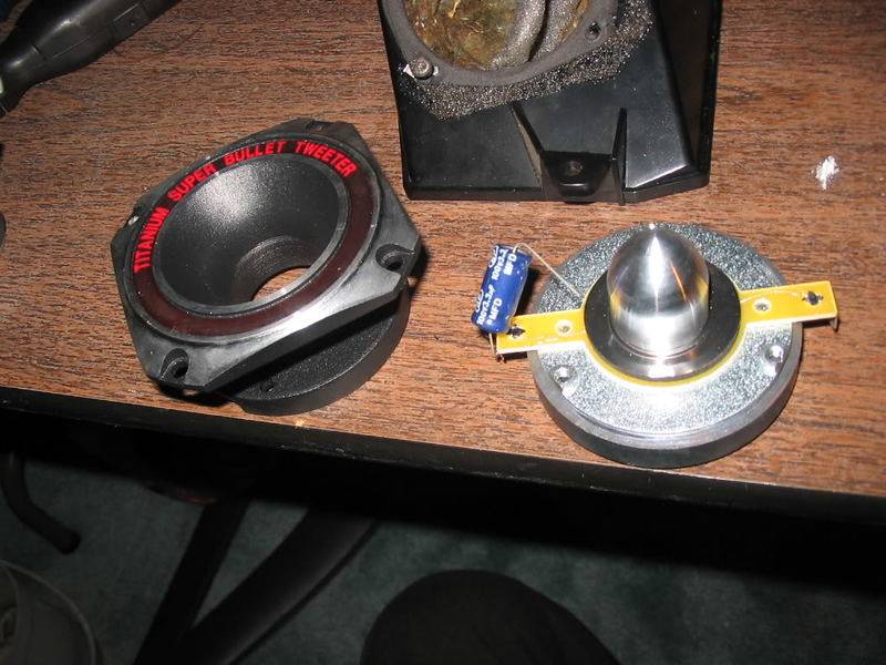

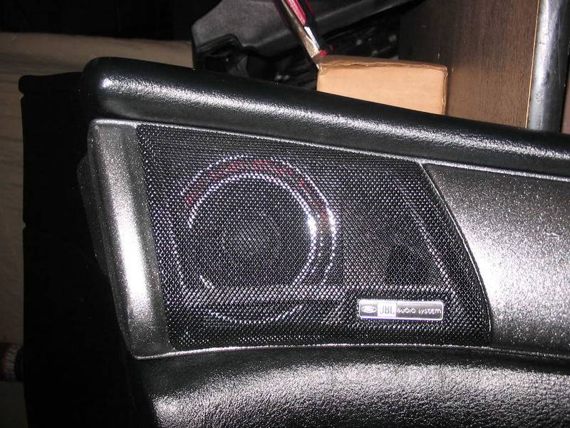

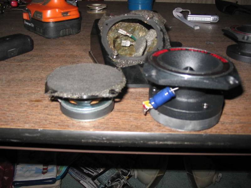

oh no no no lol its ported, check the pic and look to the bottom right, its a triangle like port. im tearin into her again today and prolly gonna do some hackin to make the pressure in the cabin greater. also goin to experiment to see if fold down seats are gonna happen or not
