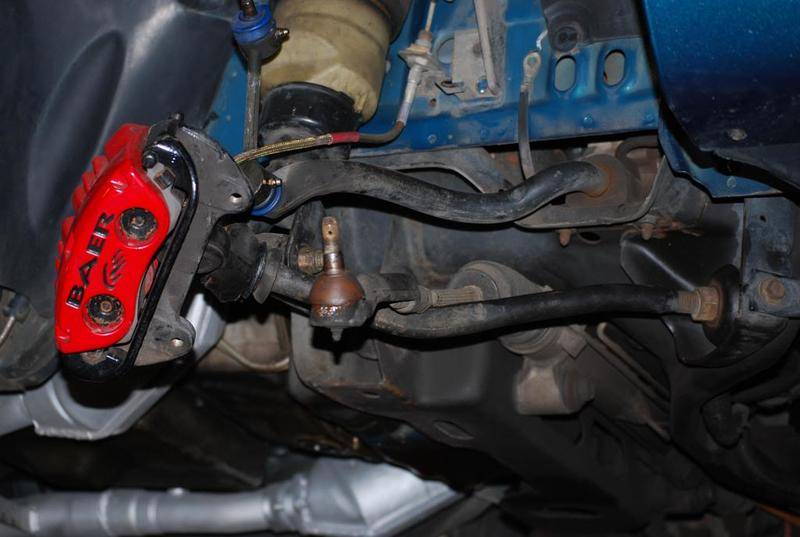

Pic 3...LCA ball joint. (no knocking but a badly rotted boot, so it need's changed).

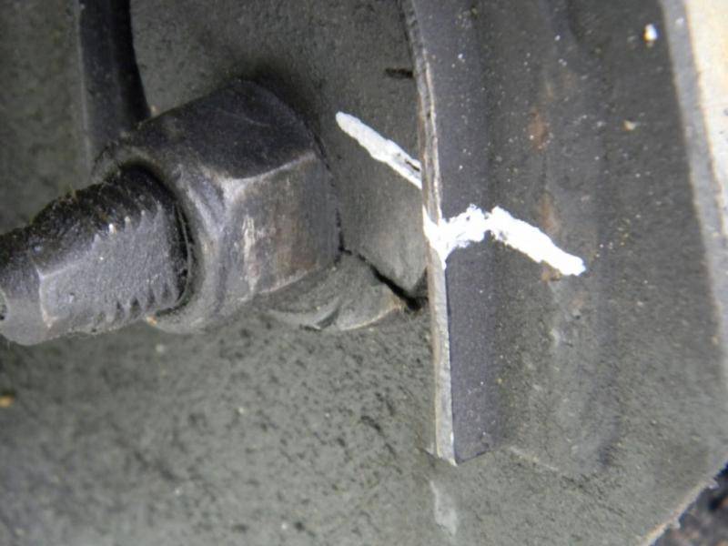

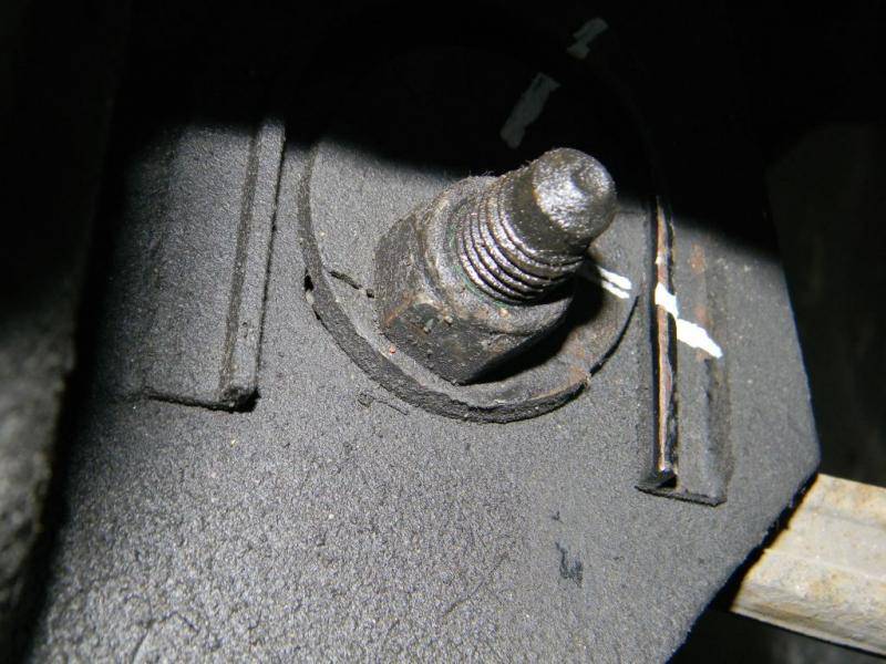

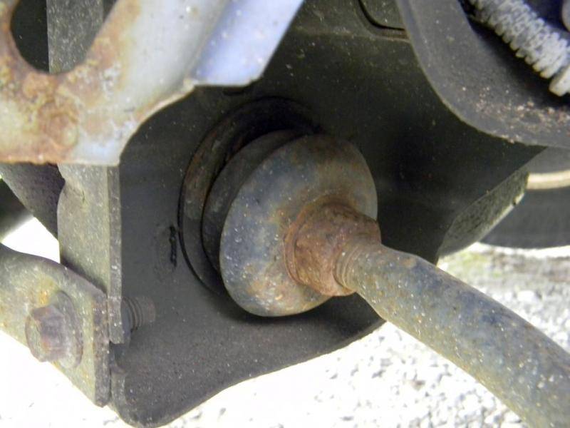

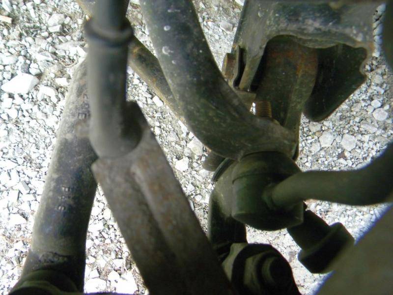

Pic 4,5 and 6...SRB's. (to the frame don't look bad at all. To the lower control arm's I hear a knock when I turn it all the way to the right or left). I bought all new bushing's so they all get changed! Can't wait to see if those "home made" spacer's work!
Pic 7...metric crescent wrench to hold strut rod flat as suggested!...:)

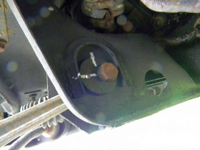

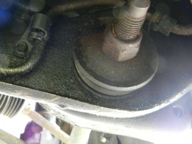

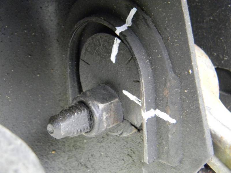

Pic 8,9 and 10...camber adjustment bolt and nut (marked).
Doe's it look like my Camber Adjustment on the front (the nut) side is broke???
Will this be a problem? Should I get a new set?
Dealer can't get one...AZ can't get one...O'reilly's can't get one. My only choice is rock auto, another week away since I'm only able to work on this on the weekend.

I would replace it. You can probably get by reusing it until you get the new one, but definitely replace it before the alignment.
You can tell why it broke by looking at the flat side of the threaded portion of the bolt. That should be pointing to the thickest portion of the cam washer.
By the way, did you try Advance? I think I may seem them available there. Could be wrong though. Also, it's the same for the Thunderbirds. You could try the junkyards too. If you have a pull-a-part type yard around you, it would probably even be free...
I think they over tightened it back in 94 (probably been that way ever since). Let me take a pic of the oppisite side of the same adjuster and I'll call Advanced at the same time.
Sorry for the dirtiness but everything has been soaking in PB Blaster for the last week.
It look's like it's broke all the way through! I have a feeling if I take it apart if will fall apart in my hand's, and the alignment shop still has to do whatever they do to it also.
I probably should get another set for both sides shouldn't I???
Just called Advanced Auto and they said It is an order item, but at least it's closer than a week away at $22 per side. They said they can get one here tomorrow by 8am and the other Sunday.
There 20 miles away but at least this project look's like it will be going forward this week end! :) and not waiting another frick'n week!
