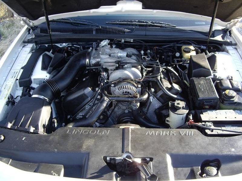

Im looking at LASERS engine photo.. and one thing is coming to mind when I look at the drivers side valve cover - How the FUGG do these things come off?!?!?
I dont want to mess with the brake cylinder.. so please oh please someone help me :(

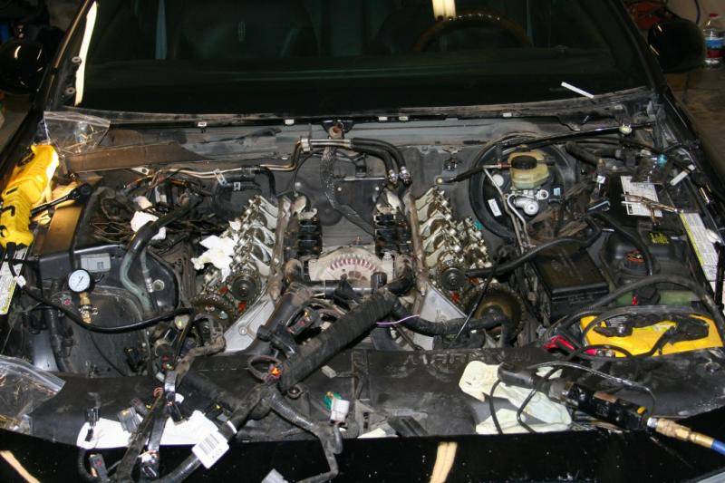

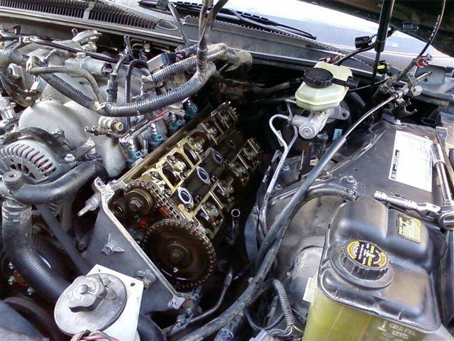

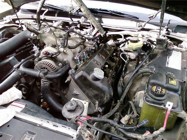

why do you think i said good luck!!!! derek was gonna do the same thing to his that you are trying, and i had to put another motor in his car, then we found out the motor was junk, so i had to take it back out and put his original motor back in, after i refurbed a head i had and replaced the driverside head on his original motor. if you already have doubts, just stop, you'll break stuff before you manage to get it off.
dont follow the cobra walkthrough...........
remove everything i removed, loosen oil dipstick, jack up engine a bit......pull valve cover.........
it just takes time.....

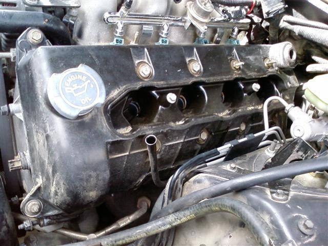

Your reasoning was the same I used. DON'T DO IT, BE WARNED! It's ok to just change one side. The Pass side is easier than the Driver side but it is not easy by a long shot. The only reason I think the pass side even worked for me is because my mount was shot, so when I jacked up that side of the motor it lifted a few inches by itself. So you may not have luck on either end.
Regardless it's not something to tackle as easy as it may seem. The difficulty isn't in removing the bolts, the difficulty is the valve cover doesn't clear the master cylinder and some other crap on the rear part of the valve cover closest to the master cylinder.
When you get it all unbolted it is so close to coming right off it looks like you can pull it out. Others said in older threads just use brute force (and they were serious it wasn't said in a sarcastic or joking manner). So I tugged. I'm not a puss, I can shrug 465lbs so the motion of pulling upwards is my strong point. I pulled so f'ing hard I literally pulled my leg into the ds quarter panel and made a gigantic dent simply by yanking on the cover. YOU WILL NOT GET IT OFF WITHOUT REMOVING THE MASS CYLINDER OR DROPPING THE MOTOR MOUNT.
Hate to argue, but... it's possible to do without doing either. Note what has been taken off the master cylinder.

And if you didn't notice from the pic, just remove the brake lines from the master, then all you have to do is bleed the brakes after you put everything back together...if you can take a shower by yourself, you have the mental and physical ability to bleed brakes

If you unbolt the master you can just move it over a little and have no fluid loss at all. Frog had removed his lines into the master and I assume plugged them. But if you have never done that before then you will prolly lose all the fluid.

you can remove the master from the booster as Laser said , just don't move the push rod sticking out of the booster, it's a screw in setting preset by the factory for throw distance in the Master...
