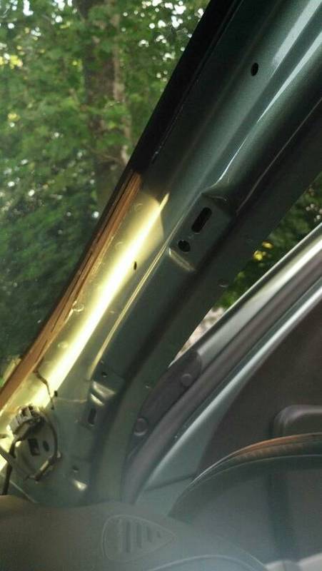

If the moon-roof tubes have become too short to re-connect to the drain, it's probably because they have shrank. They may be able to be stretched enough to re-connect but you should wrap them very tightly with multiple layers of electrical tape or duct tape.
I was looking for more pics and/or a guide to this, are there any on here that you might recommend?
I'm going to be tackling this this weekend or next. When I do it ill take thorough pics for you but I think it's pretty straight forward.
Sent from my DROID BIONIC using Tapatalk 2
no hose. So where is the water coming from

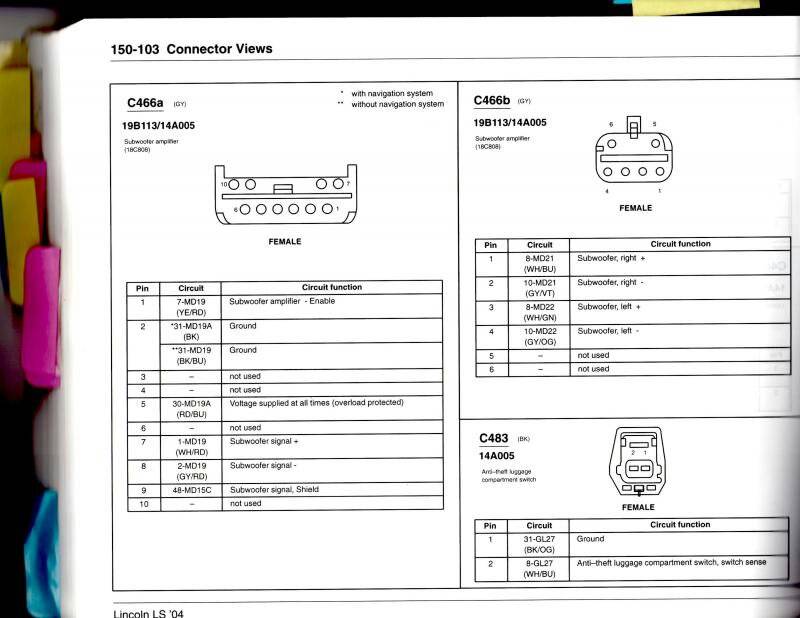

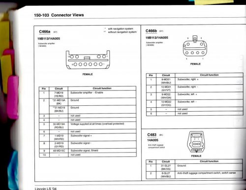

also for addition to the thread:
For the AUDIO setups with the SUB in the rear deck, there is a harness that supplies the left and right sub (low input that can be tied into RCA pigtails for low amp input) and a remote amp turn-on that can be used for trunk "box" setups. that way you dont have to tie into the fuel pump power for a switched input. (the harness has a yellow wire on the end #9 that is remote turn on from the deck.)
The great part is that even the cars that have the "factory sub delete" (for weight reduction purposes they say) still have this same harness.
-This is for the GenI Alpine 6 disc with or without rear deck subs-
...For the AUDIO setups with the SUB in the rear deck, there is a harness that supplies the left and right sub (low input that can be tied into RCA pigtails for low amp input) ...
Please note for clarity, the factory harness supplies a mono (single channel) only signal to the factory amp location in the trunk. The factory amp drives two speakers, but they are both from a single channel, not stereo.
