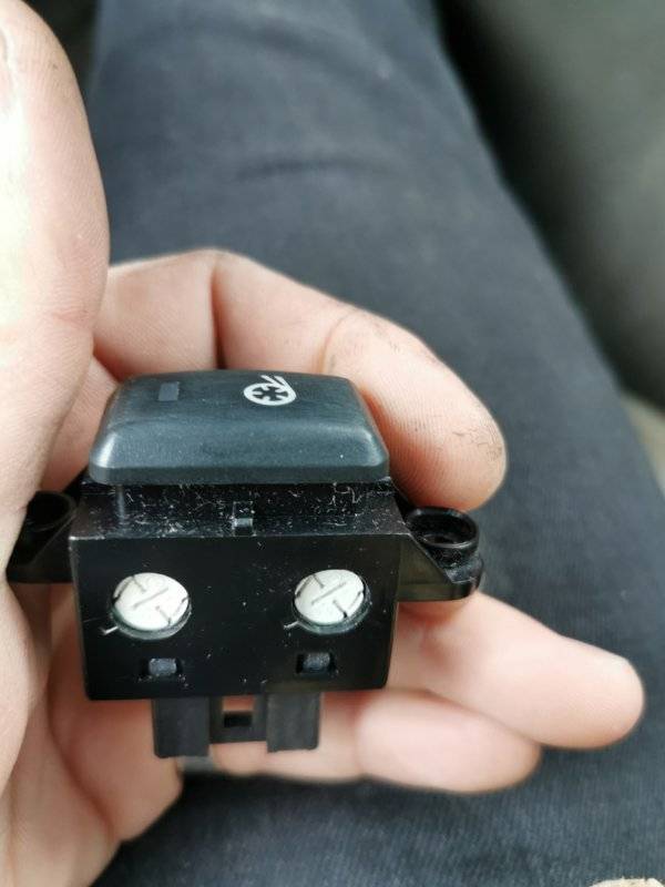

I have a 2003 ls3.0 and the DATC faceplate buttons don’t light up, however the heated seats level indicator lights and screen do light up. I cannot figure out why... fuses are good connections are good. The buttons for my sunroof also don’t light up and neither does my trac control button.
PLEASE HELP THIS DESPERATE NOOBIE
I don't know about the datc lights but the other ones the bulbs are probably just burned out. See picture for trac control bulbs
Okay cool I thought maybe something else was causing it . Would you happen to know what size of led the buttons take?
Good luck finding bulbs. The sunroof button and the overhead light buttons dont light up. I've had good luck with these. NEO3-GHP: 3mm NEO3-xHP Green. Some of the bulbs are 4mm and some are 3mm
