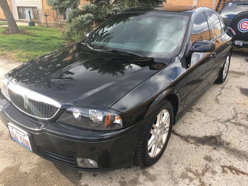

oh I've had her for a little bit now, its an 03 v8 sport and it had 74,000 when i got it. It came from North Dakota (Im in south Chicago burbs). For being a winter car it has ZERO rust at all, really love it. It had a TMC squeak as rigs calls it, so i changed the control arms. Nothing wrong in the Engine though. I bought it because it has all the paperwork proving proper maintenance at ford dealerships since the day it was bought, which is a major plus when buying a used car obviously, it was treated well too ~ First owner was a lil old lady, second was a cop with a take home car, third was an ex-military private security guy who was given a work car, and now the fourth is me. All three of those people are the kinds of people who take care of (at least) their cars, or at least the fit the stereotype.
The LS is obviously known for the bad trans solenoids, and 1,000 miles before i bought the car, the guy I bought it from had that changed at a ford his family owned, so I know it got treated well. Ill throw some pics below, it has a bit of hail damage and a couple dings, but nothing where the paint is totally scratched and gonna rust. and to be honest if it hails here (which it probably will eventually) ill take the insurance money and pay off the loan, and go to some paintless dent removal place.
Also since getting this car (the first car I've REALLY loved) I've almost been hit in it nearly 4 times, and I'm glad I have a dashcam because people can be idiots haha. Ooh another two things I fixed were the buttons in the middle for the display, the harness broke so i super glued it back in, and I fixed the hose coming off of the moon roof. I need to get the rear driver window track motor and regulator replaced soon because when they tinted the car they didn't put it back right so the rear window doesnt go all the way up, leaving a little fingertip length sometimes. but that's no biggie. Loving my LS :)

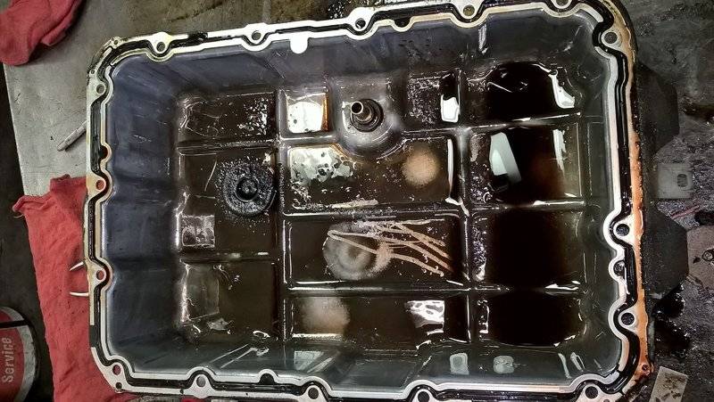

Hopefully the transmission fluid was completely flushed out after the car was bought new, as Ford was given some bad Mercon V fluid that was put in the 03's and some 04's I believe. We bought an '03 last fall with 48k miles on it and 2,600 miles later the tranny completely imploded. We ended up buying a new re-manufactured transmission for it and the best we can figure out is it may have been caused by the bad Mercon V fluid that was never changed out, even though the car had been serviced (not the transmission) at a local Ford dealer and this was a TSB issue because the fluid was lacking a additive and the Ford dealer never told the first owners about the TSB. It went out on the way to the tranny shop as I was going to get it serviced. When I first got to the shop, he said the solenoids go on these and ordered one before even taking the pan off. Well, when the pan came off it was not good news. I was standing right there and saw it for myself. Here is what it looked like with 51k miles on it.
I have the receipt for the new fluid they put in obviously when they changed the solenoid
When they drop the pan to do the solenoid, that doesn't mean all the fluid was changed. In fact if it was done the way most due it that way, only about 1/3 of the old fluid was changed.
Well how much fluid does it take? Ill look at the papers and see what they changed. Like I said the guy's family owned the Ford dealership so I don't see them shafting their own family.
If I remember correctly it's about 12 quarts. I wasn't saying anyone was 'shafting' anyone. There are basically two ways a transmission service is done. The 'old fashioned' way of dropping the pan and usually changing the filter and how ever much fluid is in the pan. The other way is where they 'suck out' supposedly all/most of the fluid with out dropping the pan or changing the filter and replacing more of the actual fluid. People will argue which method is best. I'm just trying to share with you what was a issue with these transmissions. Whatever way you decide to handle it is of course up to you. Just giving you a little FYI about it, that's all. :)
