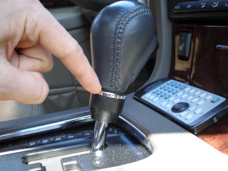

How to remove shift knob:
Step 1. pull down on the lower plastic piece of the shift knob:
Step 2. locate 2 screws that have now become uncovered:
Step 3. Remove screws, and remove knob.
Reverse steps when installing new one.
