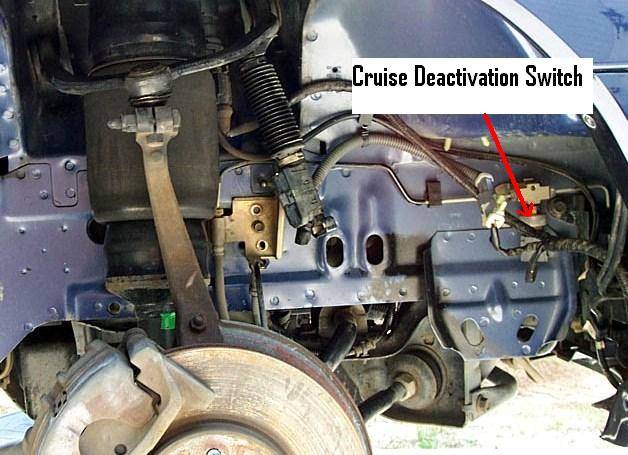

CAN SOMEBODY PLEASE POST PICTURES OF THE RECALL PARTS INSTALLED.

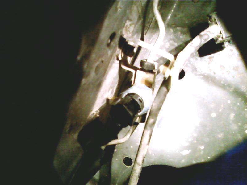

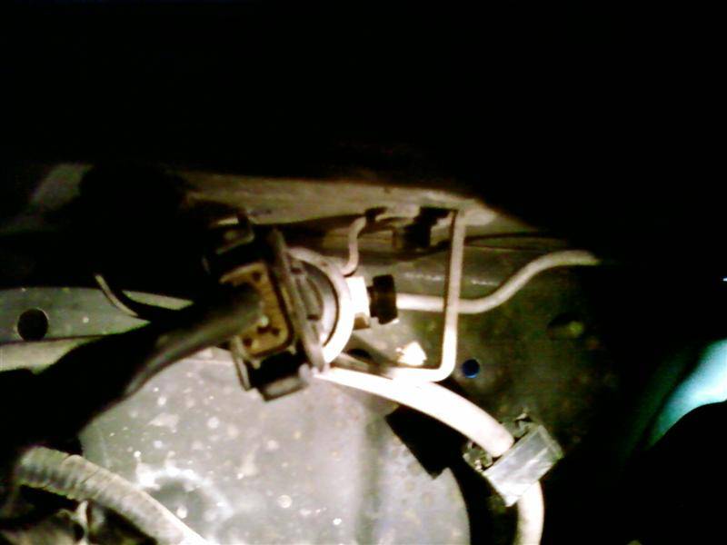

the switch is on the right front right? the one in the picture thats attached? took it minutes ago, nothing new there.....
nope. they didnt install anything.

It's under the splash shield on RH side front fender. See 10-03-14 in speed control section

the idiot prob couldn't find it so he just said he did it.....it should be the "newer style switch and about a 2" jumper harness with the old/new style connector on it

found a pic of the swith on our cars, i believe its 93's that have it under the master cylinder, the rest as pictured.........

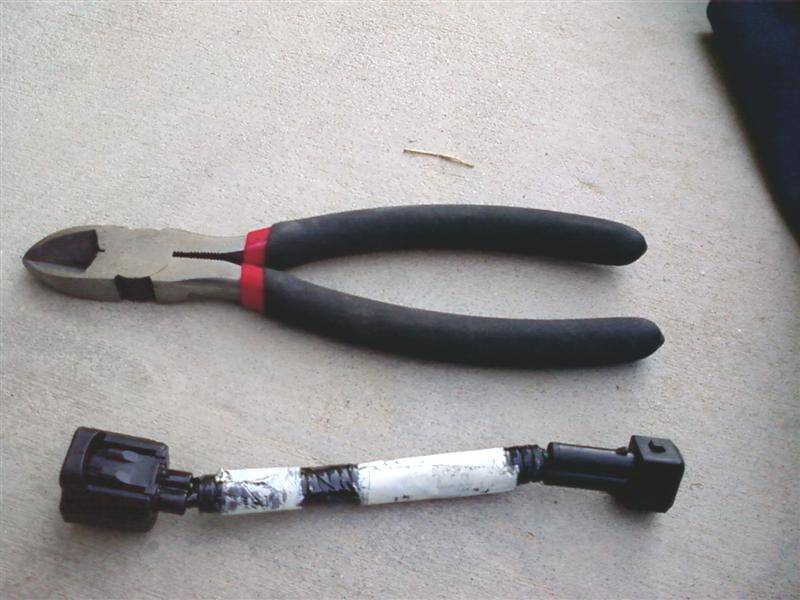

Acording to the recall the 93 mark takes 0.6hrs if dry and 0.9hrs if the old sw is wet. the 94-98 mark takes 0.4 if dry and 0.6 of wet. Just as pictured above it is a new switch and a short, 6", wire harness.

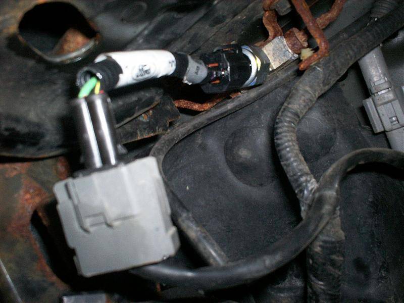

pics of new swith, and harness.......it just connects the old connector to the new style swith.........wasnt it supposed to have a fuse on it or something :confused:

ill have to check the adapter harness to see if its a fusable link.
the original recall for non-leaking switches was to install a fused harness only. these are new redesigned switches.
