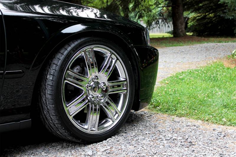

Comparison to fronts before:

That looks great!
I'm thinking of ditching my 20 inch rims in favor for 18's and getting these.. So a couple ??'s for you bull..
Those are 18" range rovers am I correct? Do you know the offset?
How much clearance do you have around the tire?
How much more do you think you could drop it before worrying about rub?
If you could answer these for me it would be greatly appreciated before I take the plunge in about another week or 2..

To echo what a couple others have said. They are 19x8 et38. To run RR wheels you need special custom hub/wheel centric adapters to change the PCD.
There is still a couple inches of vertical clearance above the wheel so I can definitely go lower and tuck them. The dampening on these allows someone to do that and minimize the risk of losing a fender with the firm suspension. If you remove your fender liners and roll/pull the fenders you could get even more radical
