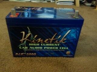

So next up is the install of the HC 2000. The main goal I wanted to acheive was; fit the biggest battery i could in the stock location with minimal modifications. I wanted to be able to upgrade to a battery that could better handle a demanding amplifier especially when the vehicle is off. I also wanted to make sure the battery would be a true sealed unit and would not require a vent tube.
I was between an HC2000 and HC2400. I decided to go with the HC2000because it was a few hundred less expensive, i found a pretty good deal on one, and because i beleive that with a the length of 13" on the HC2400, it would require more than simple modifications to the factory bracket to accomplish.

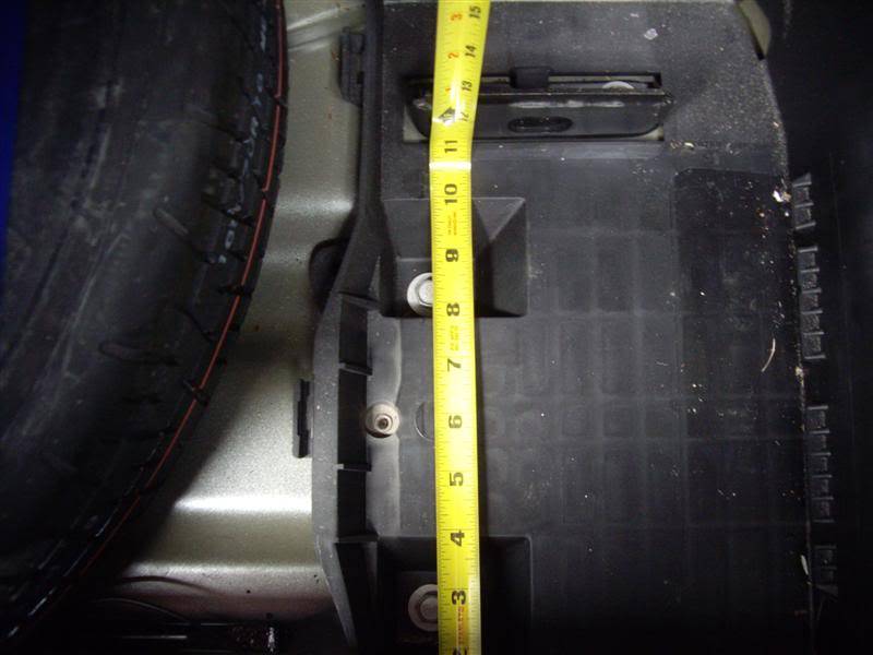

-The stock battery is 11" long which is a perfect fit inside the length of the stock location. The Kinetik is 1" longer.
-This is the space available in the stock location.

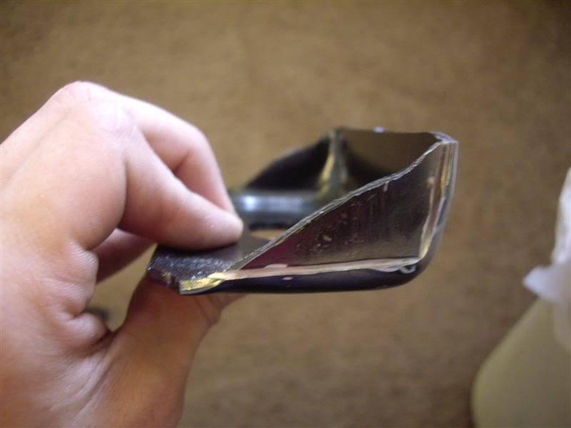

-The bracket is made up of some fairly heavy gauge so a powertool is the best way to modify it.

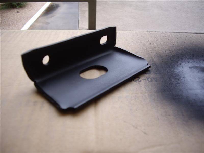

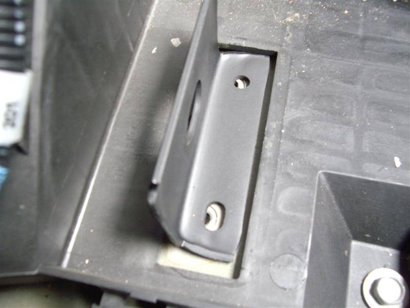

-The bracket will basically have to be turned 180 degrees. The sides of the bracket will need to be cut out in order to allow the battery to sit within it. Here I have outlined the area that will be cut.
-After cut has been made and painted once again to prevent any corrosion.

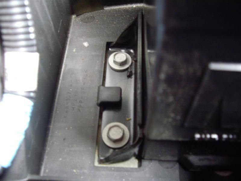

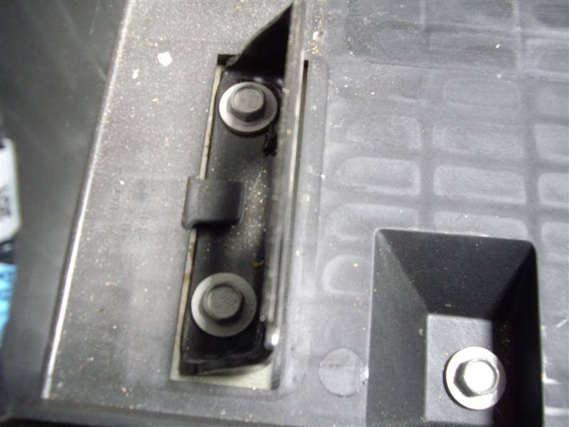

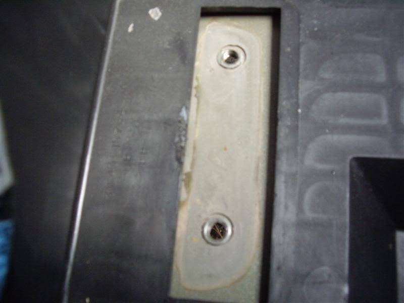

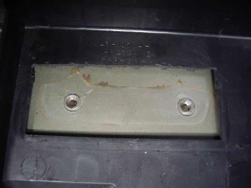

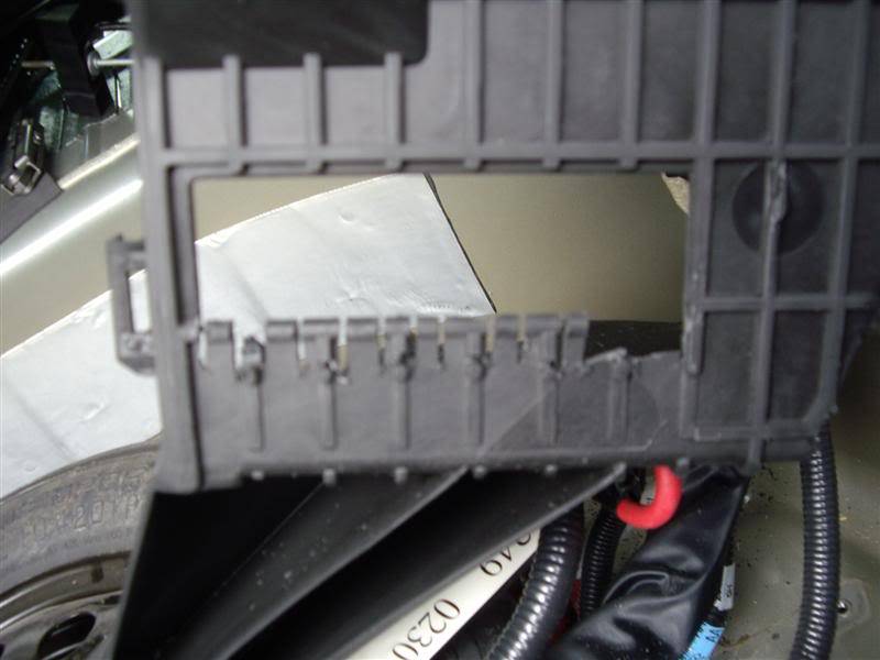

-Now the actual plastic battery "tray" needs to be modified in order to accept the new bracket.
-This tab needs to be removed. Tray is plastic so any tool will do the job.
-Here you can see that the modificaitons to the tray are not over. The holes on the bracket will not line up with the factory threaded holes. The backside of the tray will need to be cut at least 1/4".
- In order to accomplish this I unbolted the factory tray which is bolted down by a few bolts. Im sure it is possible to do without removing with the proper tool.
-I used a key hole saw. Dremel would of made easy work of it.
-Here is the finished product.

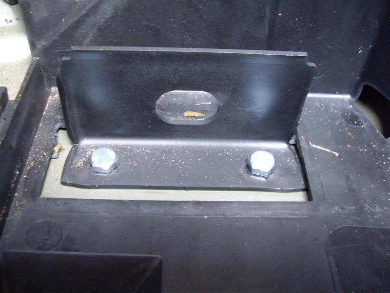

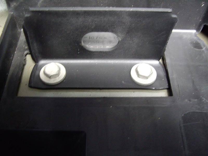

-Now that the bracket has been reversed, the bolt heads got in the way. The battery was unable to rest on the tray as the head of the bolts stick up a bit farther up than the bottom of the tray. The factory bolts have built in washers.
-Bolts I baught at the local hardware store. No washer, less height, happy battery. Bolts are metric, M8-1.25x25.

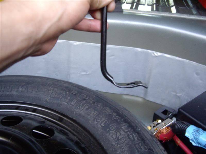

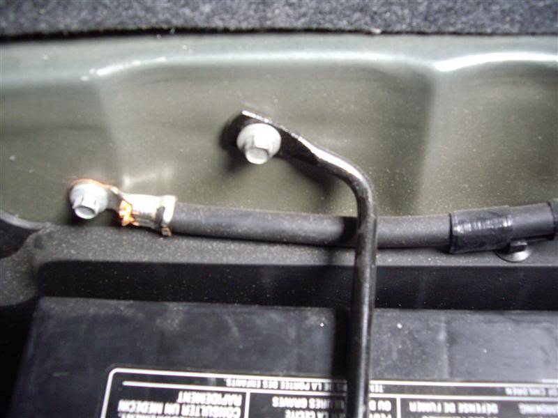

Metal Rod/Spacer

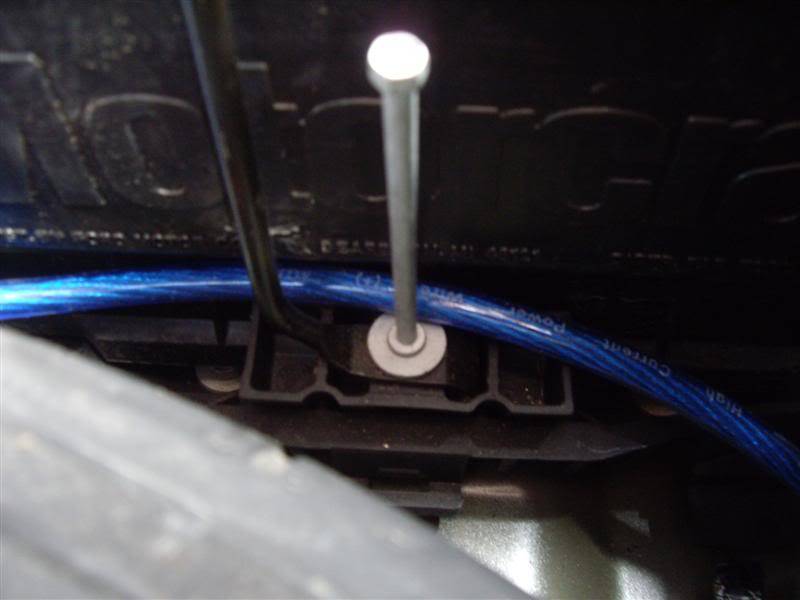

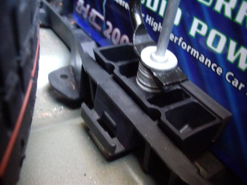

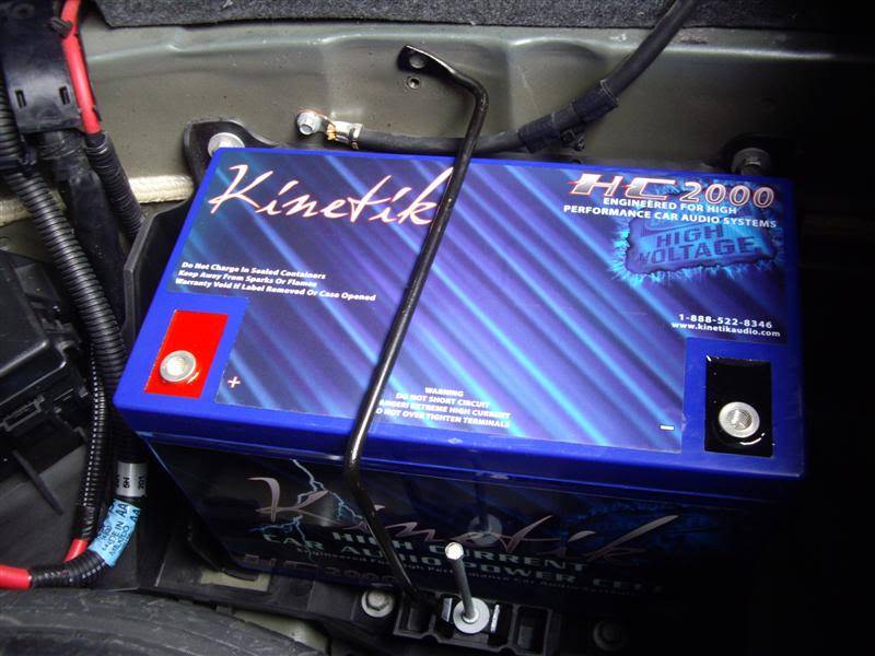

-This is the a picture of the battery in the battery location. Notice how the rod end does not align with the threaded hole. Also the factory bends on the rod do not allow it to allign the bolt in the spacer with its threaded hole.

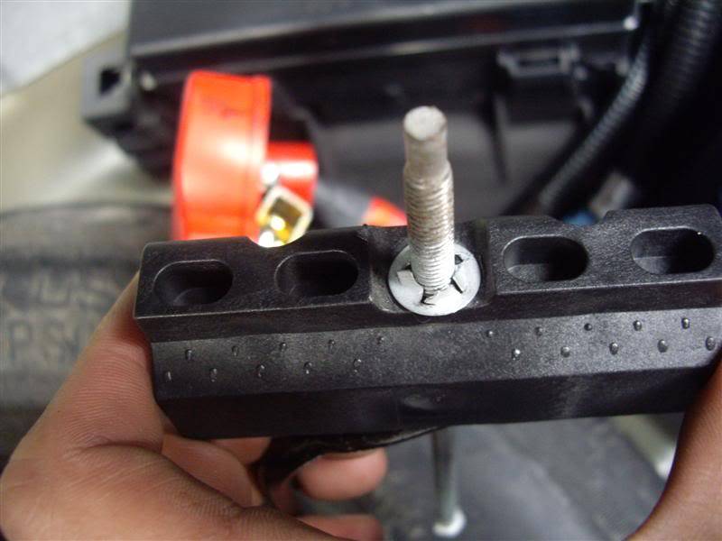

-It is important to modify the spacer first. The spacer and rod are both part of the same mechanism. Before you can bend the rod the spacer needs to be set in place. The rod attaches to the bolt/spacer and so any change in the possition of the spacer will promp a change in the bending of the rod.

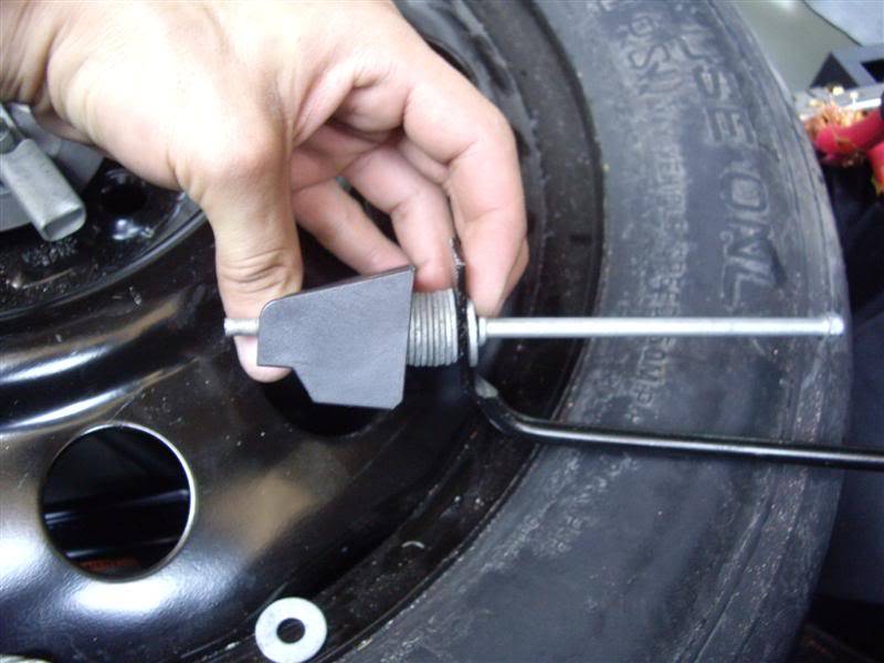

-Here is a picture of the rod, bolt and spacer.
-As you can see, the rod connects below the washer on the bolt. Then the bolt connects firmly to the spacer. The rod is not long enough to attach itself to the side of the trunk and make it all the way down to the bolt once the new, taller battery is in. So basically what needs to happen is, the bolt needs to come up somehow in order to make up for the 1/2" gap.

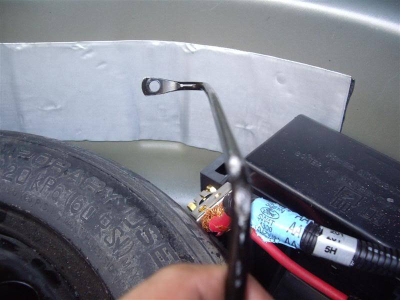

Remmember that the bolt is attached to the spacer. In order to pull the bolt upward to make up for the gap, we need to make sure the spacer stays in place. So in other words, detach the spacer from the bolt.
Here is the nut that is located on the bottom side of the spacer. This nut does not allow the spacer to move lower on the bolt. If we are too pull the bolt upward and keep the spacer in place, it needs to be removed.
Once removed the bolt can be pulled upward freely and allow the rod to attach to it. Now we just need to bend the rod in order for it to align itself with the thread on the side of the trunk and the bolt.
-Factory bend of upper part of rod.
-In order to bend the rod. All that is needed is a hammer and a table vise, or the pavement : ).

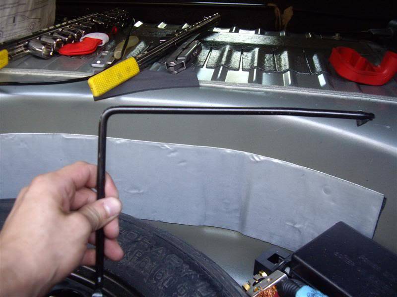

New bend to the rod.
-A few more bends made to the rod. This is basically trial and error. Bend and check fitment over and over again.

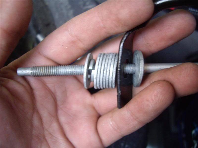

-So now we have the rod bent into proper shape, spacer set in its factory bracket and bolt pulled upward in order to attach to rod.
Remmember that in the original picture the set washer on the bolt is what provided pressure downward on the spacer so it would be set in its factory bracket. Now that we have pulled the bolt upward, that set washer no longer makes contact with the spacer so no downward force.
We need to place washers below the set washer on the bolt, down to the spacer. These washers will allow the set washer on the bolt to press down on the spacer.

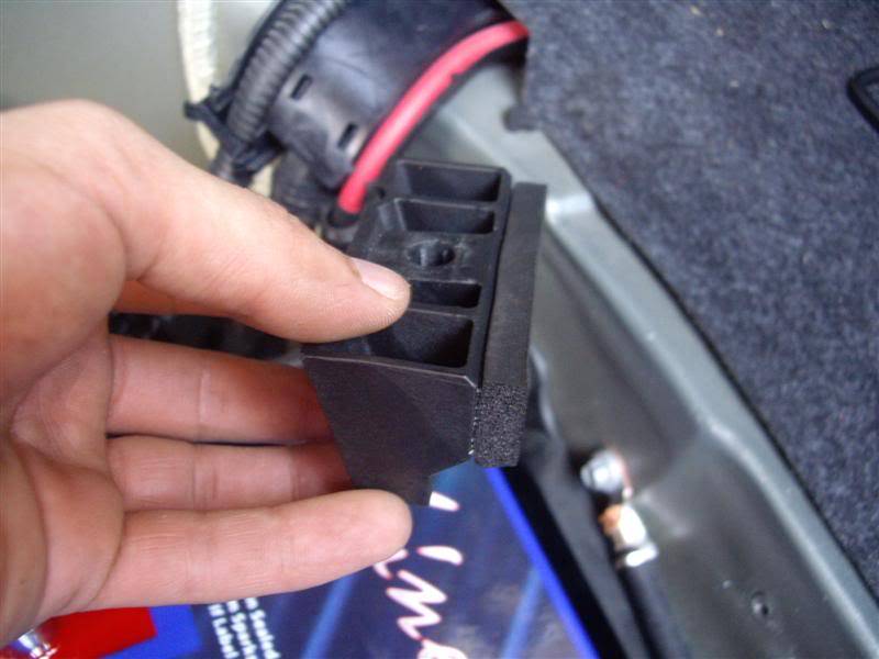

For a more snug fit, I placed some thick weather stripping along the spacer. The Kinetik battery is actually thinner than the stock one, so a bit of weather stripping allows for a snug fit.

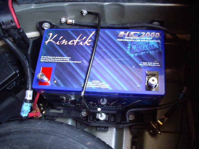

Here is the final product. Kinetik HC2000 installed in stock location.

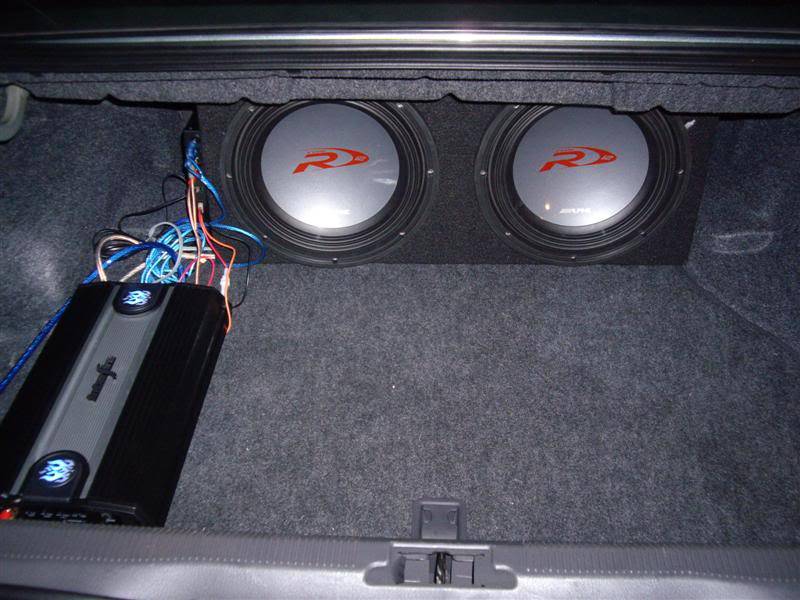

This is the old system I had (I later upgraded the box which took over my trunk).
Thesse 2 12's and amp were really killing my electrical. I would have constant dimming headlights and dash lights. For my new system I had to get as much power from my stock electrical as possible. Now that I had the new batt, the big 3 was next.
I know wiring is a mess. I cleaned it up later that day.

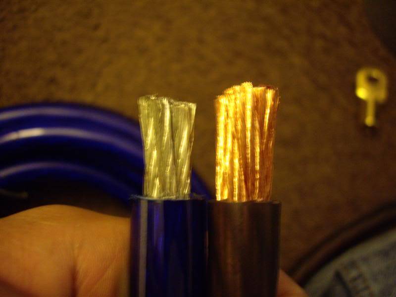

-You have to be carefull when purchasing your 0 gauge wire. Just because the manufactur states that it is 0 gauge, does not mean it is necessarily true 0 gauge. I baught a DB Link amp wiring kit, CKODZ from sonic for $65 (was initially going to use 2 amps), and 24 ft of Cadence 0 gauge wire from audiosavings for $49. The plan was to use the provided 0 gauge from the amp kit and the extra 0 gauge to do the big three and amp install. Heres a comparison of the 2 wires.
-Cadence left, DB link right
-DB link left, Cadence right
If what I was after was insulation, I would be extremley happy with the DB link wire. Im sure neither of these wires are 100% copper but I can tell you the DB link uses more aluminum than anything else. In my opinion, stay away from DB link wires, their other products are great. The fuse holder is very good quality, but as you can see, their wires are sad. If you have the money to spare, go with Kicker or Stinger.

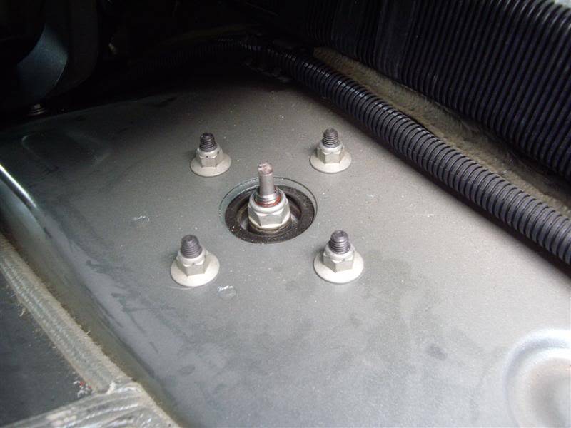

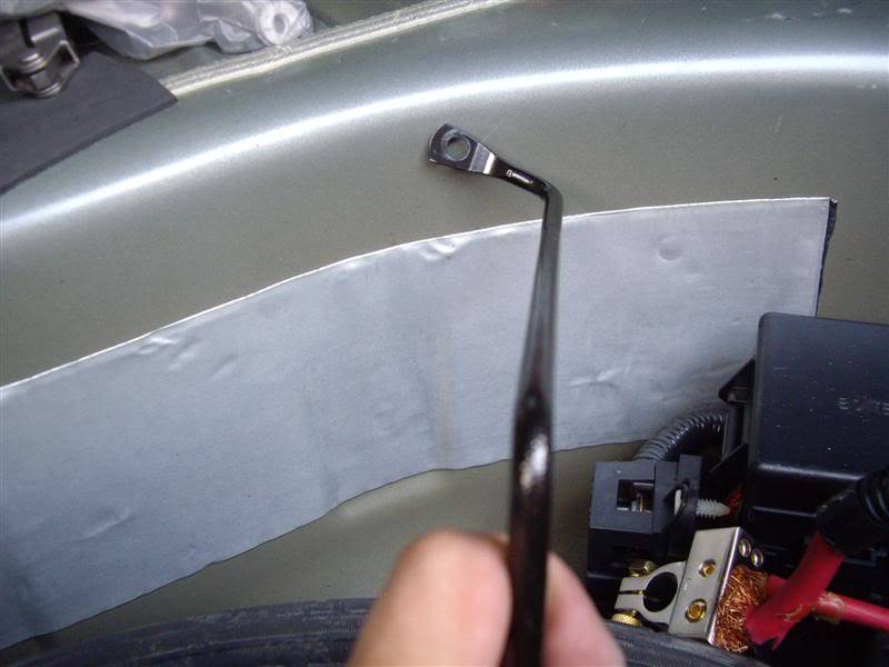

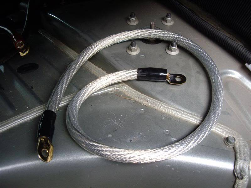

-This is the first cable. I attached it to one of the strut mount bolts and the negative terminal of the battery. Some have said it is best to sand down the paint right below the nut, where your cable makes contact with the body.

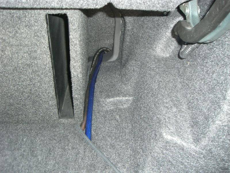

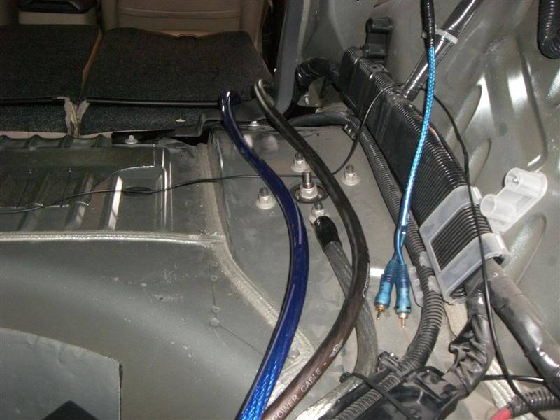

The trunk is the only area of the car where the wires will be visible.

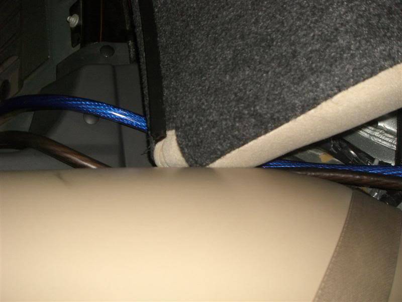

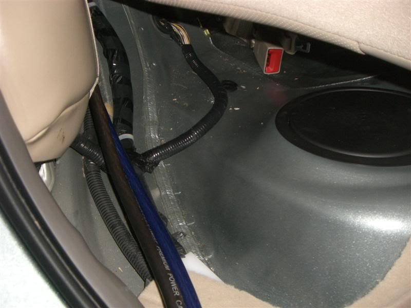

- Both wires running under the back seat back rest.
- Notice that the seat is removed and wires will run under the seat.
- Running the wires under the carpet on the passenger side.
There is only one area inside the cab that is troublesome. There is a plastic tab, on the frame of the car, right beside the passenger seat. Youll need to push both wires below this tab and against the frame or else the carpeting will " bulge out" and be tight against the passenger seat which will create pressure working against the movement of the seat. You dont want to put a strain on the seat motors. Very tight quarters.

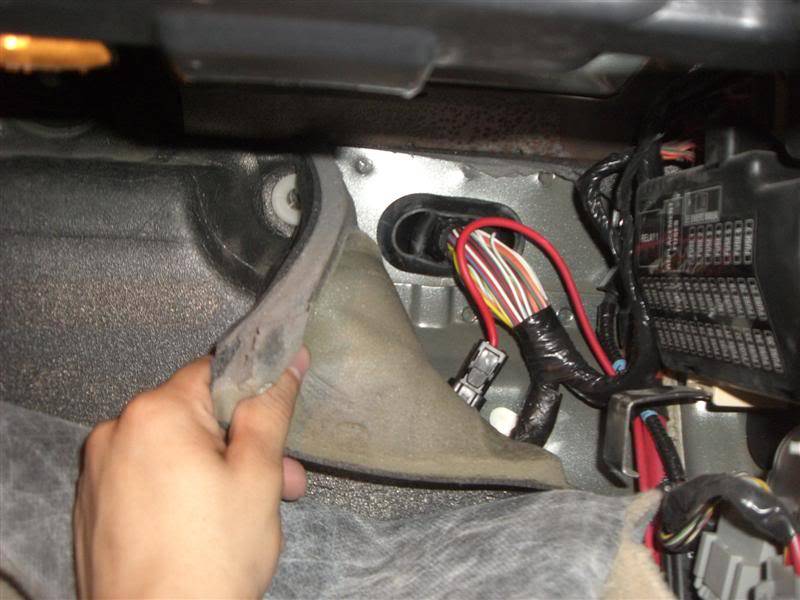

Now to run the wires from the cab into the engine compartment
-Underneath the passenger side carpeting. Notice all the room available to the left of the wiring.
-After cutting out the excess rubber. Now theres room for both the wires.

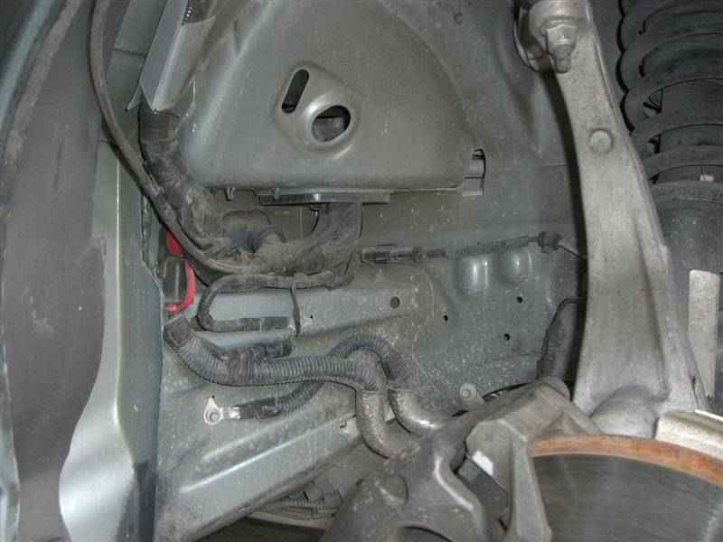

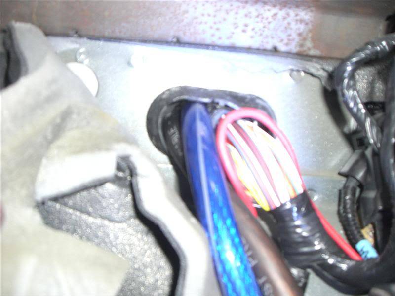

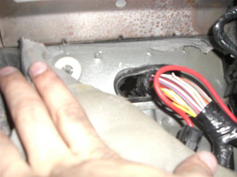

Hardest part of the big three was runnning the wires through this opening. It is hard to run both wires through the opening and keep the rubber "gasket" from pushing out. Everytime you try to push out the wires, the rubber peice wants to go with it. At the end, I just let the rubber peice push out. I then pushed both wires through it, and then placed the rubber back in its location using needle nose pliers.
-Both wires through opening.
-Both wires out from the cab into the wheel well.

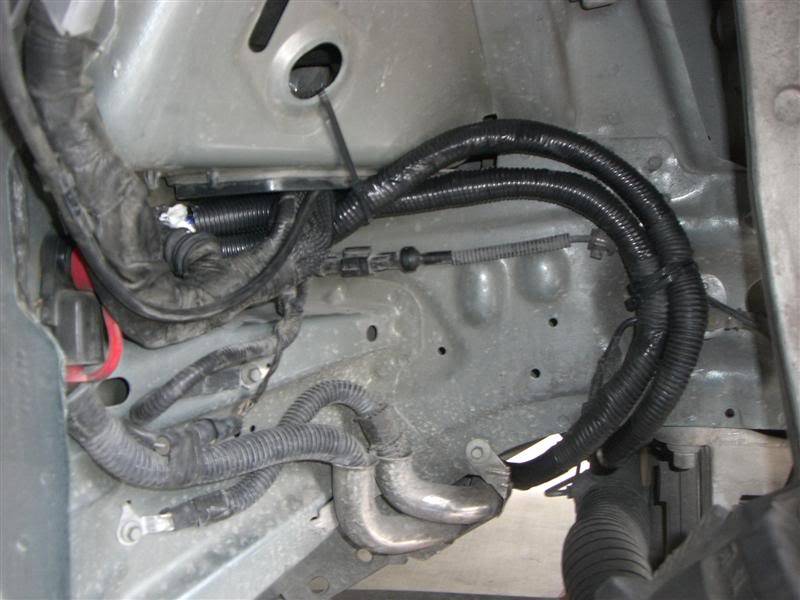

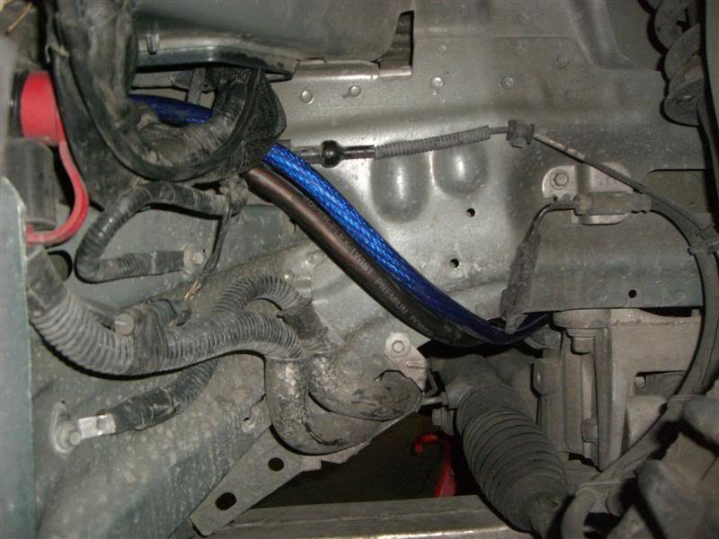

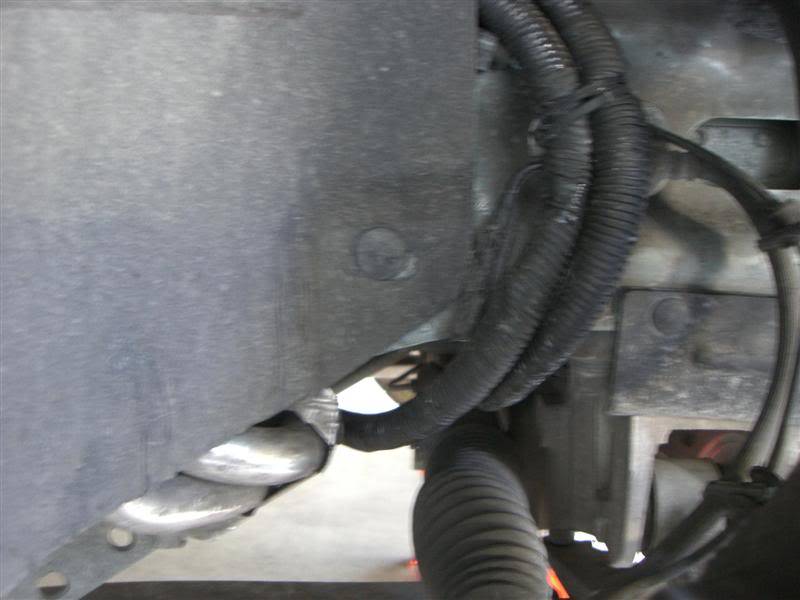

-From here i looked for the best way to reach the alternator/ engine. After some thought and multiple attempts, this is how it worked best.
All the wiring was well protected. I covered the exposed areas with flame retardant plastic wire counduit and then wrapped the closest areas to the engine with heat retardant tape from Autozone. The rest with electrical tape.
-Wires in place. Notice the silicone (fresh) I used against the rubber gasket to create a watertight seal. Multiple zip ties keep the wires in place.
-Portion of the wires that will be exposed after re installing inner fender.

- "+" batt to alternator "+". Easy to find. Just look for the red wire and connect your "+" with the same nut.
(Pic before I wrapped and protected the wire)

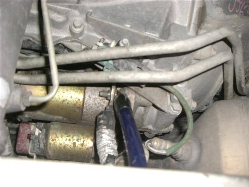

Next the "-" to engine for ground. There are many bolts on our engines but the one I saw the easiest to install on was the "-" from the starter. This bolt goes directly to the engine.
If any member knows of a better place, chime in, but that is one very direct bolt.
-Wire attached to starter. (Again before I wrapped the wires)

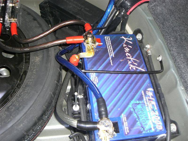

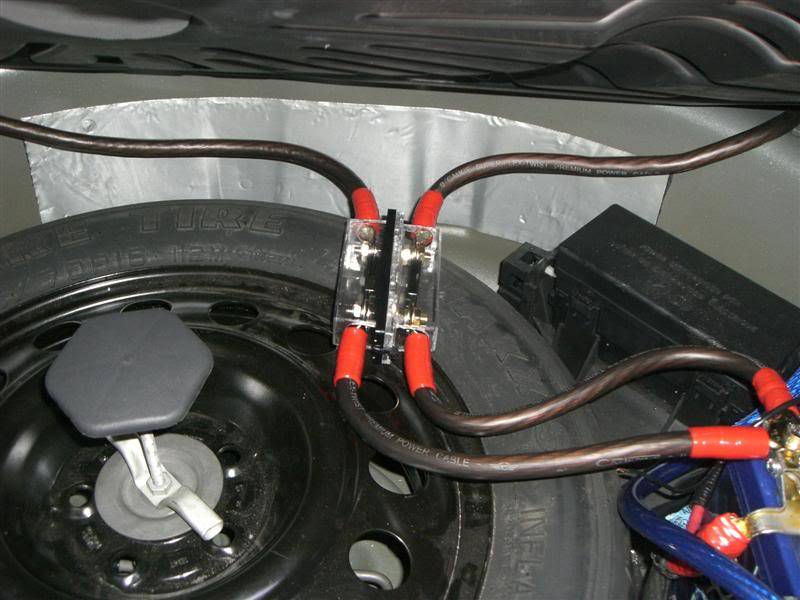

It is very important to fuse your power wires, both for your amp and the new wire leading to the alternator. Ive heard some people say no less than 18" from battery and others, no less than 12".
-Both my fuses back to back. 200 amp for both. "+" cable on left is leading to the amp.
-Close up of the wiring on the battery. All factory wiring still attached.
-Blue wire- "-" batt to engine
-Silver wire- "-" batt to strut bolt
-Brown wire 1 - "+" batt to alt, 200A fused
-Brown wire 2 - "+" batt to amp, 200A fused

also yea dont be fooled by cheap wire, i think its bull sh!t that companies can get away calling it something its not. but usually if a brand of wire is half the price of another brand, there is a reason.
Yeah its deff an area where i could of passed the wires. Very tight but im sure its possible with a bit of deconstruction.
I wasnt aware companies could falsely advertise wiring like that. Im sure they may be able to claim that they meant "0 gauge w/ the insulation".
Ive seen advertised 2 gauge but really is more like 8 or less. It is ridiculous what some of these company's are allowed to get away with but as long as people still keep buying it they will still keep selling it....
