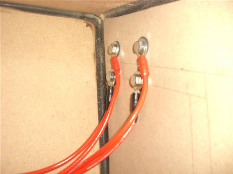

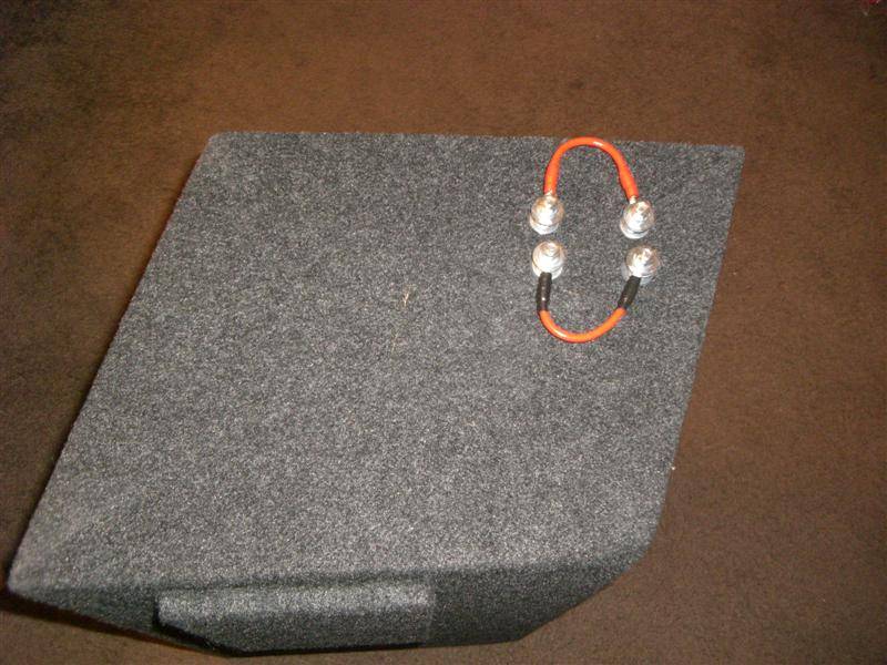

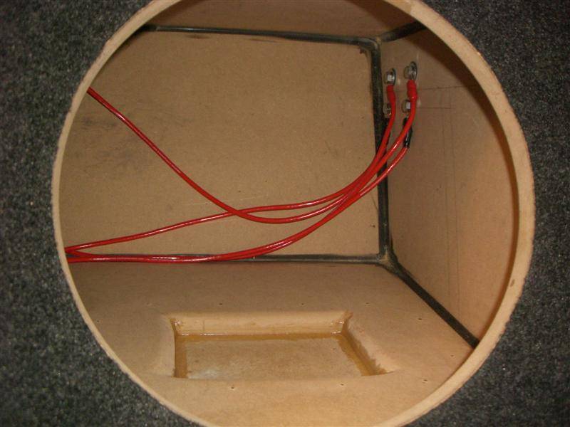

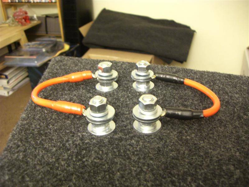

So heres a few pictures of wire and terminals installed in the box. I used all 5/16 zinc hardware along with rubber washers. This is the order of the bolts from inside box to out:
-Bolt/ terminal/ metal washer/ rubber washer/ box/ rubber washer/ metal washer/ lock washer/ nut/ metal washer/ terminal/ metal washer/ lock washer/ nut.
I used 2 nuts on the outside so that I could easily loosen the outer nut and make sure the bolt would remain firmly attached to the box. I beleive the bolt was a 2 1/2

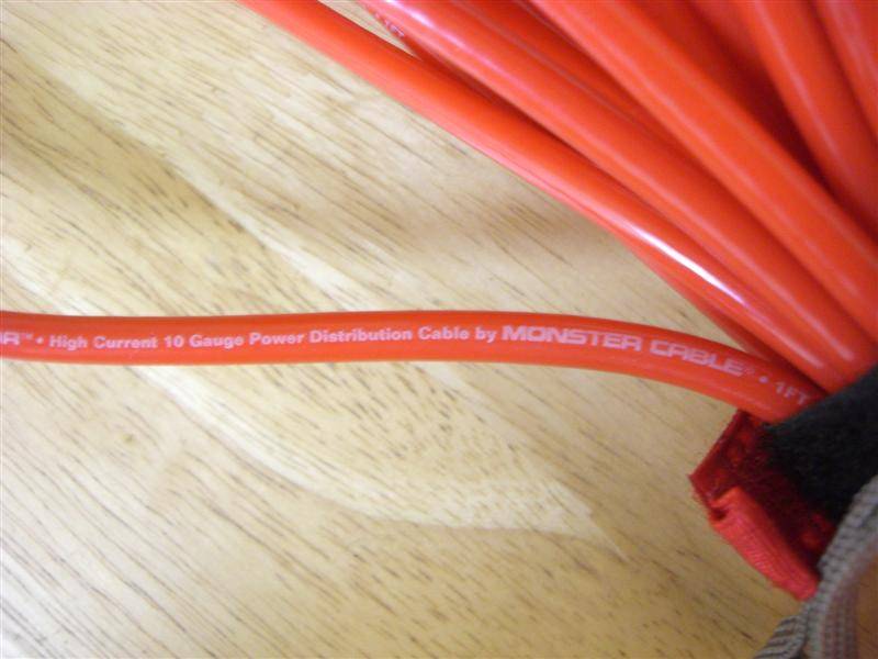

The wire I used is 10 gauge Monster Cable that i purchased through Audiosavings on ebay. Cost me $29.95 for 50ft which is more than enough for my setup.
