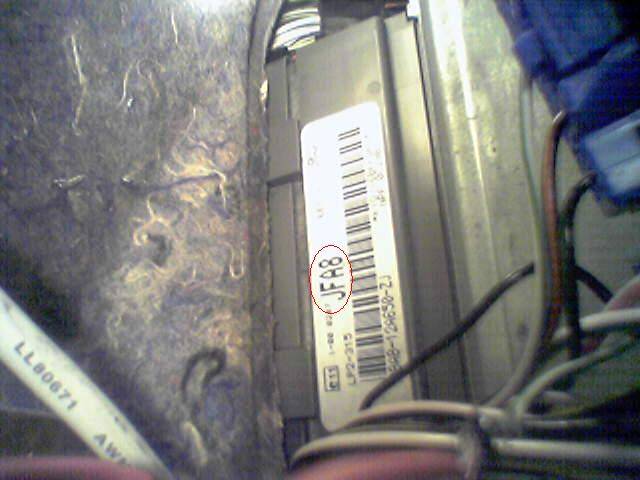

2 and 3 will be a fail for sure. I'd do exactly what Driller is saying because he isn't going to have the same PCM code that you have. #2 is where he will most likely be busted and if needed, threaten to get the BBB involved. I bet he'll shut up about it and let you roll.
4 digit code on the pcm...
Don't get that confused with the part number. "catch code" is what you want him to match up. Just like you see above in the circle. Problem is, do you know what your catch code was? I doubt that code will be on the receipt. You might have to call Lincoln and let them run your VIN# to find out what your catch code was when new. He may have changed out PCM's but it wasn't needed. If the old one he has goes in and it starts, that will prove your point.
it's also worth noting that you have a 96, so it will NOT run with a computer from any other year-that means he had to find a 96 ECM and it and your 'old' ECU can only have catch codes from a 96-the running ECU and your old one have to be produced, he couldn't just get one and claim it was your old one. This guy sounds like a buffoon, because it is not easy to find an ECU for a 96. Driller's right too, if this guy is for real he should provide proof that he bought a new one for a 96, plus what are the chances that he came up with a working 96 ecu, installed it and got it running, then LET IT SIT without contacting you to tell you he had it running-I call bull:q:q:q:q.

I never thought of that, but if he installed a new ecm, he 'should' have disconnected the battery and the crappy connection should have been repaired when he installed it (and fired it up, yea, sure).
I don't know if I'd even bother with hooking up the 'old' ECM since you won't know for certain if A) it has been tampered with so that it is now disfunctional or B) it is off another mark but NOT a 96, so it won't run anyway-that would only prove him right, don't even give him the opportunity.
Driller's advise is what I'd do-let him prove he BOUGHT a correct ECM for a 96, and can produce a defective 96 ECM that came out of your car. He can't, he's a liar too. You also need to do the BBB thing, and advertise what a lowlife he is so other members here know not to deal with him.

Yeah, it might not be a good idea to put the computer in that he has because it's very unlikely that he has one for a 96 and it will not start. Check yours to see if it's a reman. I just looked on rockauto.com and all they have are A-1 Cardone reman's for $136 with a $70 core. I wasn't even paying attention to you having a 96 when I suggested putting in the one he says he took out.
Honestly, I think with it being a holiday, you're car was never even messed with. Like Jamie said, it was most likely put on the back burner with him knowing that he would come back and clean your terminals and write up some high priced bill. I would find out what "catch codes" were used for 96 Marks and see if his matches. If his does match, then put it in and see if it starts. If it does not match, then you know he lied and what he has in his hand will never work anyway. What are the chances of him knowing that he has to have a specific year computer for your car?
I could be way off but I wouldn't think that no more than 2, maybe 3 catch codes were used for 96 and with it being year specific, the number may even be dropped to one, maybe 2. I would find out what these numbers are and if his do not match, do not bother pulling yours to put his in. It's going to fail if it don't match and he's going to say "SEE"
