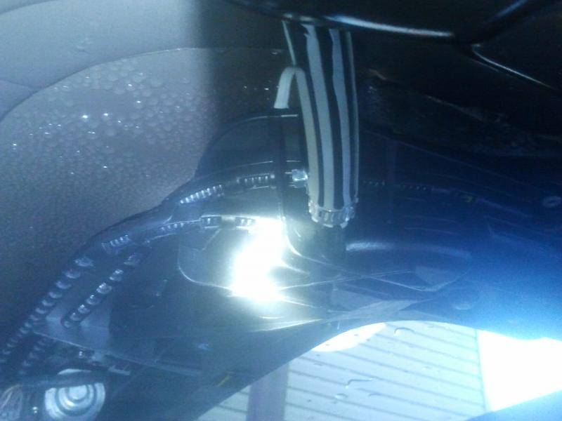

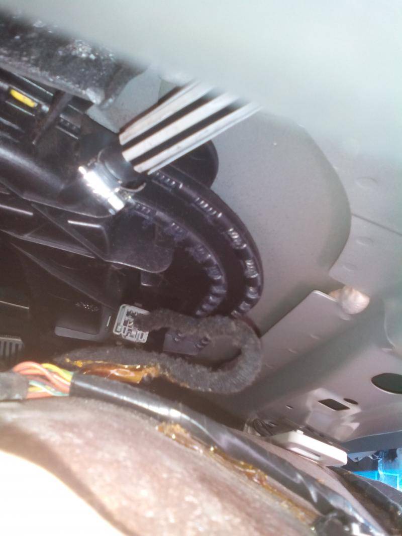

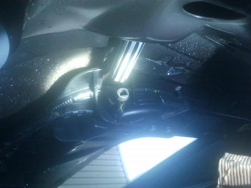

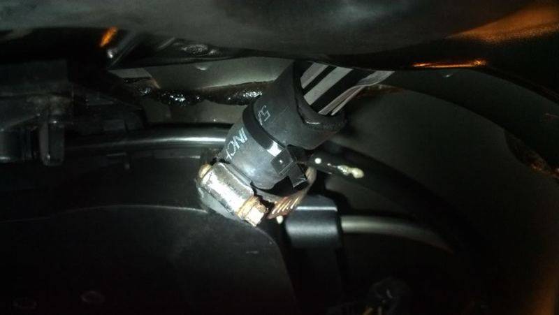

having done this repair four or five times now, I probably could repair one side in close to 30 mins, knowing exactly how everything comes apart is a huge help. also most of everything just pops off except for a couple of phillips and torx screws.
the temperature also makes a huge difference when doing this, the first couple of times of attempting this were done in the winter after feet of snow melted and then froze back into ice cicles in the winter, the hoses were way too short and almost no matter how hard I pulled, they really didn't come much closer to reaching. the last couple of times have been while sitting in the hot ass sun during the summer. when hot, the hose had no problem stretching back and fitting over the nipple.
