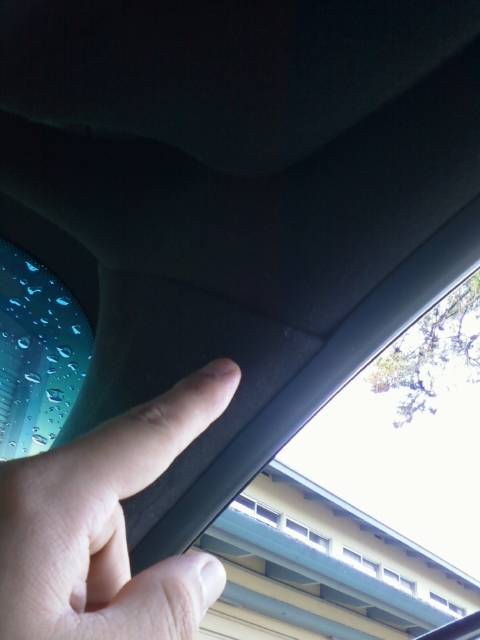

    With all the rain we've had these past few days, the LS just started leaking water on the passanger side. It actually drips down at the point where my finger is... my carpet is soaked! :(
    But i cant figure out if it's coming from the corner of the windshield of from the door. There's nothing i can see that would allow the water in.
    Has anyone also had this leak? If so, can you point me in the right direction to try to get this fixed?

    Do you have a moon roof? If so, there is a gutter drain hose that runs to each corner of the car. At each corner, there is a connection where the hose connects to a drain hose that runs down the corner. Your drain hose has pulled loose at that corner.

    You have to remove the A-pillar, the sun visor, and the passenger grab handle. You can then pull down the headliner enough to see where the tub attaches. I reattached mine and secured it with a nylon zip tie.

    My leak is exactly where OP points to on the picture, but on the driver's side. I'm assuming the tubes would be the same on both sides?
    Maybe a picture showing the exact location of the tubes would help.
