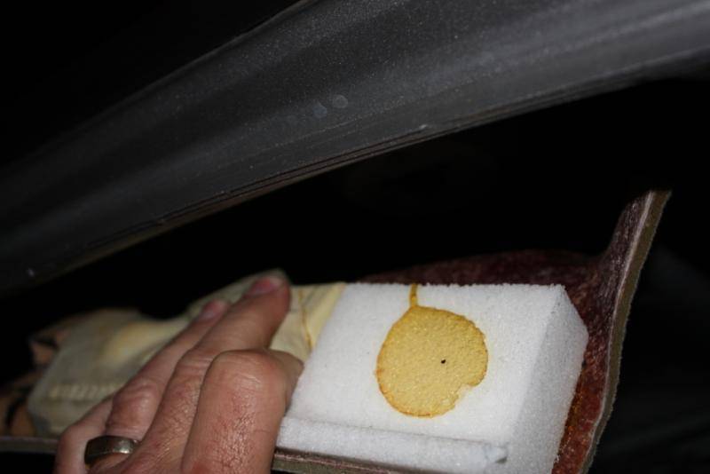

Lost of water leaking in...
It's a very tight fit. I had to pull down gently and squeeze my hand in there.
Just barely enough room to get it in there and put the hose back where it belongs... with the help of a little adheisive...
I just added tube into the gap. It seemed like pulling them back together was only going to recreate the issue.

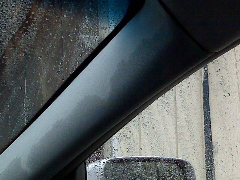

Lots of rain overnight and...
This is what mine looks like this morning.

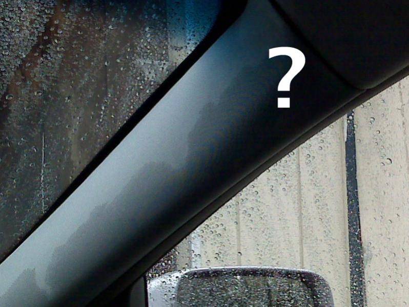

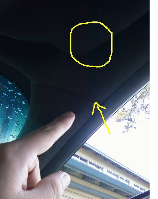

Could someone please point out on the picture below exactly where the tubes are located?
The tube runs inside the a-arm structure and should run all the way to the floor (or thereabouts). You can't really see it just from pulling off the cover.

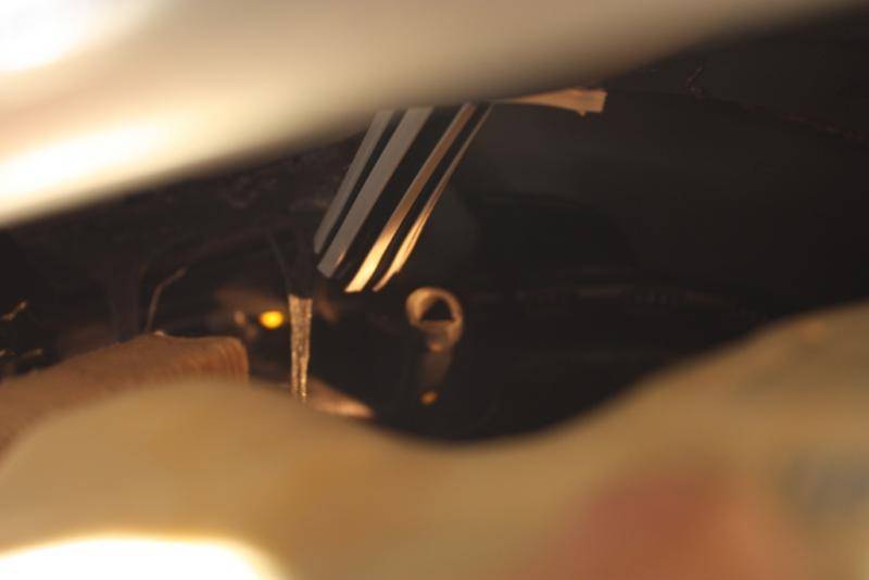

Taking down the headliner really isn't that hard. It'd held up by the pillar covers, the pull handles, the visors, cabin light module, and several pieces of velcro in front of and behind of the sunroof as well as along the back edge. I think the light module is attached with a screw or two, or might just be clips.
In any case, thirty minutes of careful work will have the headliner sitting on your seats. You don't need to remove it to work on the tubes. Removing it from the car is where it's easy to f'up because there's not quite enough room through the rear door without folding it.
It's easy to see the tubes once the headliner is off. For reference, mine were black with white "edges" sticking out. I had to zip tie one onto the sunroof because it had gotten too loose.

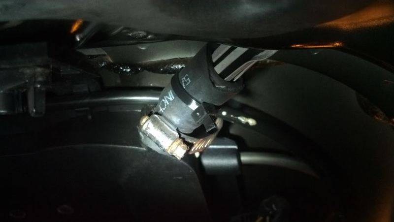

Here's a pic of pulling the corner of the headliner down looking from outside the car between the roof and the headliner back toward the moon roof.
Followed by a pic of the hose sitting away from the connector barb on the front corner of the moon roof.

Almost 2 years to the day of when I started this thread, the hose came apart again. A 2 year fix isn't bad... but this time I'm going for forever.
Here's my fix:
