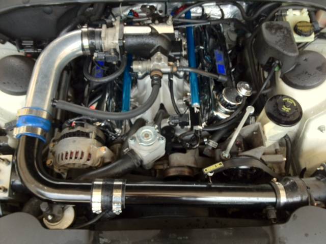

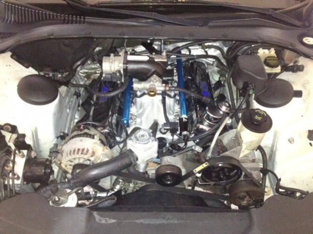

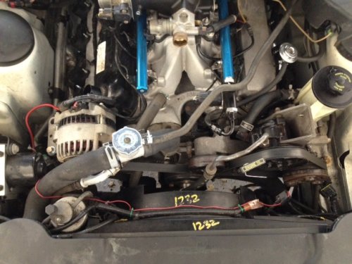

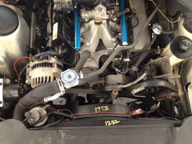

Detail work
I had a chance to finish up a lot of detail work on the engine compartment today:
Flex-A-Lite 31165 variable cooling fan controller
Chrome valve covers
Rerouted the vacuum lines
Cobra Earl thermostat housing adapter
Moroso filler housing
New power steering line
EGR fooler
Before
After
I also installed a Steeda short shifter for a 05 V6 Mustang
I need to figure out the inlet tube but the rest looks pretty good.
