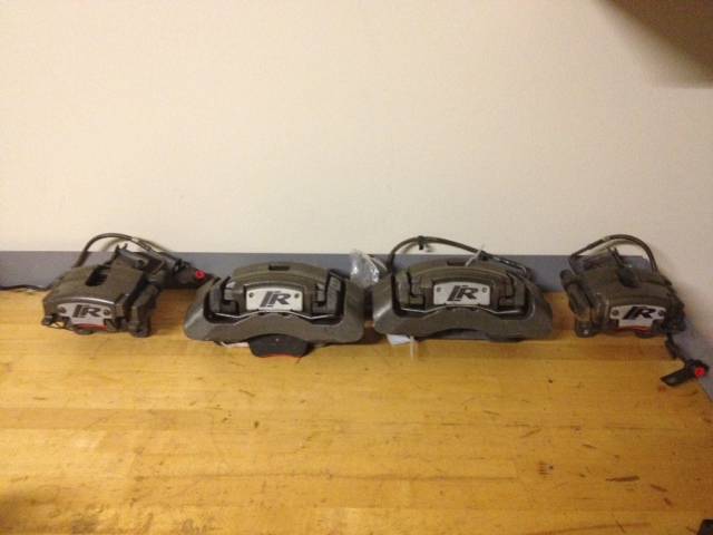

Who thinks these will fit?
What are they off of? (sorry pic is tiny on my phone) I would imagine if you could make an adapter almost anything could fit. But I am not sure.
And I read that guys whole thread on the turbos and I have to say he did an awesome job on the fabricating.
They are off of a 2006-2007 Jaguar S Type R and yes they do fit. THey are a direct bolt on.
I tried them today.
The 14" rotors are now on order.
Nice! What size rotors are stock?
EDIT: looked it up, 11.8" is what I found. If they are direct bolt on why the need for larger rotors? I think I'm missing something in my head.. haha.
the calipers are probably a direct bolt on for the spindles.
and since they bolt to the spindle, all you need to do is put a rotor under them, and bam, big brake kit.
Those are damn nice!
But are they improved over the LS calipers? The older STR calipers are brembo but they won't work with the LS control arms.
It will be interesting to see them on. Any plans for rotors or are you doing stock Jag STRs?
Bought them used off a low mileage car with brand new Red Stuff pads and stainless lines for 400 bucks. A steal if you ask me. Rotors are on order.
The biggest improvement is the size of the brakes and the factory stainless lines from the Jag.
They are not Brembos but they look nicer than the Lincoln's and they are bigger.
