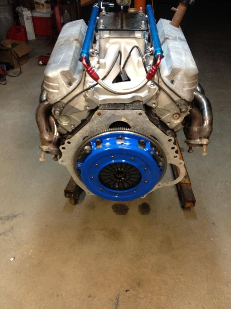

The transmission is completely filled and mounted.

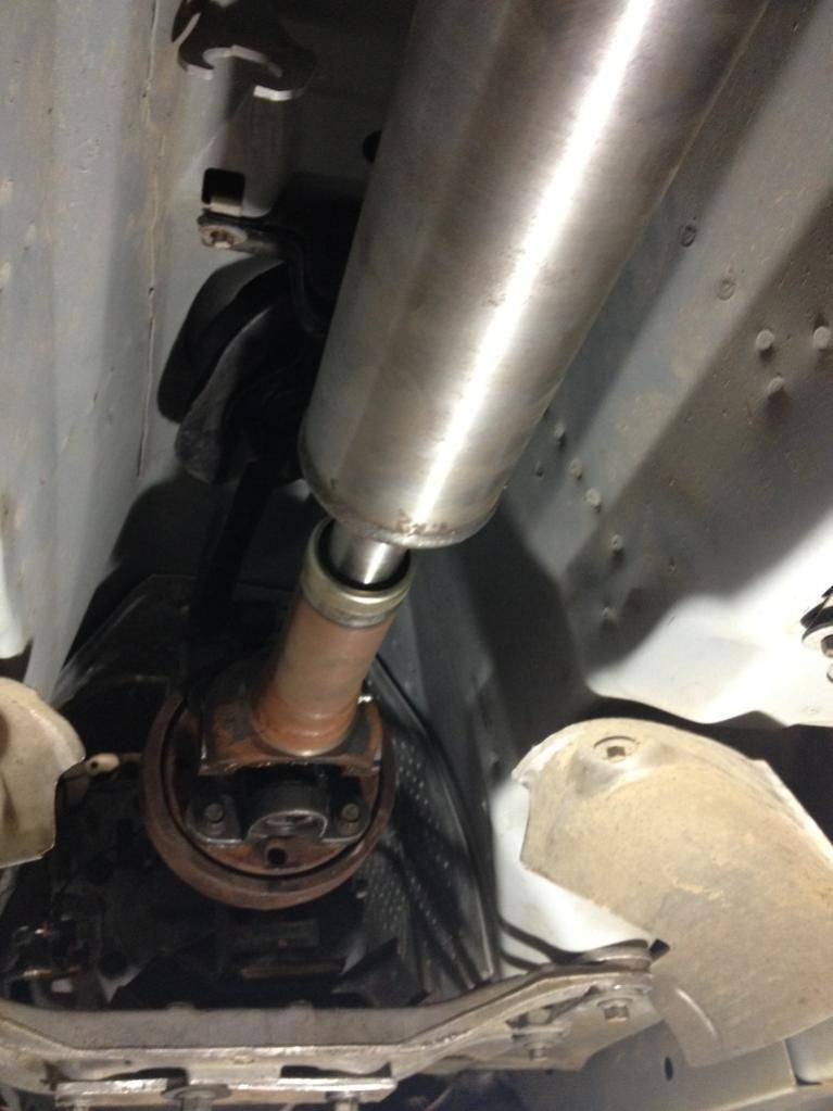

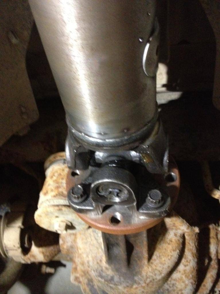

The driveshaft arrived and is mounted. I replaced the rear flange with a 4.25” Cobra flange and cut the nipple off of the 8”.

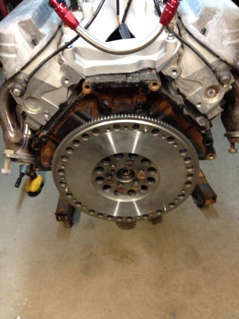

Mount the Flywheel and clutch. ~ 30 minutes
Mount the engine. ~ 1 hour

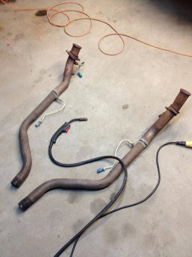

Forgot about the exhaust.
Add about 30 minutes to modify the factory down tubes with new flanges.
I'm going to build a 2 1/2 " system later but for now the factory will get me on the road.

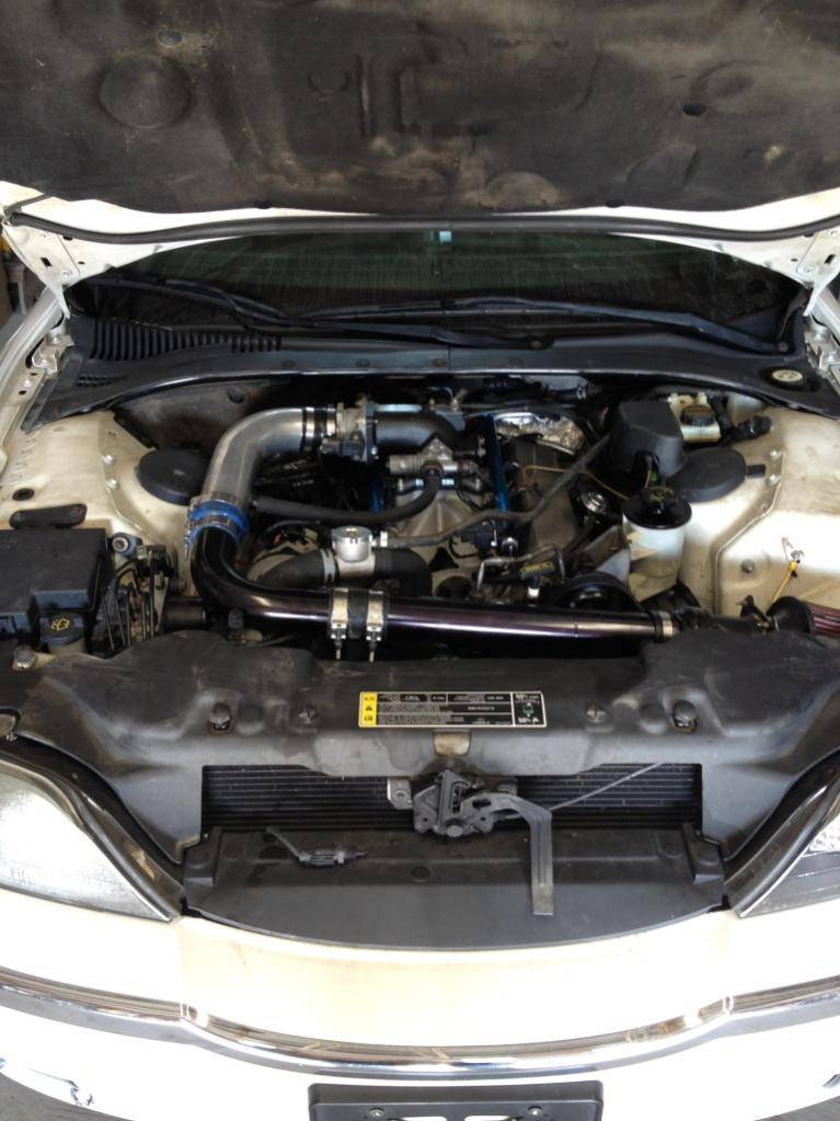

It Works!
Fired the engine up at 2:00am on Wednesday.
It actually hit the first time. After a couple of tries the engine started and idled correctly. I was surprized to say the least. I took a big gamble that the computer would work and it panned out.
It runs good. I've driven about 75 miles. There are only a couple of minor issues with a drive shaft vibration and the Advanced Trac kicking in. I still have detail work to do and I'm hacking through it. I'm going to try to get my wife to shoot a video of the car driving soon.

Here are some pics of the final assembly:

Still a driveshaft vibration -- 200 dollars for the driveshaft was too good to be true.
I have the catalytic converters and x-pipe on order. When the 2 1/2 exhaust is professionally built I will have them check out the drive shaft.

Very interested in your driveshaft. As installed, does it clear all the stuff that would be in the middle from the factory? (My '02, of course, has the 'X'-pipe and resonators in that area.)

Explorer cam - 1.7 rockers - Aluminum Heads - HV Oil Pump - Total Seal Rings - ARP rod bolts - HP Bearings - Single Plane Intake - Trick Flow Plenum - 24lb injectors (vs 17lb Explorer)
It breaths much better above 4200 rpm than a stock 302
