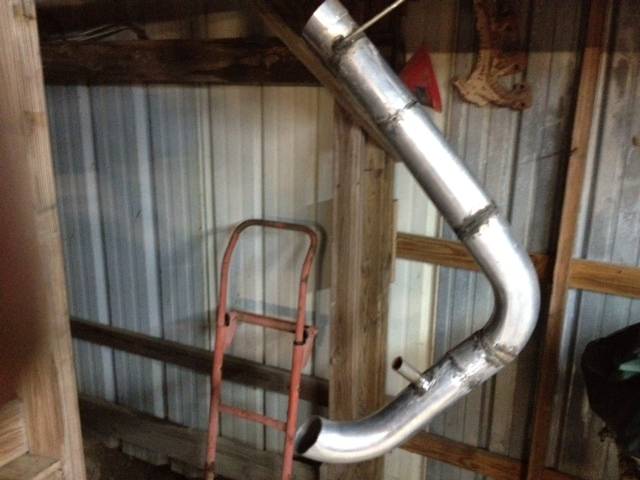

I built a new inlet tube last night.
It needs some cleaning up but works pretty good.
I'll take a picture of it on the car later.
...oh yeah, this one cost me only time and mig wire. I had the old tubes laying around... YAY!
that is something you could probably make for members for a decent price that people would buy up. If its not to time consuming and difficult.
Outstanding
