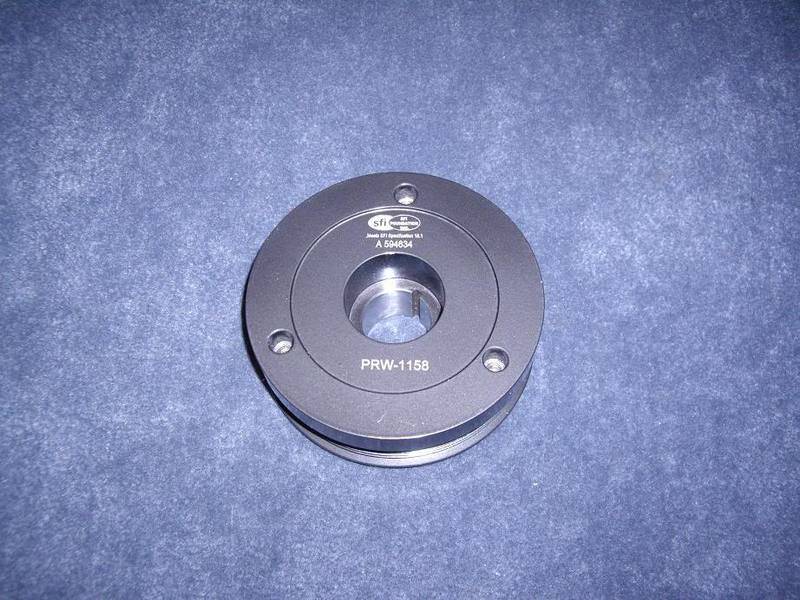

My new underdrive SFI crank pulley showed up! :wrench

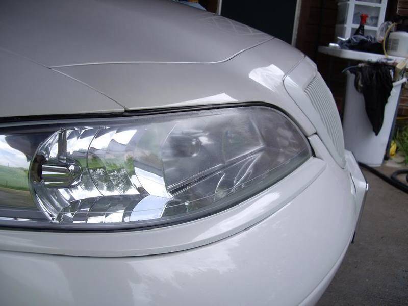

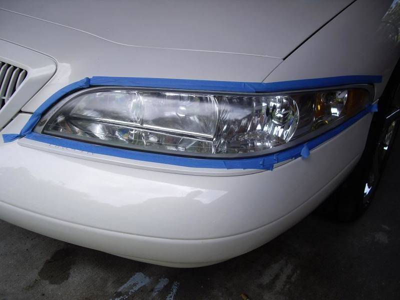

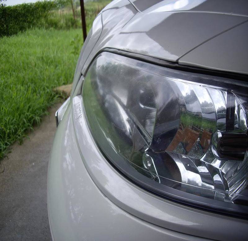

So I decided to try the Turtle kit on my headlights. Kit sux, some sandpapper and Meguires plastix does better and I finnished up using Meguires chemicals.
Part way through:
And the finnished product:
Nothing like new but much better then what they were.
i used the turtle kit to do mine and it took me about 3 hours of hard elbow grease and a high speed buffer to get each one done but 6 hours later and some very sore body parts it came out looking damn close to new

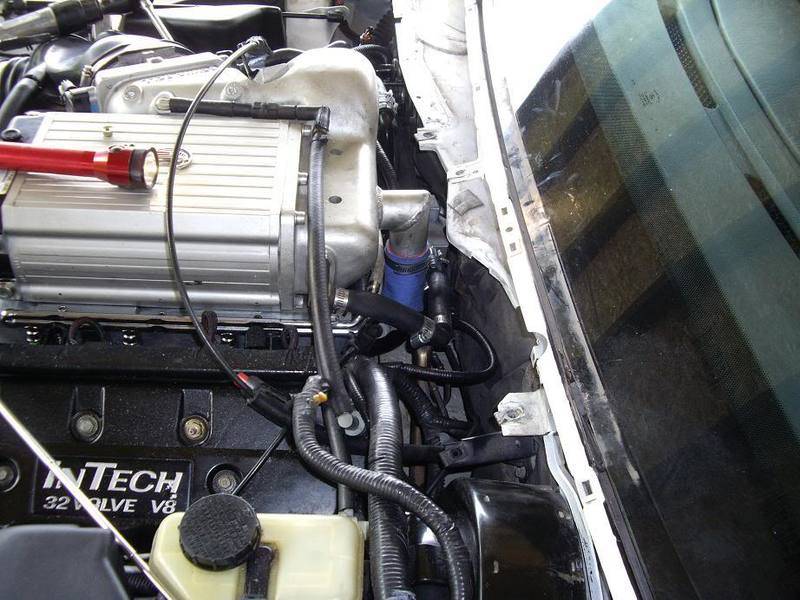

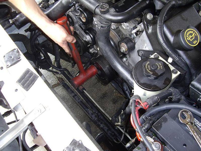

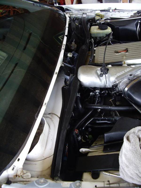

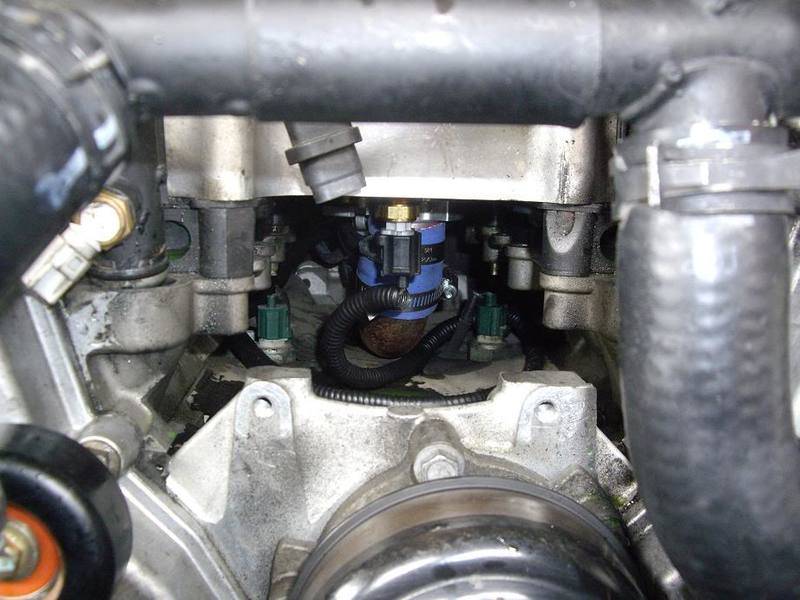

Alright, installed the new IAC, IATS and March undrdrive. All went fairly well. Had to remove the hood and full cowl to get to the IAC in so that was a small PITA. Also discovered the GT500 IATS has the same plug as a Mark so that was $20 wasted for the pig-tail.

So had to pull the cowl:
Theres my IAC hiding way back there. Was very bad BTW, wasnt working AT ALL before:
Then got the new IATS in under the plenum:

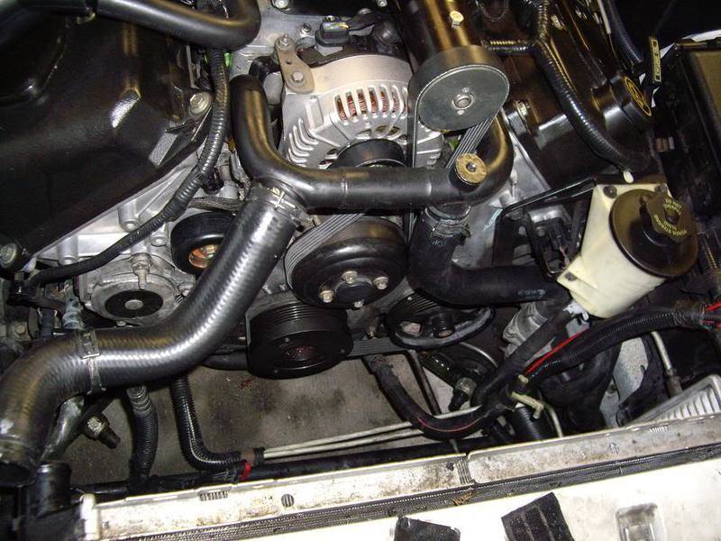

Then malleted on the new crank:
And with a 107 1/8" belt:

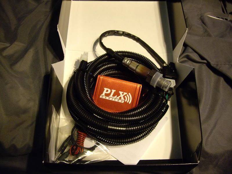

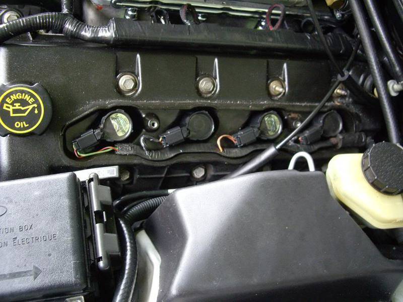

So my Wideband ond new coils showed up today. I am curious of the coils cause they are supposed to be OEM but have no markings at all. They seem to all work though. Somehow my card wiped that had all the new coil pics sooooo.... who cares. We all seen coils before.
So just a shot of the old ones and my new PLX Widband I will install this weekend. :wrench
bill how the hell do you have your belt on the new crank pulley, i dont see the belt coming around the pulley, i see it coming from the power steering pulley to the crank, but i dont see it on the other side of the crank?????
that looks like a march crank pulley thats what i have too, but i have the water pump pulley and alt pulley also.
WTF???????????????????? how the hell does that belt work without slipping on the crank? i'm not saying you guys dont have it right, but i know thats not how the belt is run stock, i only assume because of the blower you had to change the routing of the belt. i know the belt should be wrapped 3/4's of the way around the crank. it just looks like with such little belt on the actual crank pulley that you would be losing some grip! i'm not questioning you bill, i just never saw the belt come straight from the p.s pump to the crank like that!
god look how simple that is though compared to the nitemare i am going to have!!!
You also have two belts.
You would think belt slip is an issue but it dont seem to slip at all. Never hear it anyway and the car always peaks at 8.1-8.4 total boost depending on air temp.
I agree that it looks weird and it worried me too but it seems to work so far. Dont know how else to run the belt. I am told that if I do get belt slippage then I need to order this $400 tensioner that has a super strong spring in it so I may check one out in the furture.
Also I may just spray some belt juice and see if it helps should I start to get some slippage. I get a quick chirp when at full boost and then let off.
Nope, its a funky lookin wrap but its what works. I would like more wrap around the crank but it just aint gonna happen.
You're probably right, the only other pics I could find did not show the belt wrap well down low and all the others were a completely different setup.
See the C heads run dual belts and have a nice wrap. But since my blower snout is right next to the alt pulley its pretty impossiable to route the belt any other way. When the OEM crank pulley was on there it had a whole bunch more contact. So after I get a built bottom end I will push it back to the 16+ psi and have a better crank wrap. :)
