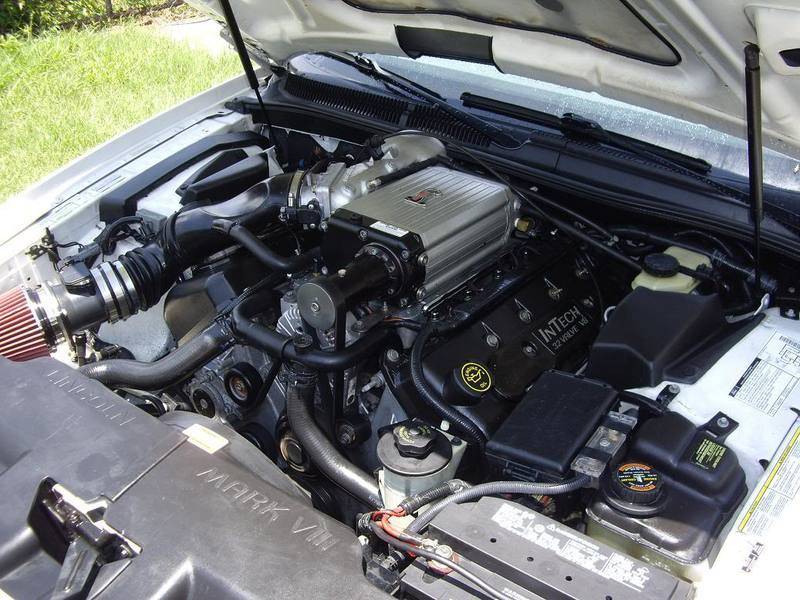

I have been slacking some here. So lets see where we are at.
Alt blew out yesterday on the way home leaving me stranded but Sapperfire cam out and really saved my ass. Alt is now an uber bitch to swap now. The coolant x-over tube has to come out to pull the alt so that means burping the system and new o-rings. Oh well, the whine is worth it I guess. :)
Did the oil change today and also swapped both idler and tensioner pulleys to kill the cricketts. Pulled some oil out the blower to help reduce the spray under the hood. After that I cleaned up the engine bay some. :)

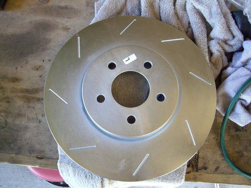

Got my new slotted rotors in as I was sick of breaking the drilled ones.

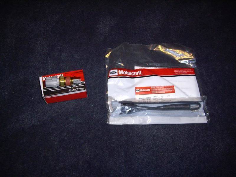

Then my GT500 IAT sensor and pigtail showed up. Thanks again Max!

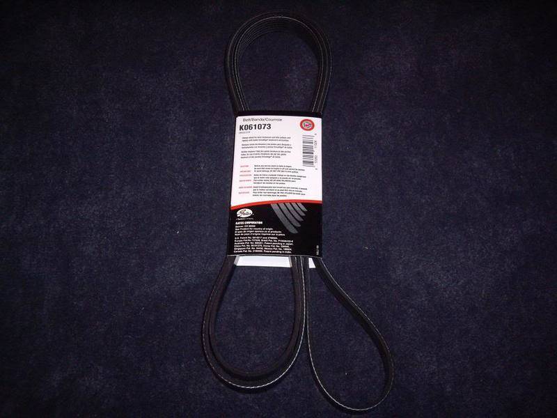

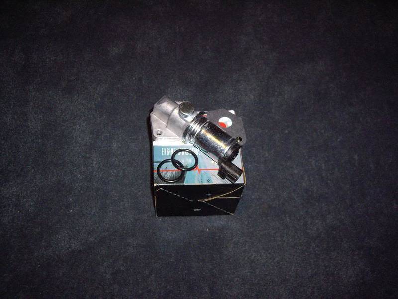

Then I stopped to get a 107" belt and a new IAC as well as some O-rings so I can get to the new IAT location.
