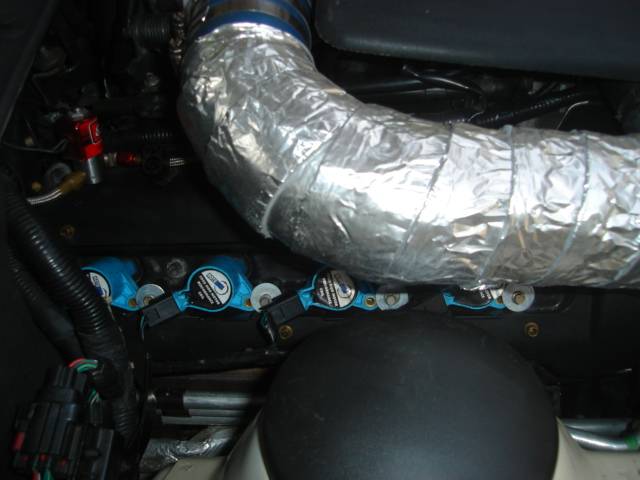

I have actually been using Motoblue 60,000 volt coil packs from a 03 Mustang GT without any problems whats so ever...
Alternate COP sources
VERY valuable information!!!! Thanks much for your post. How long have you been using that combo? (It's been suggested that there's the possibility of water getting into the plug wells and causing difficulty.) And as an aside, what all have you done to your engine?
KenS from Ben's Place
I've been using these coils for about 8 or so months now. As for the water geting into the spark plug wells, it only happens with a hard rain, and even then its not to bad. As for engine mods.. P&P Heads,TB,Upper Intake Plenum, Deleted EGR, Full 2.5" Exhaust with Test Pipes, 125 Wet Kit, SCT, Deleted Hydro Fan, Pump, and Lines, 3,000CFM Elec Fan, Custom Cold Air Intake, Motoblue Coils, and ALOT of Transmission Work
What kind of transmission work did you do (i see "a lot" in your list of mods)?
Your engine stays together with the 125 shot? I feel a little more comfortable now- I'm in the middle of installing 100 shot progressive. Kits good for 125 so maybe after a fuel pump, and a year of non-grenading runs, I'll jump up. Could you PM me general comments about the hydraulic fan removal? P/N and electrical, method.
Thanks!
As for the Trans its a Level 10 Animal Kit, i have a custom made 2800 stall, a larger trans cooler, and a deep sump trans pan from a 05 GT (with dipstick)
for the nitrous im using a progressive control aswell it ramps up to a 125 at 5k
Update on coils
At this time, I plan to use the '03 Mustang GT coils as seen in the pictures above by empirels. I'll be using Accel as the source and installing as shown. The only drawback is the lack of the covers normally in place. On the other hand, since I'm under the hood regularly, removal of the covers makes it easy to inspect for oil seepage and the coils will run cooler. I may make some sort of cap around the coil extension in order to make the installation more like that which is to be found in other central plug, hemisphere-style engines.
