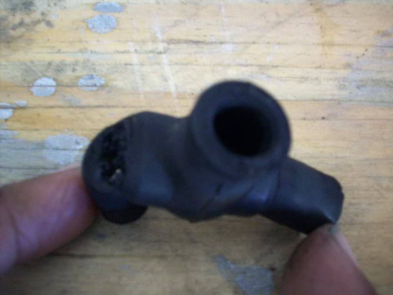

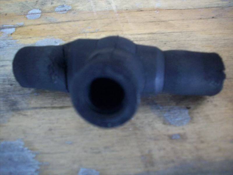

I solved the problem. The vacuum T-Line was melted/cracked. I don't know why I didn't see this at first. I looked over everything else and didn't look at this at all. So everyone with a gen 2, check out yours. Make sure there's no tears or rips.
@$*#&#*@#$(@#$*S I just changed the two tubes that were attached to that T piece and noticed it is cracked EVERYWHERE on that T piece! I've had the same code as you forever now. Mine also came back on after 40 miles. I'm going to have to try that tomorrow before I buy the new OEM MAF that came in to my dealer.

you cant imagine how many people have come to my shop for repairs and say oh by the way if you get a chance the car doesnt idle right, and its that vacuum T everytime. i even had a check engine light come on way back in 2004 when i bought my very first mark VIII, my 97 lsc started running crappy after about a month of me owning it, and i didnt know a whole lot about the gen 2 motor yet, and i found that one of the hoses on that T was sucked shut, it got so soft it would actually close on itself when running, i changed it, and the check engine light was gone. derek i cant remember what condition yours is in, but it is the same one that was on it, i never changed it so it could be bad, i dont think you can buy that piece, but i do have 2 of them!
Yup, I posted the same thing in both my progress threads. My 97 would suck the tube flat and my 98 had nothing but cracks on it. So I just eliminated that setup all together. :D

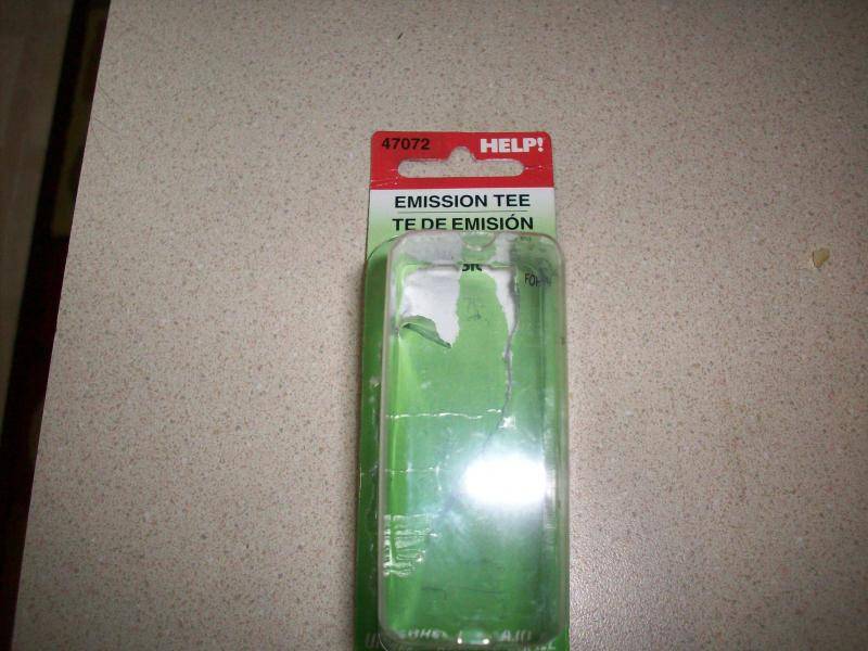

Derek, you can get this at any auto parts store. It's a $4.25 part. I am pretty confident this was the source of my problem. I've driven over 100 miles since I changed it, and the light is still off. Here's a pic of the package.
Perfect I'll fix that tomorrow before I buy the MAF...I'll know right away if that's it because when I reset the pcm if it drives slow still I'll know that wasn't the only issue.
