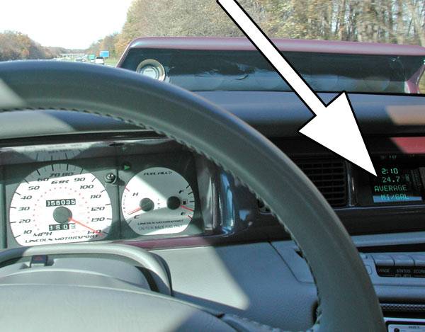

Again one more time. I have and have had 4.10's for 11.5 years now, daily drive the car everywhere city 19 hwy 27.5 @65. What is the deal with people not wanting to run the 4.10's? Its hilarious. GO 4.10's my GAWD!!!!!
you get BETTER MPG and can still do 150mph?

The thing I have to know is how you get that great mileage! My car has a tune that only dropped my mileage by .5mpg but my car still can only pull a 21.2 when its 85% highway driving. Of course I usually have the cruise set at 80, its Texas and if you go slower you get run over bythe douche in the Cummings crew cab. :mad:
