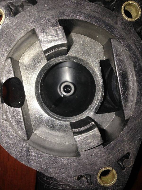

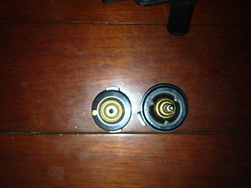

Just wanted to post a couple pics comparing a part store thermostat and a factory Ford thermostat. There is about 10mm difference in size. size DOES matter.
Ford housing

Murray Housing

Thermostats Junk on the left and Ford on the right

Loud said "church"... now can I have a witness??? Oh,,, that's right. Sid provided pics,,, so we do have a witness.
...off soapbox again...
Beyond what Sid said and provided in his pics,,, I notice other differences. Compare the bushed bolt holes between aftermarket and "true" OEM. The laws of thermal expansion dictate that the aftermarket part will split at the bolt holes,,, while the OEM, (Ford dealer), part will not. Not to mention the OEM brass inserts for the thermostat stem, (and non existant check valve in the aftermarket part). Sid gets a thank you for his pics.
Go the cheap route,,, and you will be replacing coolant parts at 50k more miles,,, instead of a 100k more miles. This thread definitely needs to become a "sticky". If not for just an LS cooling system rebuild,,, also for the case of using factory parts vs aftermarket parts.
